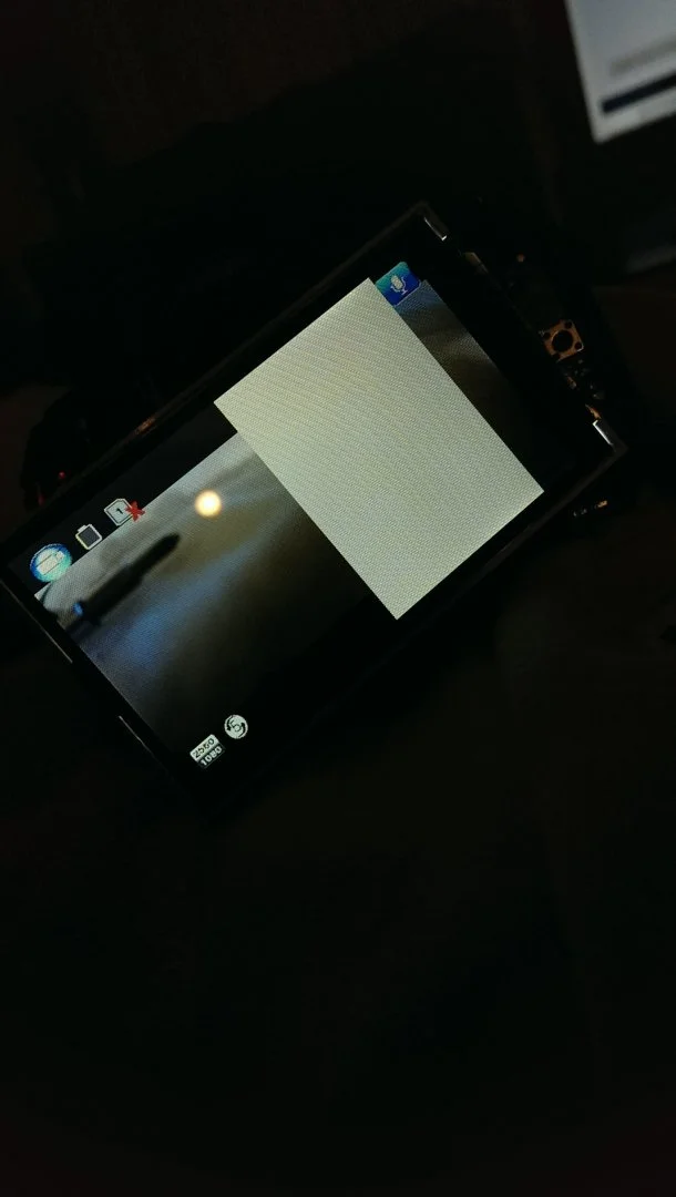

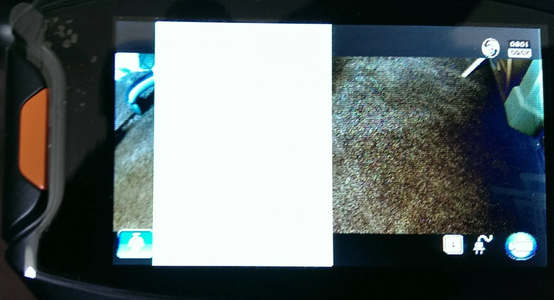

NOW i have another issue: there is a white block on one side.
the recorded footage does not show this box which is not bad as it rules out the sensor, but how is this corrected? is the screen not fixable? ever seen this before?
could a ribbon cable inside be loose?

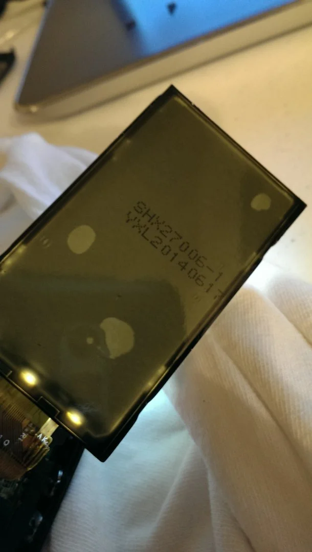

yes opened it up. i did not remove the screen, just wanted to see where the battery was.
have you seen this behavior before? does it mean the screen is no longer working?
Well it looks hardware related so perhaps you've knocked something, if it has an AV output connect to a monitor, if the picture is fine on an external monitor then possible you've done something while you've been poking around inside
Does the G90 use ribbon cables for connecting the LCD monitor or other internal components? Perhaps there is a loose cable that needs to be re-seated?
Edit: Oh, I just read Dionic90's earlier post about this. Still, perhaps re-seating is necessary?
yes its no longer bricked but the white box is still there after i re-seated the ribbon cable.
this may be a dumb question but does this mean the screen is no longer working? is is possible to get a replacement screen?
Tried the AV output to an external monitor yet? If it looks good there then you might be ok with just a replacement screen, you'd need to contact Dome to see if they could arrange though, they're not expensive but the practicalities of arranging it might not be worthwhile, good test of their customer service I guess
