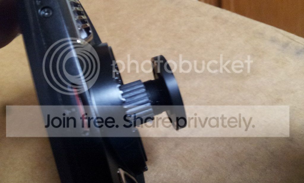

Mine is definitely out of focus but I'm kinda afraid to break it. Can you please explain in mode details how did you do that? Thanks!
I just snapped a pic of mine to show you what you see when you pop off the outer shroud. In this pic I have already removed the glue that retained the lens. You have to be very careful, the mount that the lens attaches to looks fragile. After the glue is off you can turn the lens in and out to change focus.
