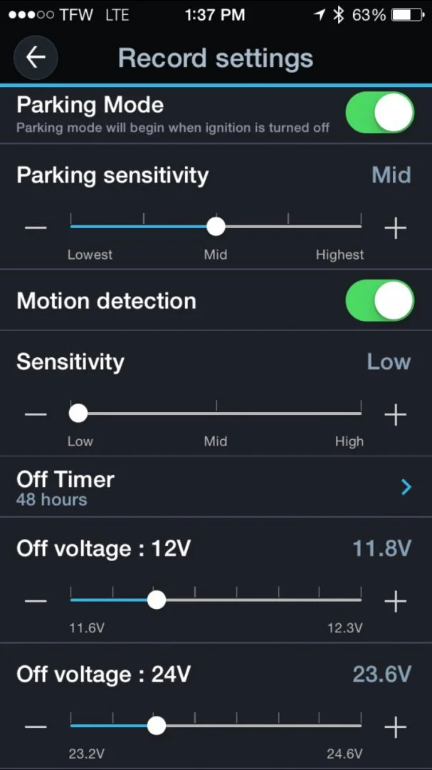

***I just noticed that the Thinkware app has a device auto timer and voltage meter...so I think I may have just solved my issues with this option? I thought to leave my note above in case this is not the case***

You beat me to it. Unless you are adamant about having zero drain on your car battery when not running, there is no need to add an external device. The F750 has both a max timer (up to 48 hours) and an adjustable low voltage detect to safeguard against draining your battery. I've left my car at the airport for over a week and started it right up with no problems.
I was under the impression that I would need some device to cut the power from the dashcam before it drains my battery on longer periods of non-use. I did not know until I investigated the manual of the Thinkware that it is built in the F750; I actually just got off the phone with their tech support to inquire of the numbers for the timer and voltage(12.3V), which appear to be all usable!
Both are adjustable.
