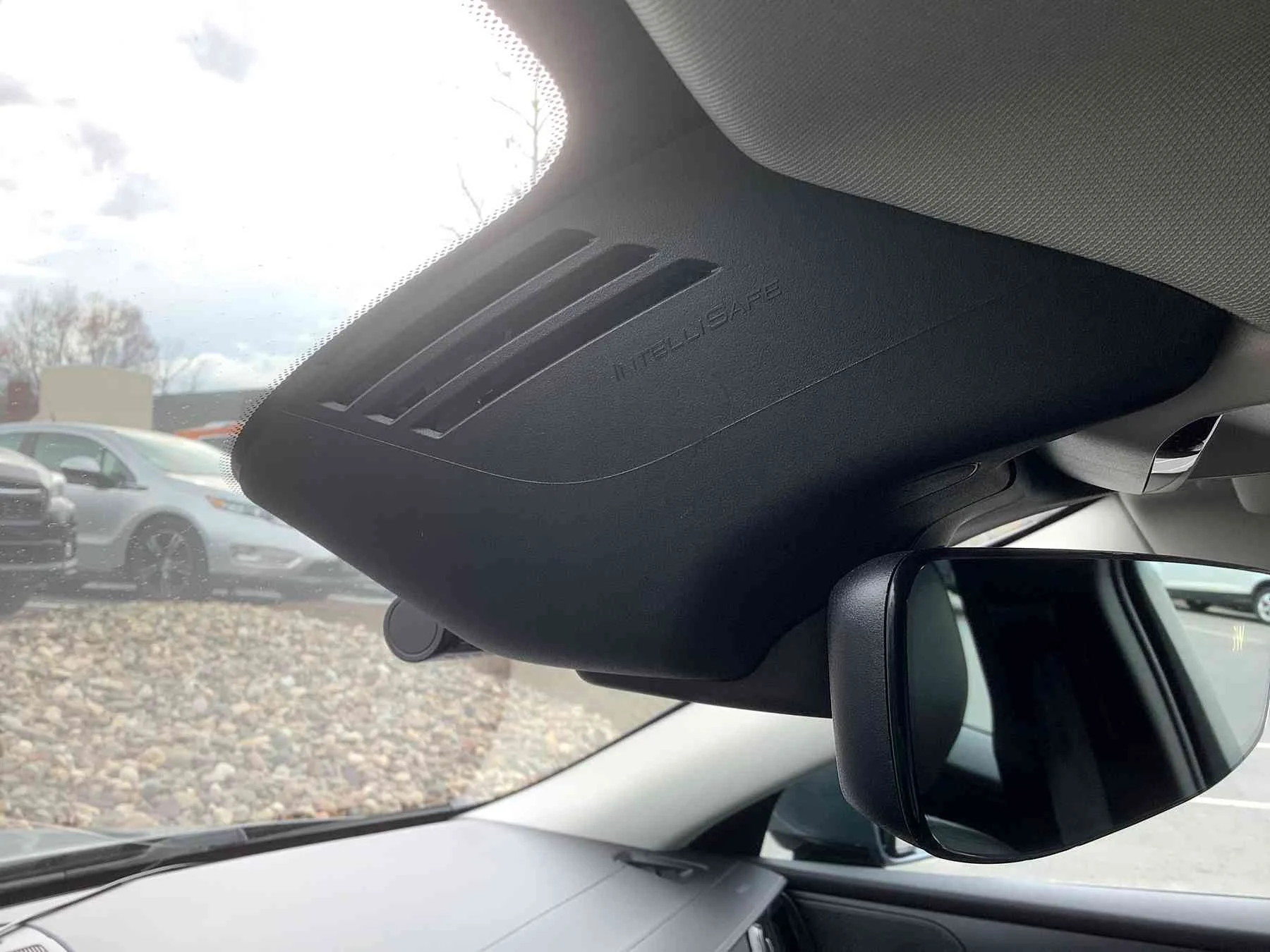

This is exactly the issue I'm having with mounting. My car has a huge driver support system behind the rear view mirror, so this entire area is not usable. I have a Viofo A139Pro just below the mirror, slightly off to the right side of the car so it is hidden from my point of view in the driver's seat. The telephoto camera for the A329 sits directly to the left of this and with the curvature of the windshield, it aims a bit to the left. The wedge shape of the A329T camera means that it hangs down below the mirror a bit too much for my liking, so it's up behind the driver's sun visor as close to center as I can get it. But with the curvature of the windshield here, too, I need to tilt it at an awkward angle in order to restore a level horizon. As a result, both of the images from the A329 are skewed a bit to the left. If have two more cameras behind the passenger side sun visor on the right hand side of the car and they are skewed a bit to the right.
Out of curiosity, how many minutes of loop recording do you set in the settings? Is 1 minute enough or should I increase it? Thanks.
I've been running 3min files, but given the larger size of files over time, I'm inclined to make the switch to 1min files for the reasons Tony mentions.
Here is the obstacle that I have to dodge while trying to place a camera: It's no big deal if you don't try to install multiple cameras 😉

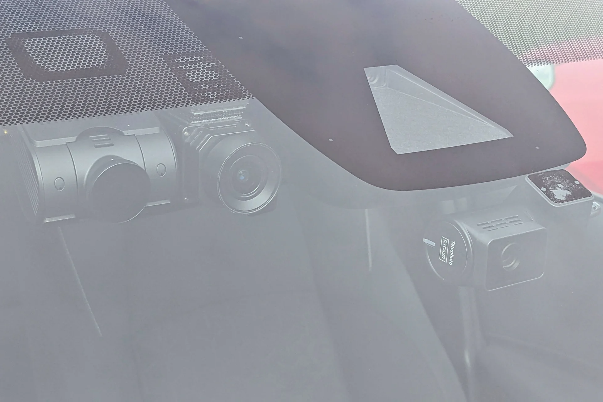

My current installation:
A329S and Mobius SLL1 on driver's side of the mirror. Telephoto mounted centrally under the mirror housing. Actually, I flipped it around 180deg horizontally after taking this so the mount foot is on the driver's side - the slight change in curvature means the camera is aimed slightly towards the middle of the road rather than towards the edge.
That's a nice and clean install and works best when the cameras are of similar shape. I've got an A329T on the drivers side, with the telephoto directly under the mirror housing. Next to the telephoto is my A139P (both are off-center, in opposite directions). On my passenger side, I've got an N5S and an N4S side by side, which takes up the entire top area on the passenger-side front window. None of them are ideally placed because my mirror housing is twice as wide as yours, so I'm definitely running into window curvature issues.
What does it look like with the main Viofo camera in that position? Can you still see the entire front of the car, or is a large chunk cut off?
The A329T has a clear view ahead - no obstructions. The telephoto camera is barely visible on the lower left edge of the A329T video, but it doesn't affect the view outside the car.
The Mobius view is partially blocked by the mirror housing but I'm OK with that - I have it installed to capture license plates on the other side.

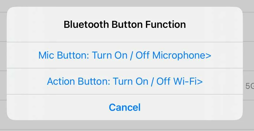

But the best part is that the two side buttons are PROGRAMMABLE! I attached the manual to this post so you can peruse some of the details on you own.
The button on the left with the circle on it is the "Action" button. The button on the right with the microphone on it is the "Mic" button. After pairing the remote with the camera, you can choose what happens when you press either the Action button or the Mic button. The app menu shows you what the initial settings are and both buttons can be reassigned.
First up are the choices in the app for what happens when you press the Action button (circle):
Followed by the choices in the app for what happens when you press the Mic button:
Obviously, I need to play around more, but I'm thinking my initial custom settings for this super cool remote control will be for toggling Parking Mode and Power Off for the camera. More on this later... First, I need to find a good place to mount the button.
