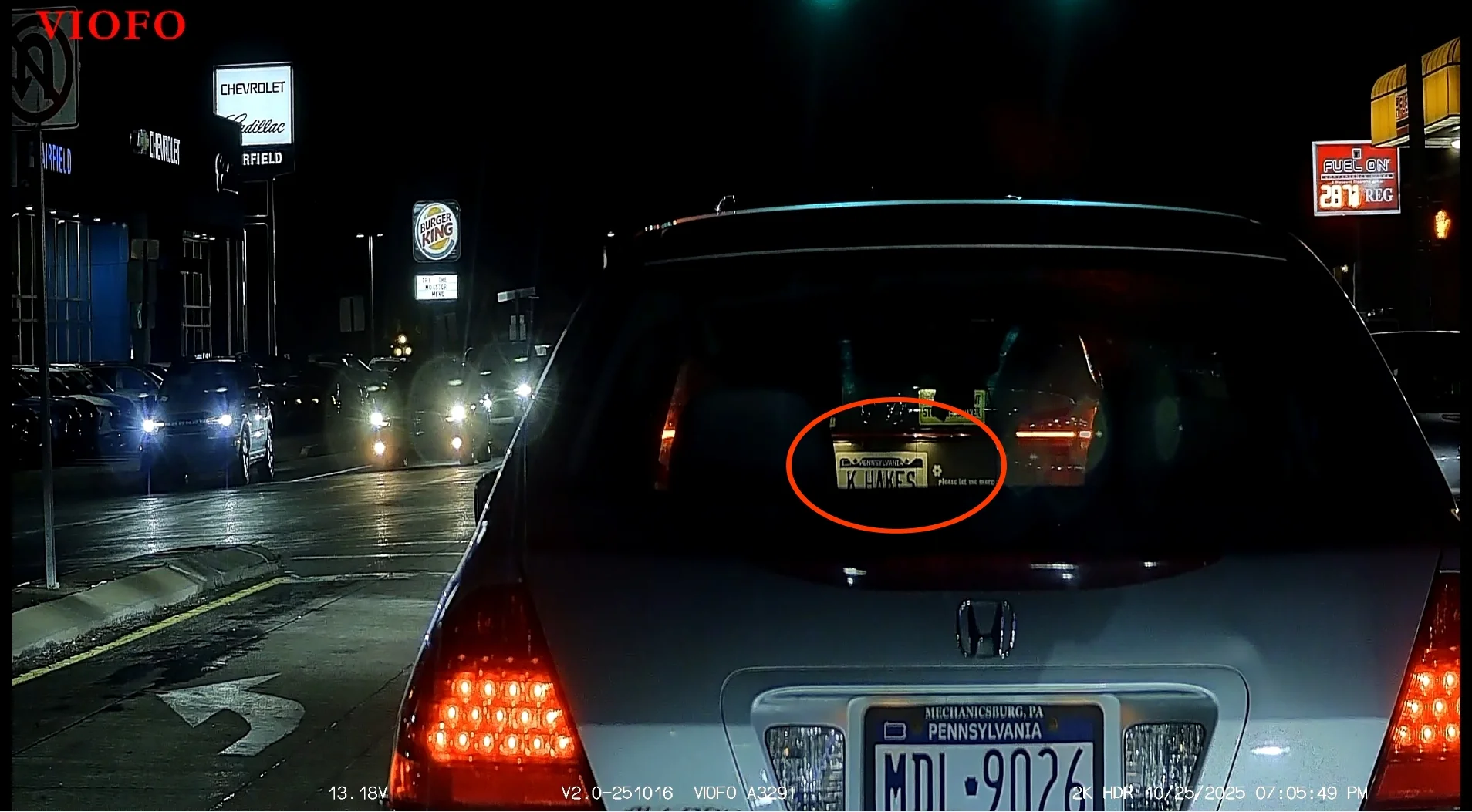

I made a few more videos last night and looking through them, I found it amusing to come across this capture with the 4x Telephoto lens: Not only can I read the plate on the Honda directly in front of me, the plate of the NEXT car up is clearly visible, too! Pretty cool! 👍

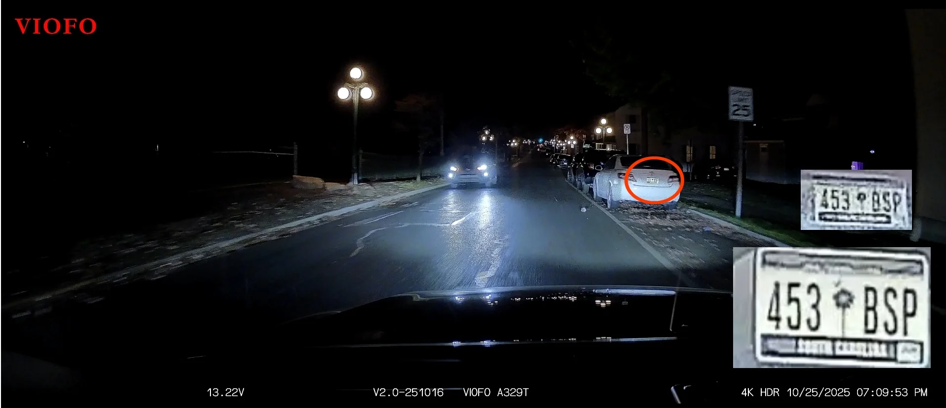

Here are three captures along the same street as I was moving about 20-25mph. This is the entire frame as captured by the A329 camera along with two inserts.
The smaller insert is a 300% zoom from the A329 main 4k camera and the larger insert is a 300% zoom (reduced in size a bit) from the 4x telephoto 2k camera.
In all cases, I selected the single best frame from the video stream which resulted in both cameras capturing a completely readable plate number, even the state is clearly discernible! Overall lighting for the scene looks pretty good as well. These are great results from a high contrast situation involving a substantial speed differential.
A329T 4k main camera, HDR enabled, polarizer lens installed on both cameras:

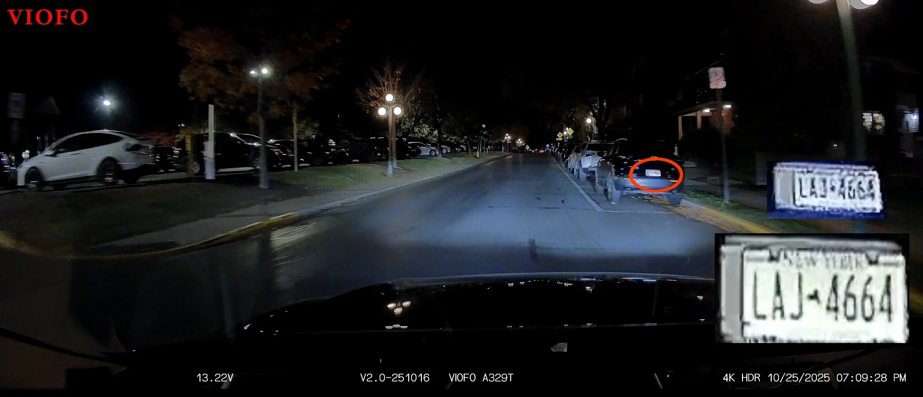

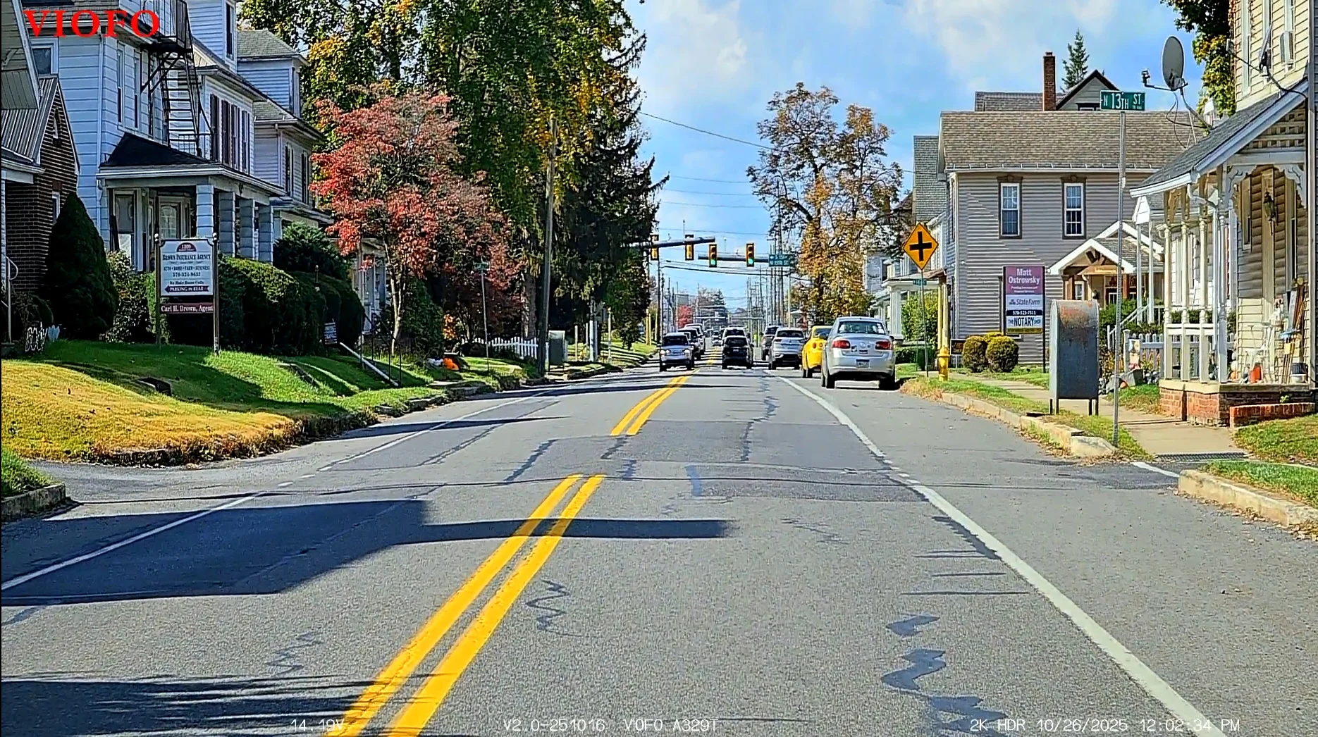

Also want to say that I REALLY appreciate the linearity of the front telephoto lens. Check out the left and right edges of this screen capture (it's a bit squished due to my screen resolution). Vertical portions of buildings on the left and the downspout on the right are perfect. There is no visible pincushion effect or barrel distortion at all. The roof line on the building on the right is also nice and straight with no curvature. This is very nice geometry for the 4x telephoto lens!

What is the resolution in camera settings?
Telephoto lens resolution setting is 2K 16:9 2560x1440. Confirmed file resolution and aspect ratio with MediaInfo app. The problem is my laptop screen resolution maxes out at 1920x1200. I need to get a 4k display for my desktop computer...

As I understand it, the resolution, previously 4K 21:9 + 2K (telephoto) 21:9, was later updated or added to 4K 21:9 + 2K (telephoto or rear) 16:9.
@EricSan
In the telephoto view you shared above, I see that the cropped area is actually 21:9. However, the frame was saved as 16:9.
In short, the cropped area is not 16:9. I see that it was cropped to 21:9 and then stretched and expanded to 16:9, which is why the vehicles appear narrower than their actual size.
@viofo @VIOFO-Support
This is a bug and needs to be fixed.

Yes, I mentioned this in the Beta v2.0 firmware thread.
I noticed this years ago in another model. Unfortunately, such errors can go unnoticed. It's possible that you noticed them later.
Ah, I was assuming this was an artifact of my screen resolution... I need to keep up with the other threads a bit better. Most of the time, I barely have time to add to my own thread 😉
