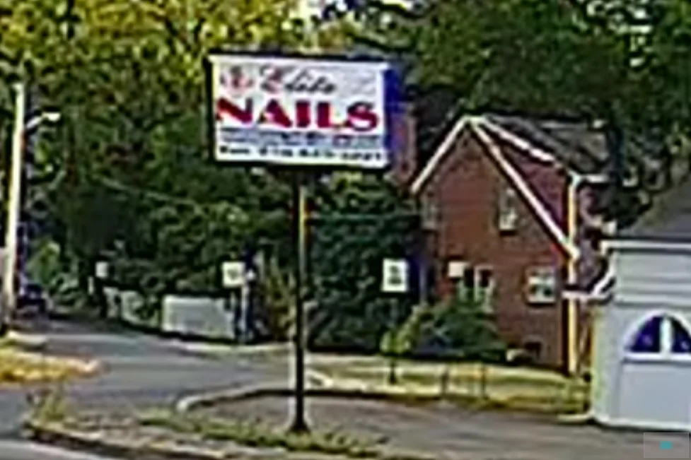

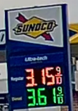

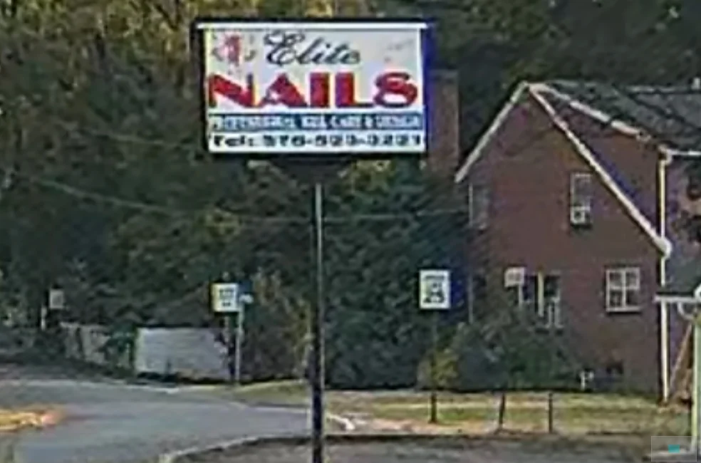

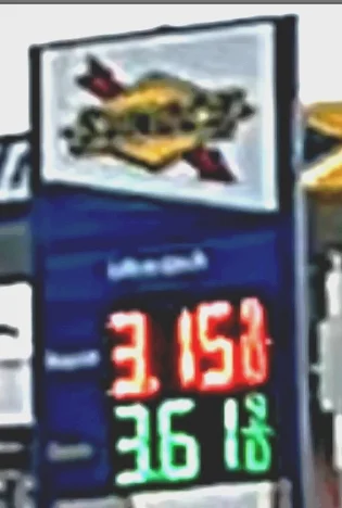

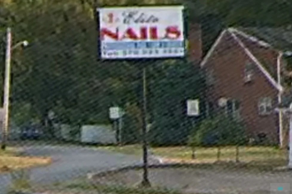

The images above are "dynamic" images. The ambulance is moving away from my stationary car about about 35-40mph. From the same video files, I decided to zoom in and crop around a stationary object for a comparison of "static" elements captured by each of the cameras. All three cameras have a polarizer installed, all three cameras have HDR/WDR enabled. The N4S also has PlatePix enabled (which results in an overall darker image, so I need to adjust the EV to +0.6 for compensation). Here are the results:
N5S, 2.5k, WDR enabled, Polarizer installed:
N4S, 2.5k, HDR and PlatePix enabled, Polarizer installed. The first image (on the left) is a direct screen cap, the second image (on the right) is what I got after adjusting brightness and contrast to compensate for not using adjusting the EV setting in the camera).
A139Pro, 4k resolution, HDR on, Polarizer installed:
Not surprisingly, the A139P renders the clearest image, but it is also a 4k front camera (N4S and N5S are 2.5k) so this is not quite an apples-to-apples comparison.
The N5S produces a much cleaner image than the N4S in this static setting, same as it did for the dynamic scene I posted directly above, even after accounting for the darker image (and adjusting brightness/contrast) from the N4S. Again, this is surprising performance because I have been led to believe (based on various online readings and sources) that HDR provides superior results to WDR. My findings illustrate the opposite effect. I was also expecting the N4S to outperform the N5S because it is processing less data overall (three video streams with the N4S instead of four with the N5S). Perhaps the difference lies in the PlatePix processing in the N4S. I'll need to make additional videos to tease this out of the visual data...

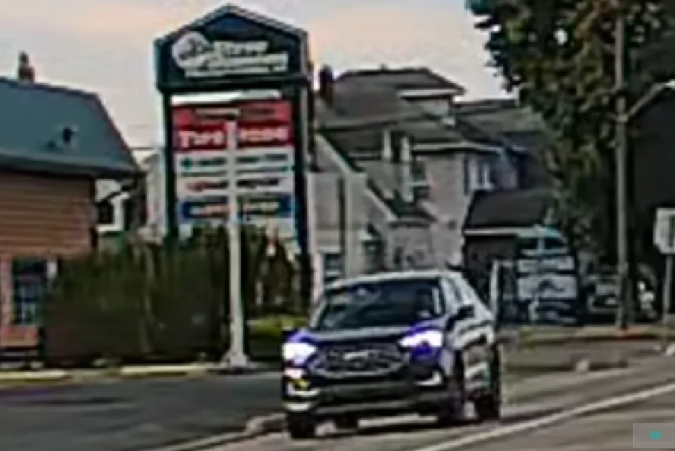

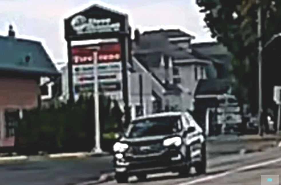

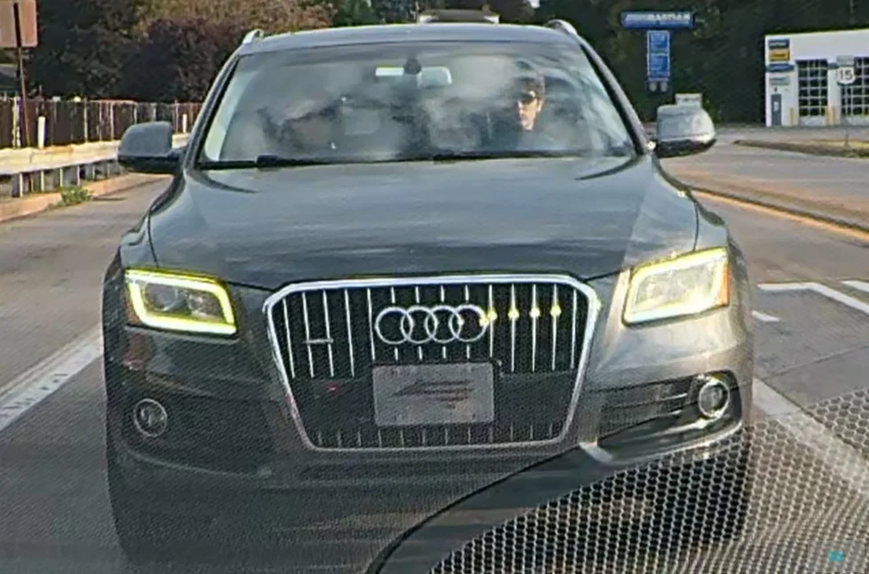

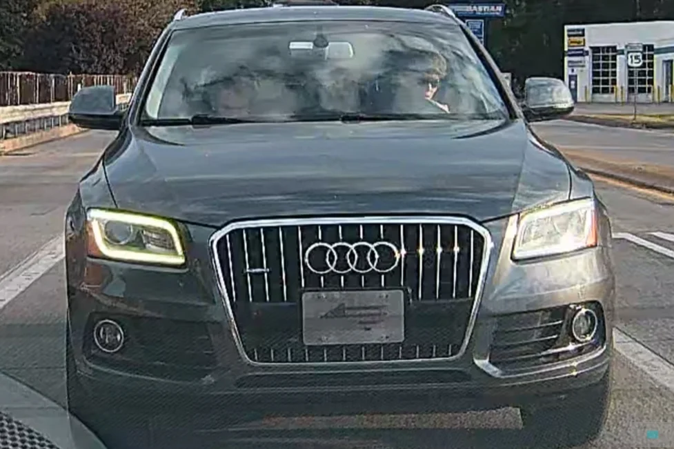

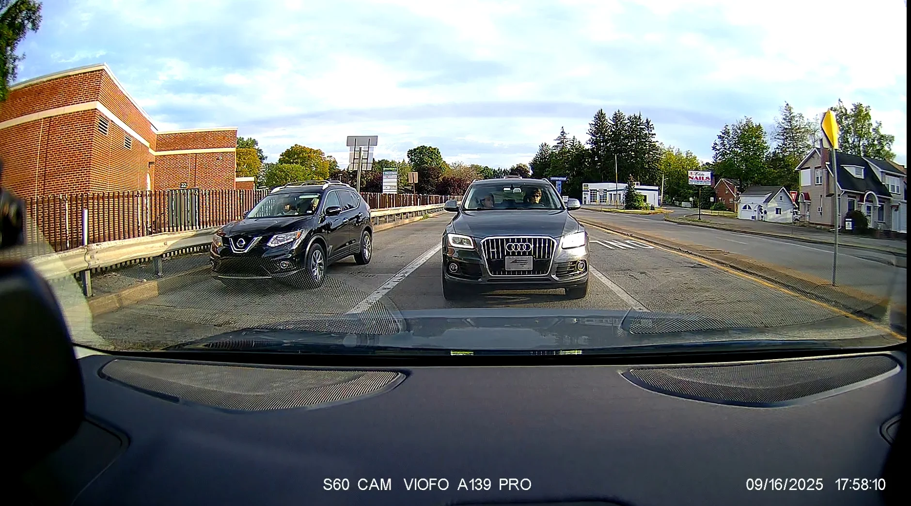

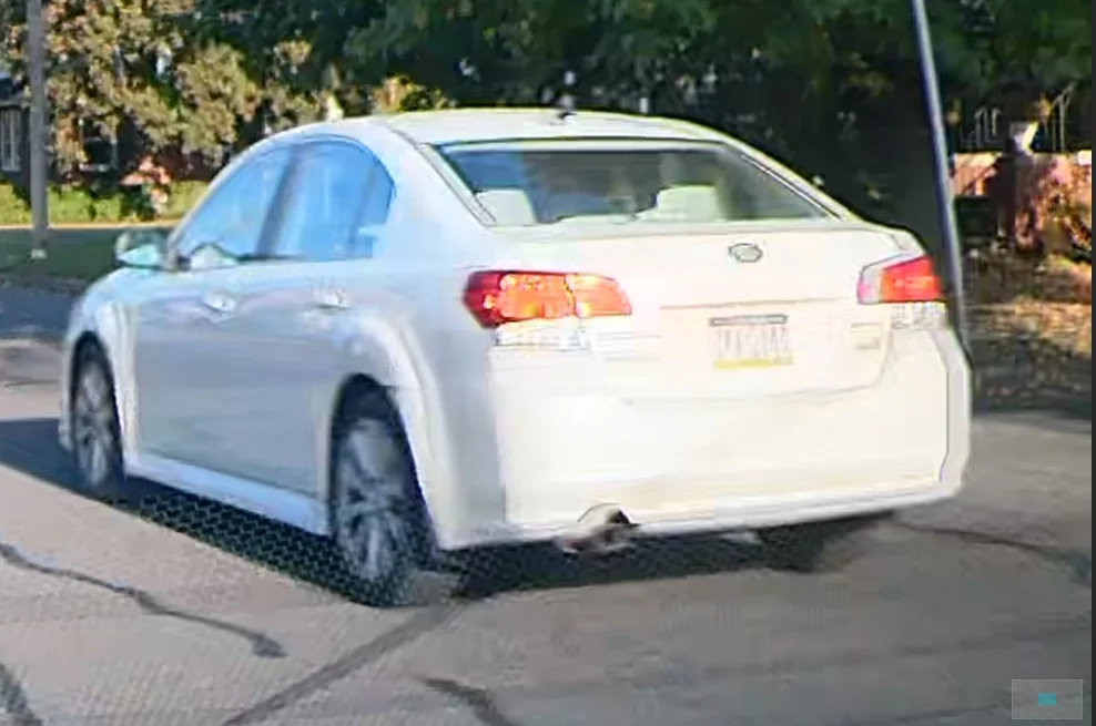

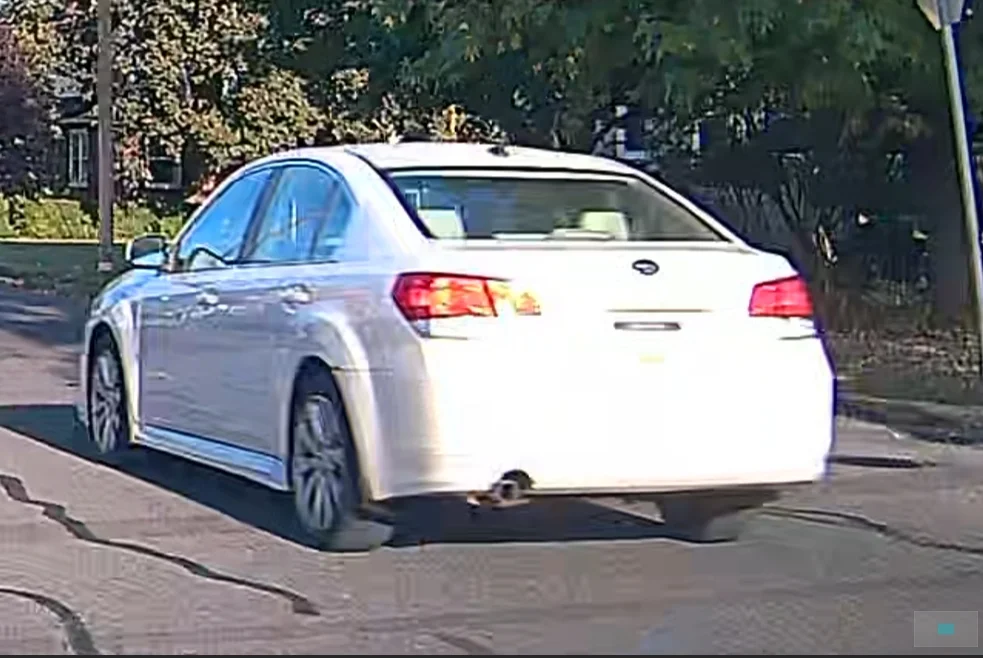

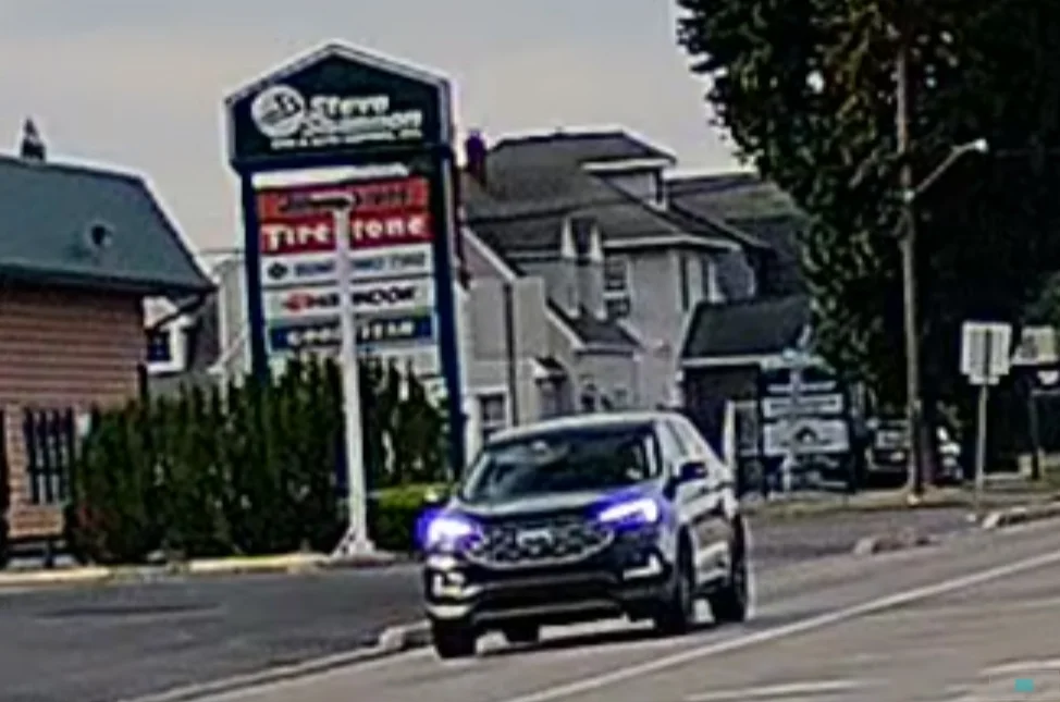

Here are three more 300 percent zoom/crop screen caps of the approaching car in the oncoming lane that were made at exactly the same instant in time (ambulance rear wheel aligned with the second stripe of the crosswalk, exactly as shown in the post above). HDR/WDR enabled for all, PlatePix enabled for the N4S, Polarizer installed on all three cameras.
N5S, 2.5k front camera
N4S, 2.5k camera. This is not the actual output from the N4S camera, I used photo editing software to adjust the brightness and contrast because the HDR+PlatePix settings resulted in under exposure. Tweaking the image in photo editing software enabled me to brighten the image for better detail-level comparison, but it also resulted in color crush, so the colors are no longer accurate.
A139P 4k camera
The N5S renders a bit more color in the overall scene and better preserves the detail in the grillwork of the oncoming car than the N4S does. The increased resolution of the A139P shows here, but it also reveals a bit of ghosting which might be an artifact of the HDR function.
