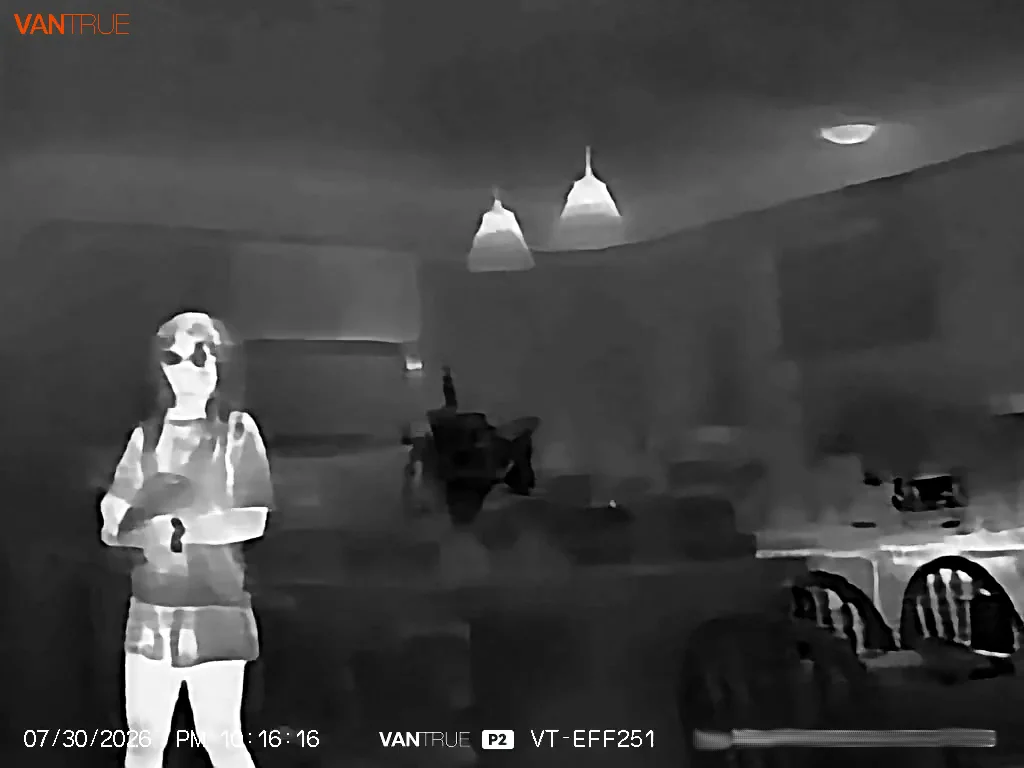

Here's quick capture of my daughter in the kitchen with the thermal camera:
People in black.
Yeah a few years ago i almost ran one of these over in a T intersection, a jogger in full body black spandex in the middle of winter, but even if Danish town streets have light just fine.
I will not be too loud about this black attire, i am extremely casual dresser myself and it is only in summer i am colourful.
Bitrates seem pretty moderate for H.264 compression, i recall back in the day the good 1080p cameras was running 18 mbit and as i recalled still choked on info if you passed some bare trees along the road in winter.
Looking forward to seeing action plate capture performance.

As you can see, the image will basically show the heat signature but any surrounding objects are indistinguishable. I surmise that's the case with a thermal camera and is normal.

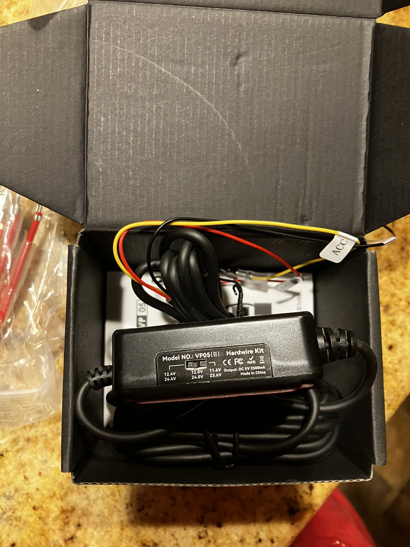

The Hardwire kit that Vantrure supplied with my P2 is only rated for 2.5A.
I'm not sure if that will be a problem.
Think that's all they sell. Given the Pilot 2 only offers collision detection mode, it should be sufficient I am guessing?
Yes only collision detection but unless I'm missing something, it still has to supply the entire system with enough power for all 4 cameras and the display unit, which appears to require 3 A based on the specs shown in the user manual. @EricSan pointed out that the VP05 (II) hardwire kit supplies sufficient power but my VP05 (II) is rated at 2.5A.
Yes only collision detection but unless I'm missing something, it still has to supply the entire system with enough power for all 4 cameras and the display unit, which appears to require 3 A based on the Cig lighter output. @EricSan pointed out that the VP05 (II) hardwire kit supplies sufficient power but my VP05 (II) is rated at 2.5A.
My VP05 is only rated 2.5A, too. Does @EricSan have a more updated unit supporting more voltage? Or is his also 2.5A?
Good question but I would have expected Viofo to re-identify the unit if it had a higher current rating.
I am not aware of an updated version of the VP05(II), but it should function fine. I did raise the issue of power supply current ratings with Wendy a while ago (as Vantrue started introducing 4-ch cameras) and she said the present supply is fine.
I’m measuring a total power draw of 11.9w (942mA at 12.62v) for the P2 with all cameras running, screen on, and IR LEDs on. This works out to 2.4A at 4.98v that comes from the VP05(II) regulator. This power supply is sufficient to power this camera, but I generally like to see more headroom in a power supply so it isn’t running full-tilt all of the time - this is stressful on the regulator’s components. After a few minutes of powering the P2, the outer shell of the VP05 regulator is showing a 20c temperature rise. This means the electronics on the inside are even hotter. The VP03 hardwire kit is clearly NOT sufficient for this camera as it is only rated to 2A.
The “older” (non-tapered barrel) utility plug adapter is rated to 2.4A, which directly matches the P2 power draw, but the voltage sags a bit at that level of current draw. It’s safer to use the newer (tapered barrel) utility plug adapter which is rated to 3A at the USB-C plug at the end of the wire. See a physical comparison of these two utility plug adapters here:
Some time ago, I did some stress testing of Vantrue VP03 and VP05 hardwire kit power supply regulators. The VP05 measured remarkably well (meaning the voltage doesn’t sag as current draw increases), but I did not exceed its power rating with my testing. The VP03 voltage droops a little as current draw increases. Thus, the VP05 regulator is clearly a more robust circuit design.

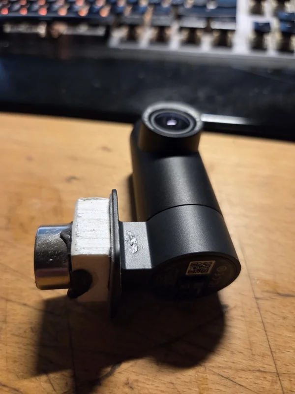

A couple of say 1/2 " neodymium magnets will grip like a SOB to the sheet metal, if anything you might want to put a thin rubber in between to increase friction between magnets and steel.
I have used magnets for years, just one 20 mm OD 10 mm thick round one for my rear cameras, even washboard dirt roads and normal car suspension and they aint going anywhere
The rear camera in my new car is held in by 2 similar round OD magnets but just 2-3 mm think, i think they are from the " locking " mechanism of some cupboards or so, so not really terrible strong, but easy hold the S1Pro Max rear camera to the sheet metal of my rear hatch, which do get " slammed " close.
T 800 rear camera, here with a additional 10 mm spacer in white plastic.
