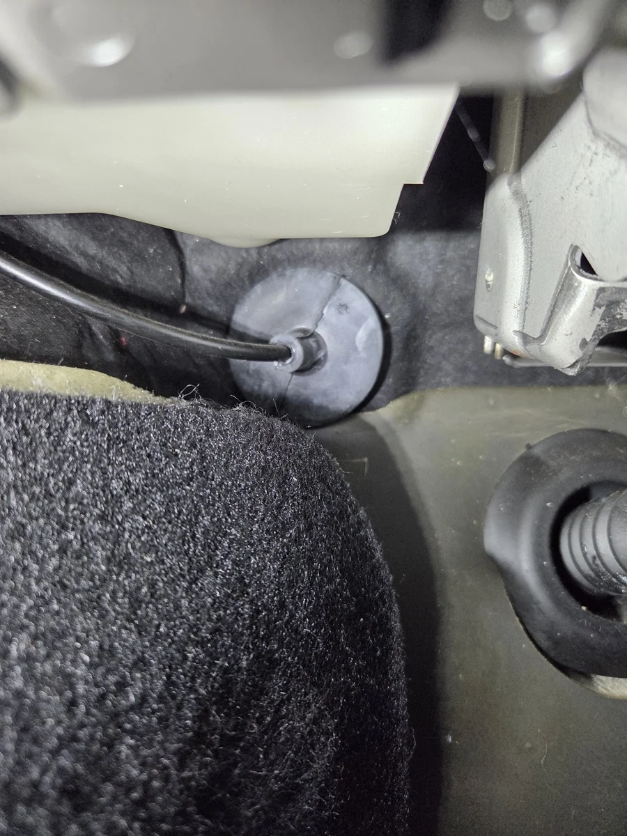

And the firewall, i will breech that some way
It would seem i dont have to, there is one pass thry ATM just hosting 1 wire, i am sure i could shimmy by here if need be.
Looking in the engine " room " there also seem to be a not used pass thru the firewall. but somehow it is hidden behind some felt ???? in the engine compartment.
Mind you that one would route to directly behind the glove box, which in this car is substantial, and from what i could gather today you can not just " pull " put the glove box itself just like that ( me snap finters )
So it would seem a few T20 screws would have to be undone to get to behind glove box.
Where the steering column go thru the firewall,,,,,, cough cough 😳 French engineering.
