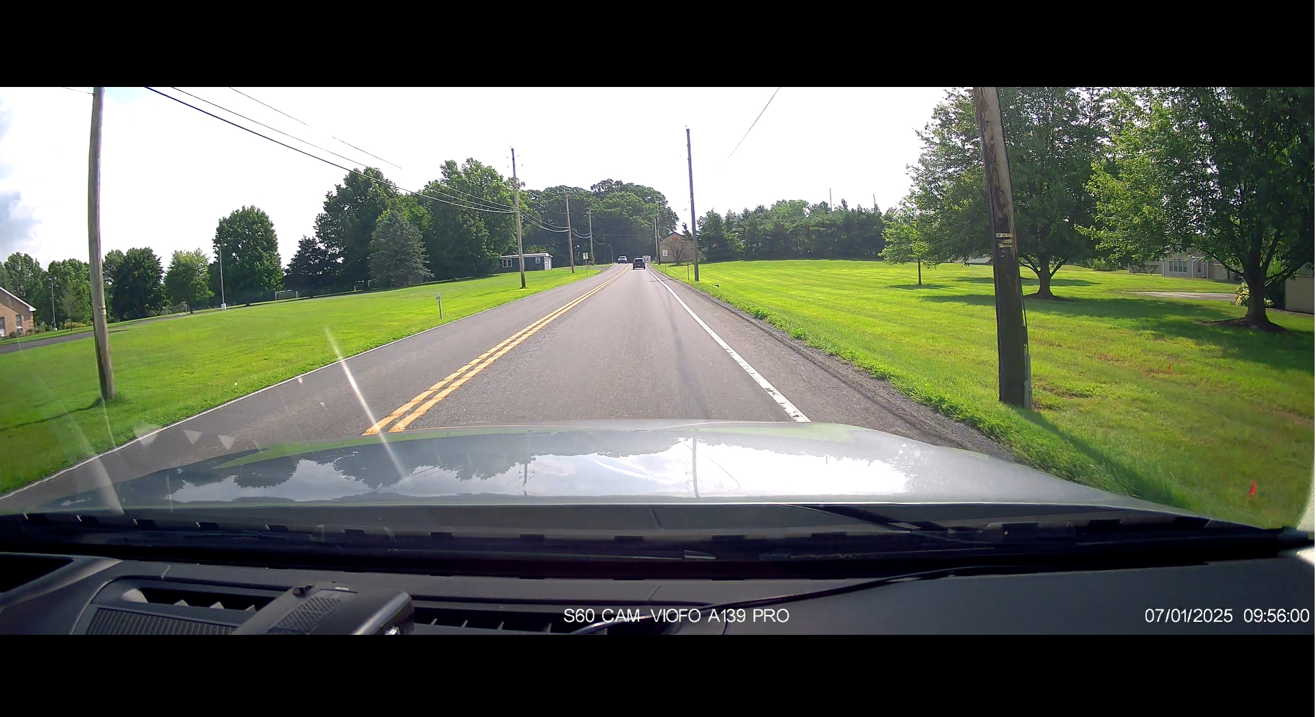

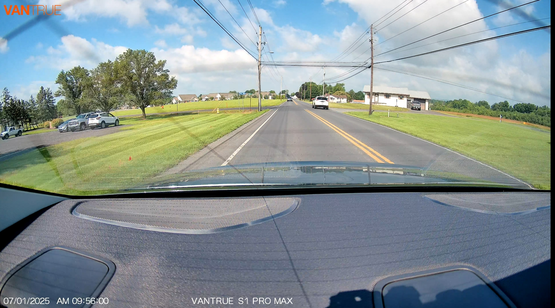

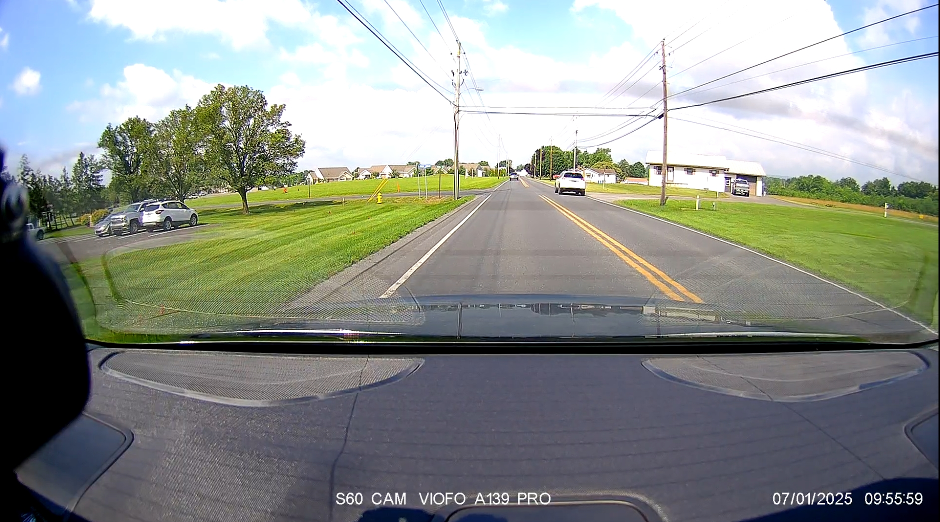

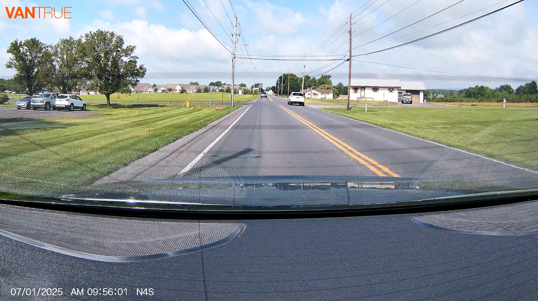

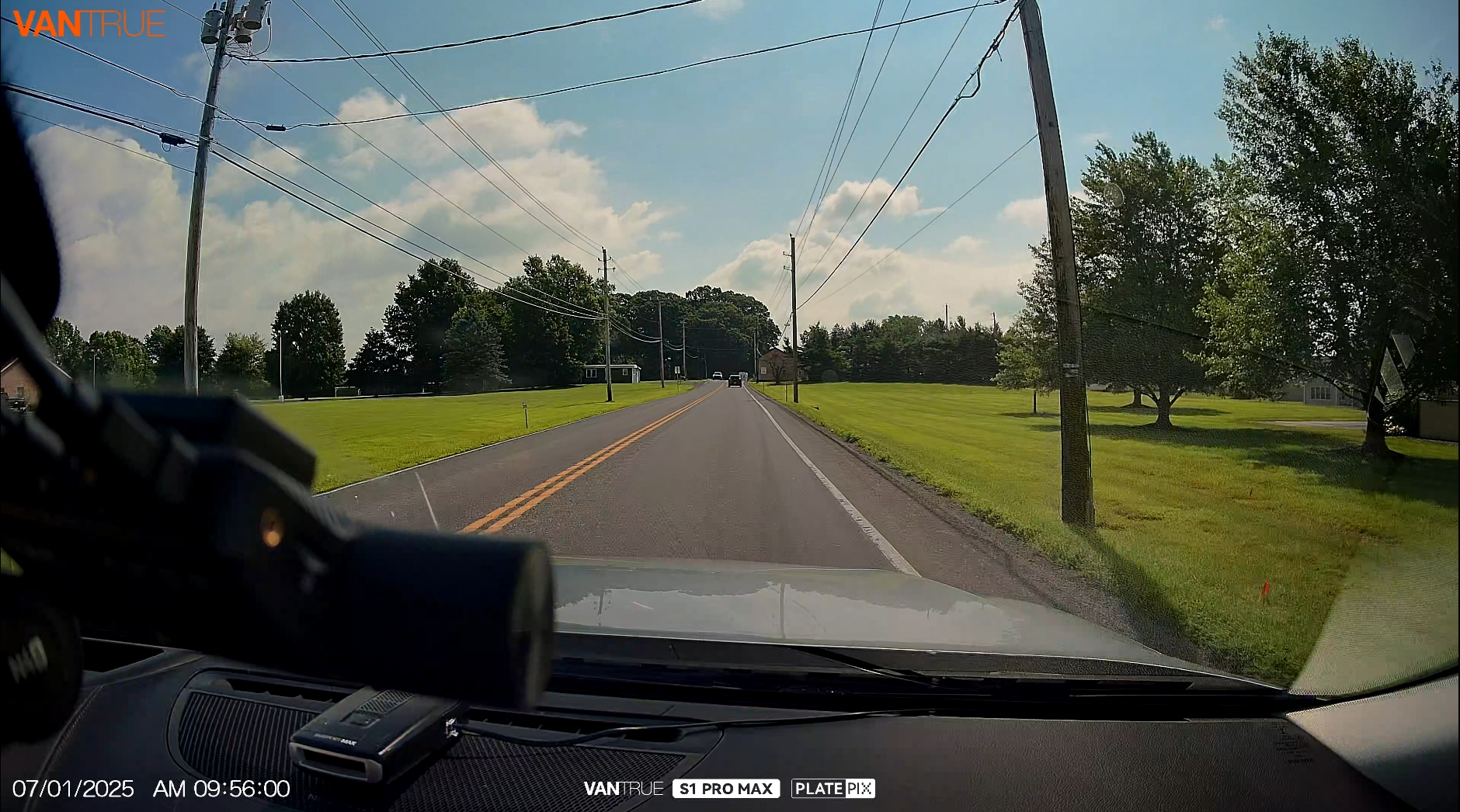

In my last set of images, it was clear that there were some differences in exposure between my three cameras (Post #48 in this thread). Using the Viofo A139 Pro as a fixed point, I adjusted the exposure for the front and rear cameras of the N4S to EV +0.6 and the S1 Pro Max to EV +0.3. HDR is enabled for all three cameras (though I'm not sure that the A139 Pro Rear cameras is capable of HDR). PlatePix is enabled with both Vantrue cameras.
The first three images are from the front cameras. I'm not quite sure what to make of this. The N4S image still looks darker than I was expecting (despite increasing the exposure) and the S1 Pro Max is both darker than expected and has an interesting yellow cast to it.
Viofo A139 Pro, HDR on, EV 0.0 (standard exposure):
Vantrue N4S, HDR & PlatePix on, EV +0.6
And Vantrue S1 Pro Max, HDR & PlatePix on, EV +0.3
Vantrue N4S, HDR & PlatePix on, EV +0.6View attachment 82251

Interesting response you got from Vantrue about exposures. I get the differences in tuning, but it seems that the EV adjustments made little to no difference for the front cameras. This same adjustment does seem to have evened out the exposure differences from the rear cameras, just as I was hoping it would.

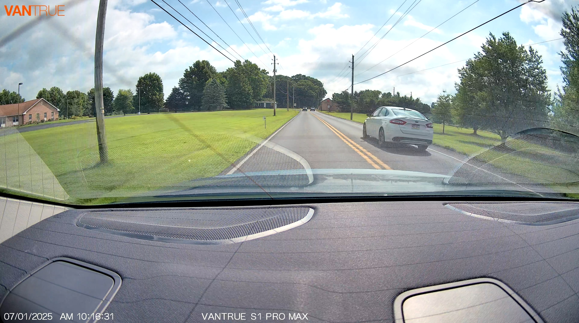

And here are another set of images from approximately the same location, but traveling in the opposite direction (away from the sun instead of into the sun with the set of images above). Same conditions apply: HDR enabled with all cameras, PlatePix on for the Vantrue cameras, and settings of EV +0.6 for the N4S and EV +0.3 for the S1 Pro Max.
Overall, it looks like the exposure adjustments didn't make very much difference with the rear cameras.

Vantrue S1 Pro Max, EV +0.3, HDR on, PlatePix On
