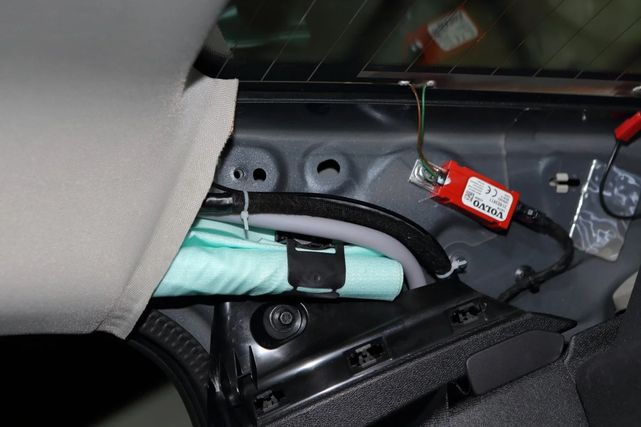

Removing the A and C pillar covers reveals a bit of the headliner that goes along the top of the front and back windows. I tape the end of the wire to my elongated coat hangers and gently poke it through. If it gets stuck, I back it out a few inches, wiggle it a little, and thread it back in. This completely bypasses the need to fiddle with the B pillar cover. The wires run above the headliner, to the side of my sunroof (that I very rarely open). The power cord gets zip tied out of the way when I get to the C pillar and from there it drops right down into the trunk where my parking battery lives. The excess rear video cable gets stuffed under the rear headliner.How do you cross over the B and C pillars to get to the rear window without popping those covers?
