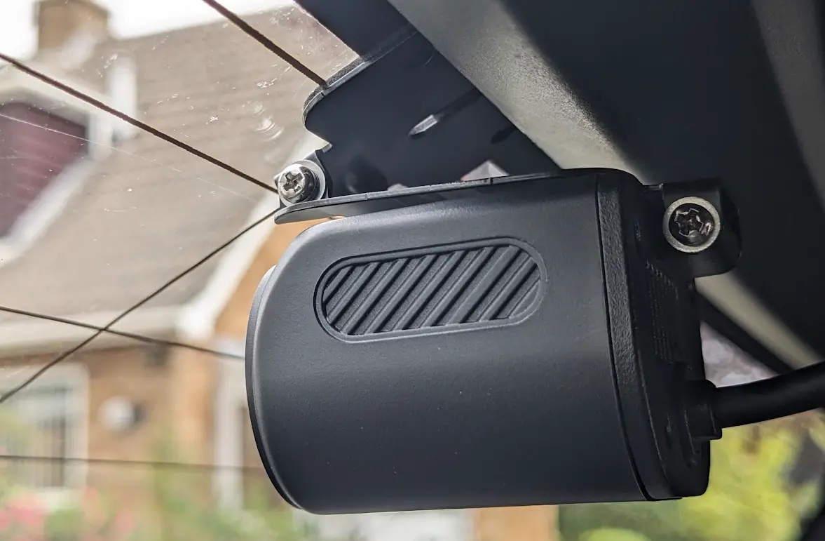

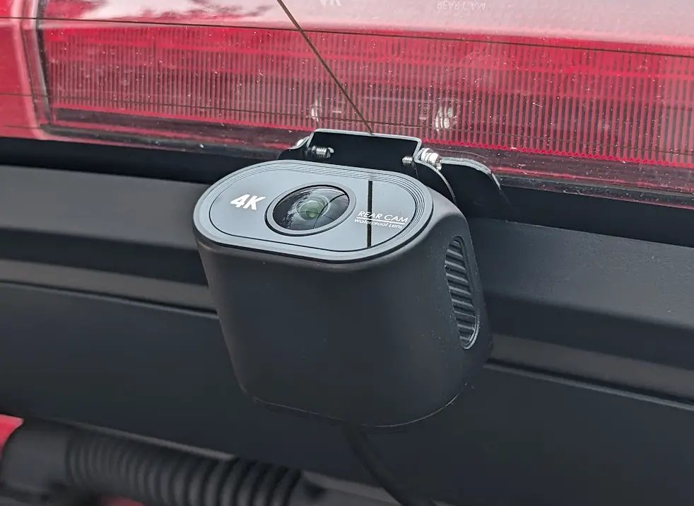

Here's how I have the rear camera installed in my car:
View attachment 82548 View attachment 82549
I really hope you are using the clear anti static pad here... I can't tell whether you are or not. You've got the camera mounted on defrost lines.... Without anti static pad, if you ever remove the camera, the defrost lines are coming with. So fingers crossed the antistatic pad is being used.
I've never used an electrostatic sticker. I have already repositioned the camera to one side because I decided not to have the vertical defrost line down the middle of the video.
I was wondering that aim.
My OCD would have been off the chart with footage like that.
