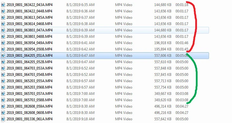

I'm currently testing the h3ll out of a new 512GB card because a couple of weeks ago I happened to see one of the new mid-engine Corvettes on the road (in camo). When I got home to post the video it was missing. The camera was 'randomly' recording short files of 1:15 to 1:45 (red) duration then returning to 5:00 (green) like the camera was set for.This happened to me when I saw a lifted pickup...
The time period from 6:35AM to 7:00AM was one continuous trip. Put the previously used 256GB card in the same camera and all is good. No abnormalities before or after using the 512GB card so I'm as certain as I can be that there's something 'wonky' with the 512 card.
Never got any indication from the camera that anything was wrong.
