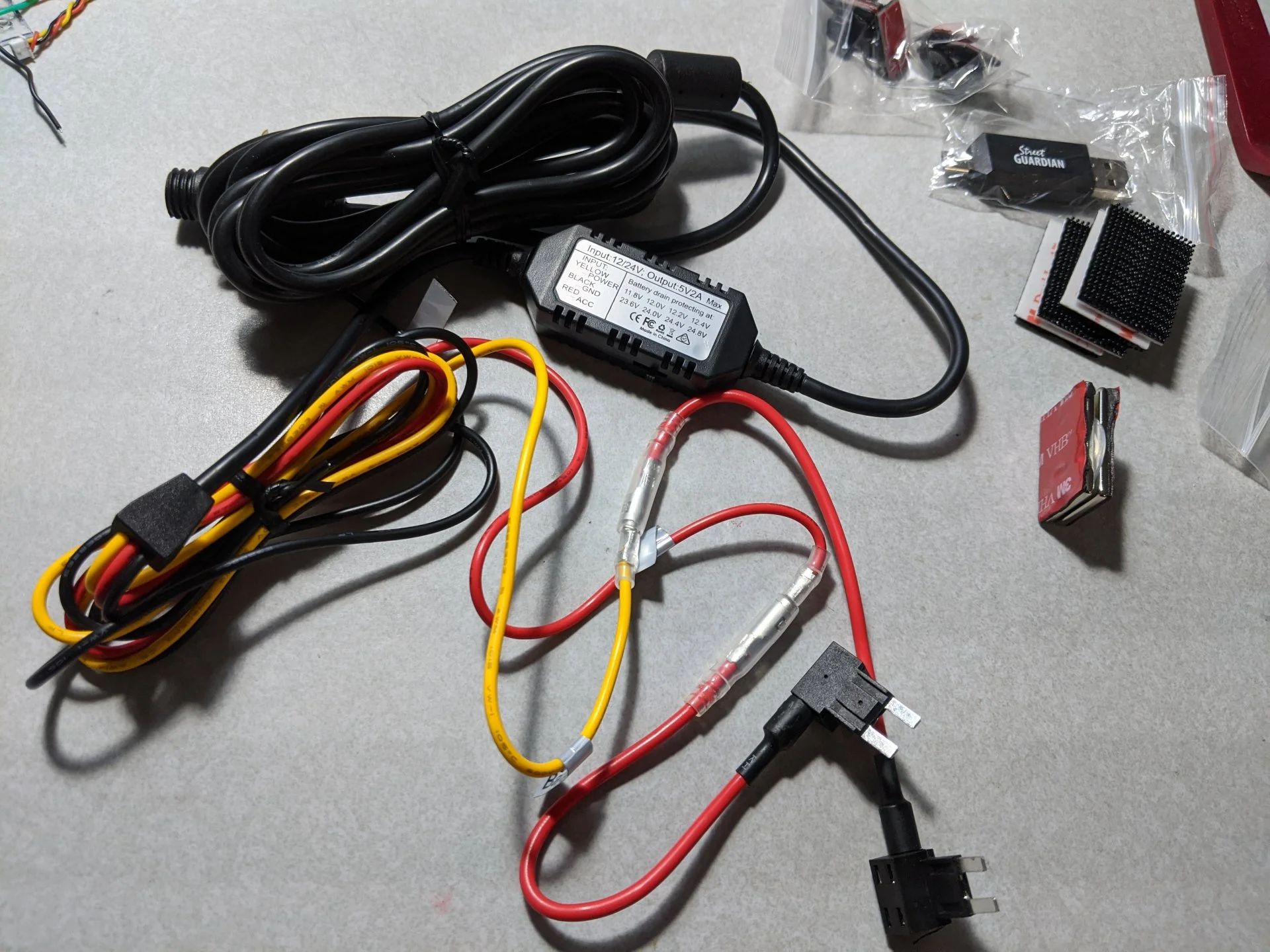

In addition to the 3m dual lock tape for mounting the main unit, there's a set of really strong (presumably neodymium) magnets. And to answer someone's question earlier in the thread, yes, the fuse taps connect with regular old bullet connectors, in case it's the wrong size fuse tap, or you just want to use your own connection. With regular cameras, I often tapped directly into the map lights, sunroof, and/or auto-dimming mirror wiring that's already in the overhead console of most vehicles so I don't need to run anything down the A-pillar. With this one I may tap into the radio or lighter wiring instead.
