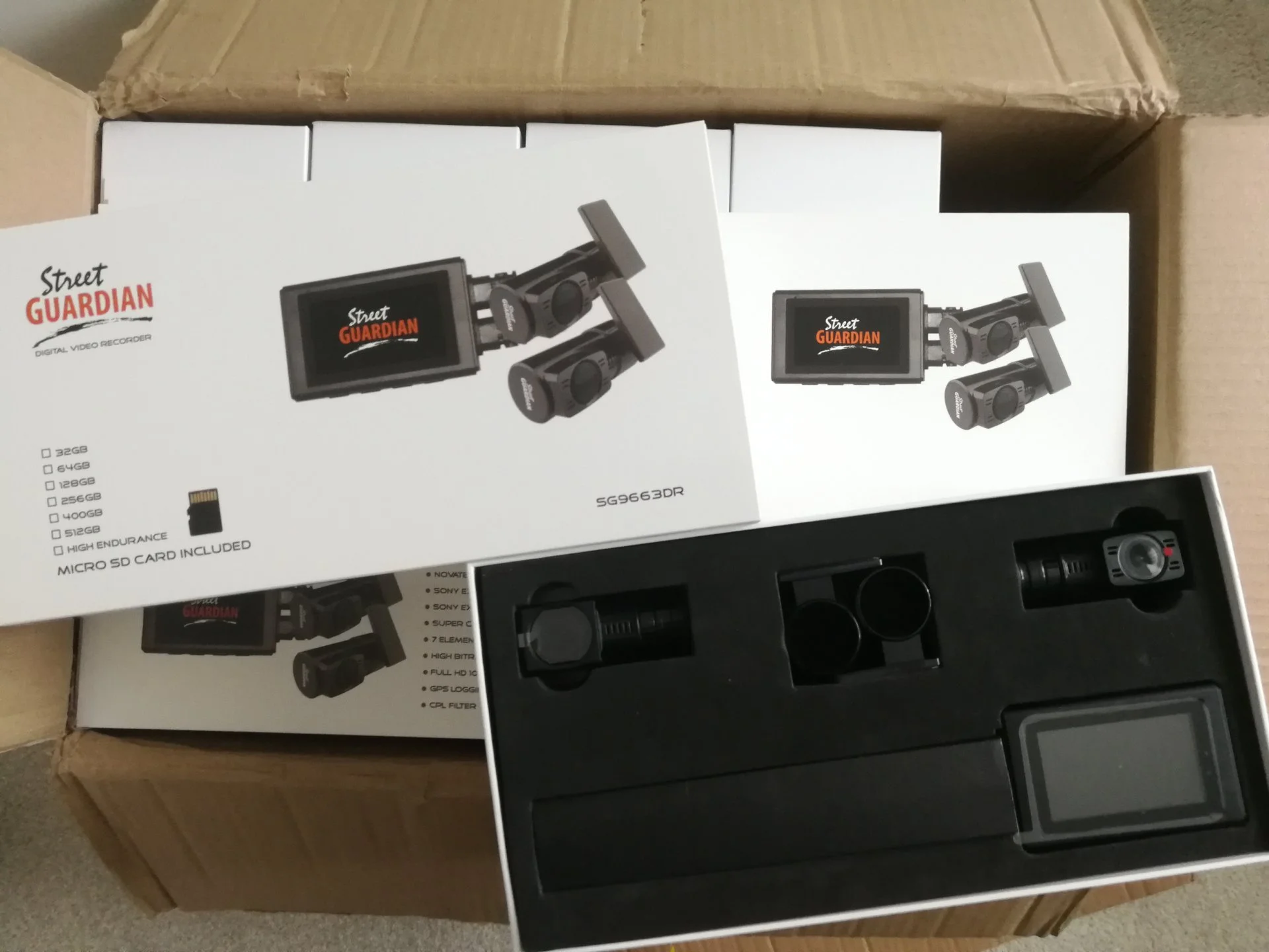

Canadian stock is still a few weeks awaySam @Street Guardian Canada will take care of you in Canada. I see the DR product details page is up on the Canada site so active pre-sale should be ready soon.
That's correct, a soft launch just happened.
USA received a small batch last week and that small-batch sold out.www.StreetGuardian.CAM & Amazon.com/streetguardian
dashcamtalk.com
There is a 2nd small-batch en route arriving either Friday or Monday. (scheduled for Monday but DHL is almost always a day early)
If you per-order now it will ship out when the 2nd small batch arrives.
We'll have heaps of DR's in stock when the slower sea freight arrives a few weeks from now.
