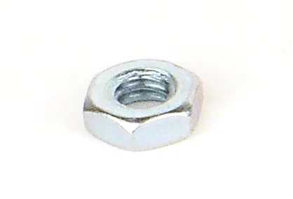

I would recommend to fill that gap with strong epoxy-glue and glue on top a 1/4inch tripod nut, then you can use any suction and other mounts which are meant for to be used on devices which has a tripod nut ( GoPro, digital cameras etc ).
Sorry to hear about this accident, but there is always a DIY way to fix it.

@BMbler, The mounting slot on my GT680W broke the same way. An easy thing you can do is to just glue in any standard 1/4-20 threaded hex nut to the top of the camera and then you can use any tripod mount you wish on the camera.
@BMbler, The mounting slot on my GT680W broke the same way. Any easy thing you can do is to just glue in any standard 1/4-20 threaded hex nut to the top of the camera and then you can use any tripod mount you wish on the camera.
This was also my idea "back then a while ago", but by my surprise two local harware stores didnt had them in stock and instead on wasting time and diesel on driving around and search I ordered online. Yeah, I can be "lazy-convenient, practical ?" some time [emoji6] .
