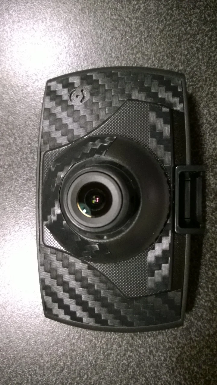

Shadow-Tec RX300 Carbon Fiber Edition 🙂
This was just a quick one made of some carbon fiber vinyl left overs I had. But gives a hint...
Do you have any templates for this left to share , like which can be scanned on A4 paper and emailed to be used to cut out.
