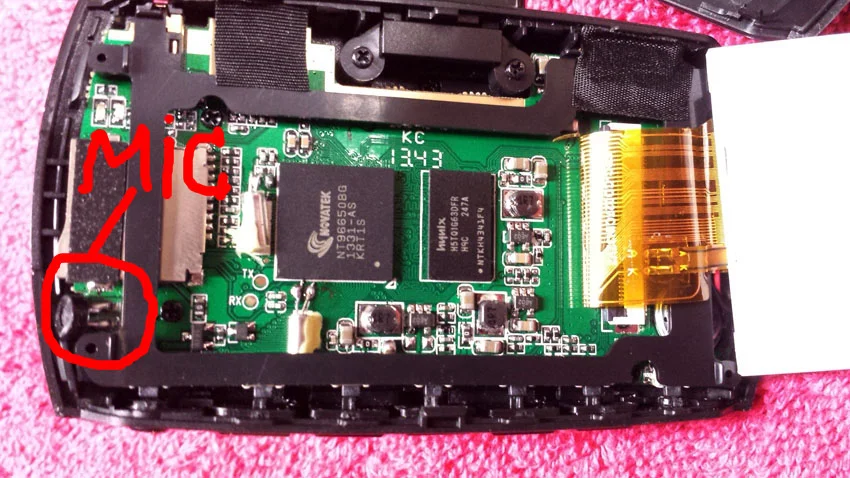

Did you take some photos with disassembled item?
I did not take photos. There is simple - 2 screws at the top, where the connectors and 2 screws where the buttons are. Carefully open the case (there locks).
Watch it here
