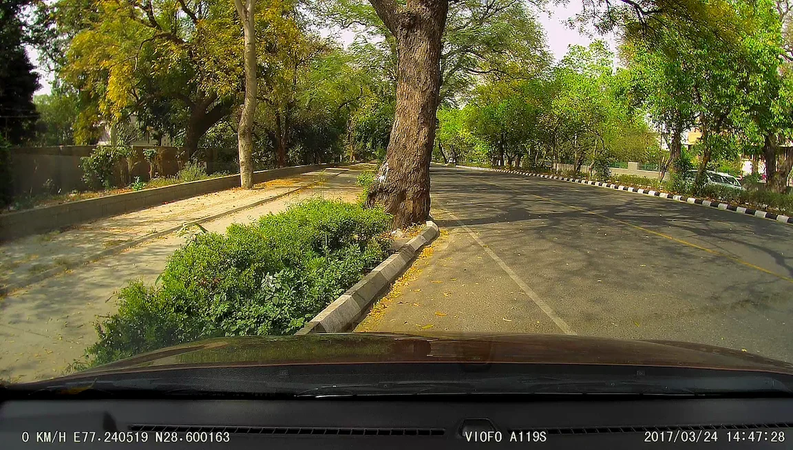

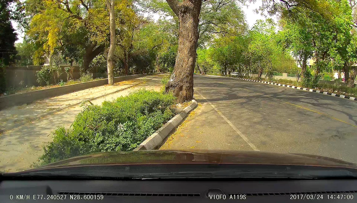

Can see a lot more hot pixels with WDR turned off.
Streetlights; ambient lights; taillights and headlights, all flare a little more and the halo effect is also a little more pronounced.

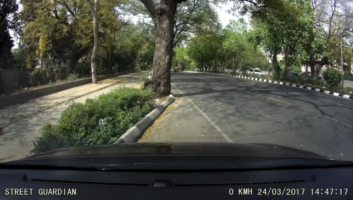

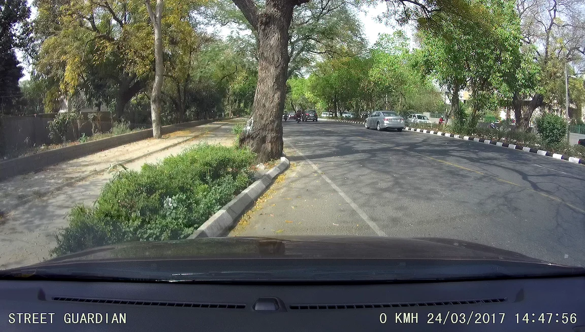

The SG9665GC's image gets brighter with WDR-On, whereas the A119S's image dims when WDR is turned On.
@viofo Please tone the sharpness down a bit, looks overdone.
