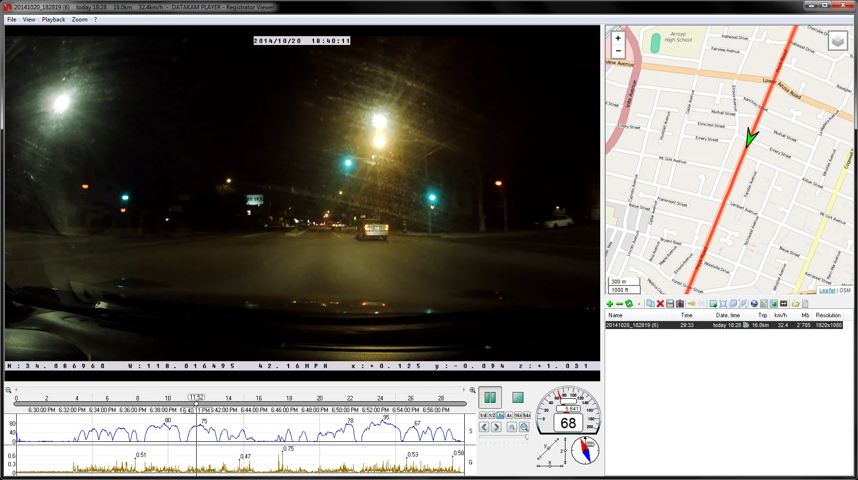

It looks like with the latest beta firmware, the missing speed is fixed, but for some reason, Registration Viewer doesn't display the correct speed.
Any one else having the same issue?
Hi raqe you have the Panorama G set to display MPH but haven't changed the setting in Registration Viewer to display the same.
In Registration View Select the View menu move down to Measurement then Select British system (feet, miles).
I have tried the new firmware for the last two days and not encountered any dropped gps data like before. Registration Viewer displays a few mph spikes that are well outside the speed range for my vehicle but the encoded speed in the video remains correct, so not really an issue.
