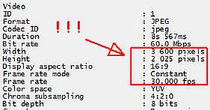

New firmware from yesterday ... not 4K/"2x15fps" ... REAL 30fps, buuuut only 3600x2025!
It's no problem for me ... better than jumping 4K, BUT it is NOT 4K :-(
Why they do not expand 2880x2160 - like others?
Maybe they needed the rest of the pixels for the gyro stabilisation, and it didn't have enough processor power left to scale the remainder up to 2160?
That doesn't give much room for the stabilisation though! You really need a 16MP sensor for true 4K and gyro stabilisation.
