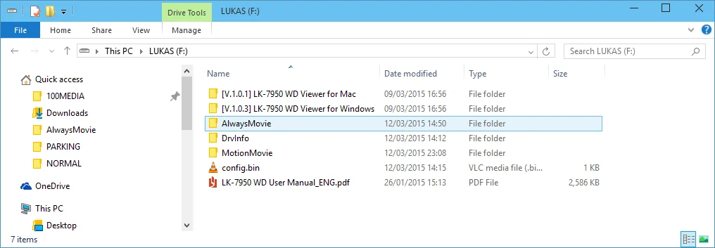

By default although the camera has two memory card slots - one full size SD card and one microSD card, it appears that the type of file is split.
On the full size SD card it now looks as per the following:

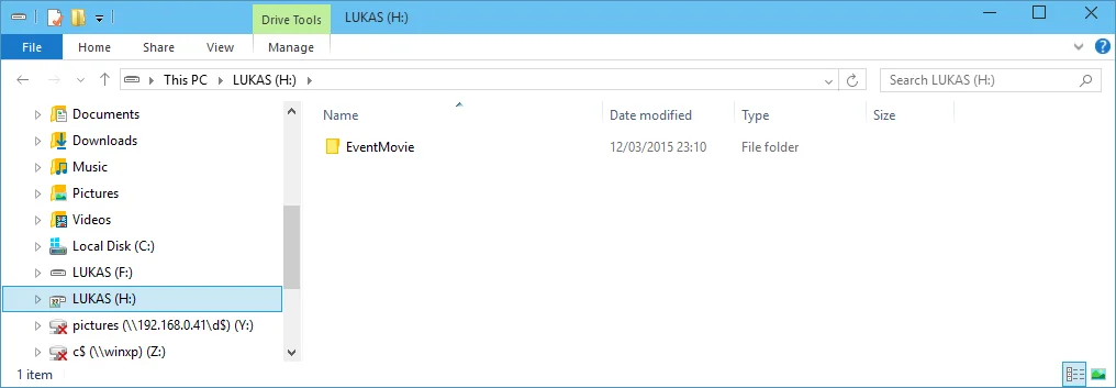

And the microSD card looks like so:
The file layout by default is as follows:
Full size SD:
AlwaysMovie - Driving mode video from both channels (with F or R suffix)
MotionMovie - Parking mode video from triggered motion sensor
MicroSD:
EventMovie - Event mode video from when G Sensor is triggered

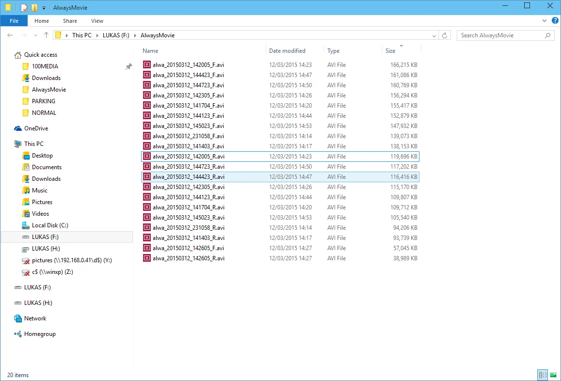

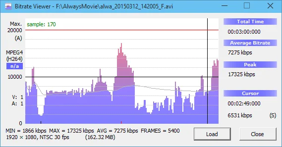

The Lukas camera records in .AVI format - both channels are encoding using VBR video.
The VBR on these cameras is extremely aggressive and you can see that front video has an average bitrate of 7.2Mbps and a peak of 17.3Mbps.
The rear camera is a lower bitrate - you can see in this instance it's got an average of 5.2Mbps and a peak of 9.7Mbps
By default you can see the front and rear files are signified by a suffix of either _F (for front) or _R (for rear):
Bitrate Viewer is a good program !
Yeah I think @Mtz pointed me in it's direction first - definitely a great little app. It's surprising how aggressive the VBR is on these to run at lower levels but the graph shows it. The big spikes seems to have been when I went through a tunnel and the AE worked out what was going on in there 🙂
I also just downloaded it after seeing your screenshots and was exited to test some videos, - quite interesting graphs to see how data changes depending on surrounding light conditions. Thx to @Mtz as well ! 😉

I'm confused.
If there are two separate drives showing up in the PC, F: (AlwaysMovie) and H: (EventMovie), how is it writing to only one drive?
Or is the H: only saved for event videos and both front/rear videos are recorded in F:?
I think I've answered my own question. 😀
You've got it mate - I had two separate cards hooked up via a multi reader 🙂
