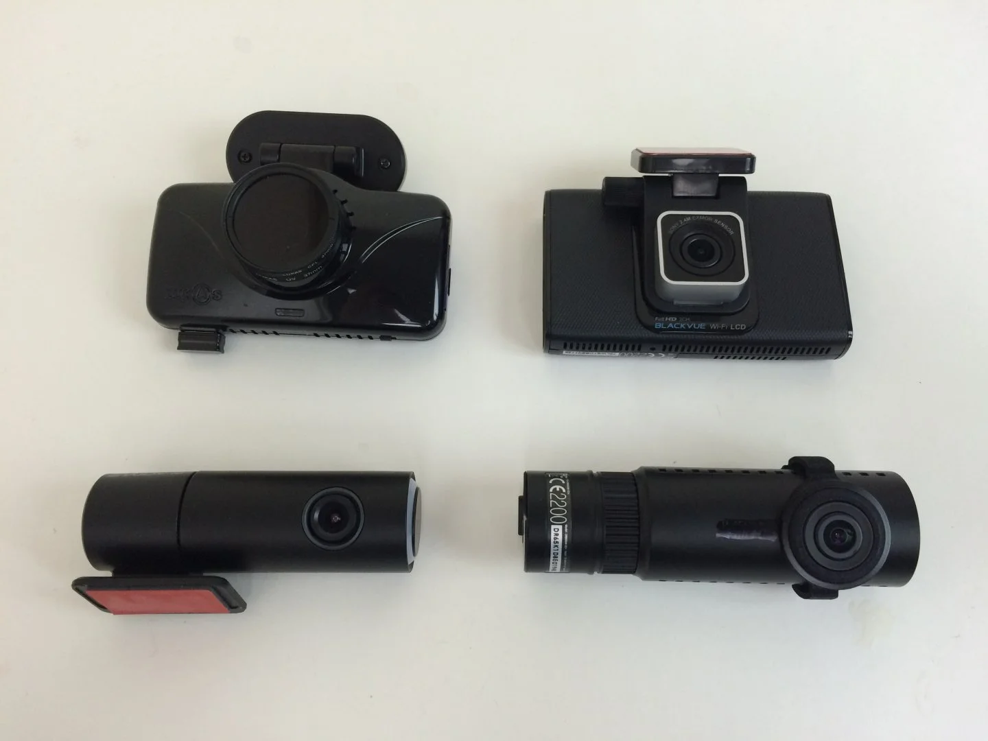

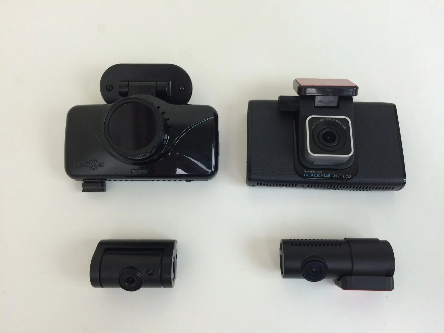

here are some comparison shots.
my first impression is the plastic feels a little cheap. i also don't like the glossy look of it but these are just cosmetic complaints. I have not hooked it up yet. I actually need to review the blackvue 750 first but hope to get both tested and reviewed over the next 2-3 weeks. excited to finally try another "higher end" wifi model with no screen.
