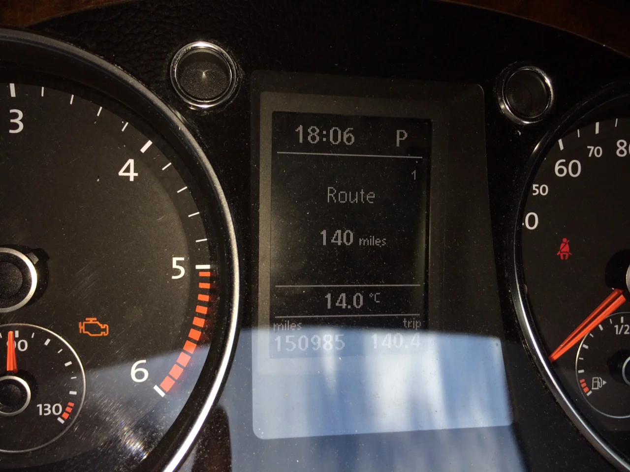

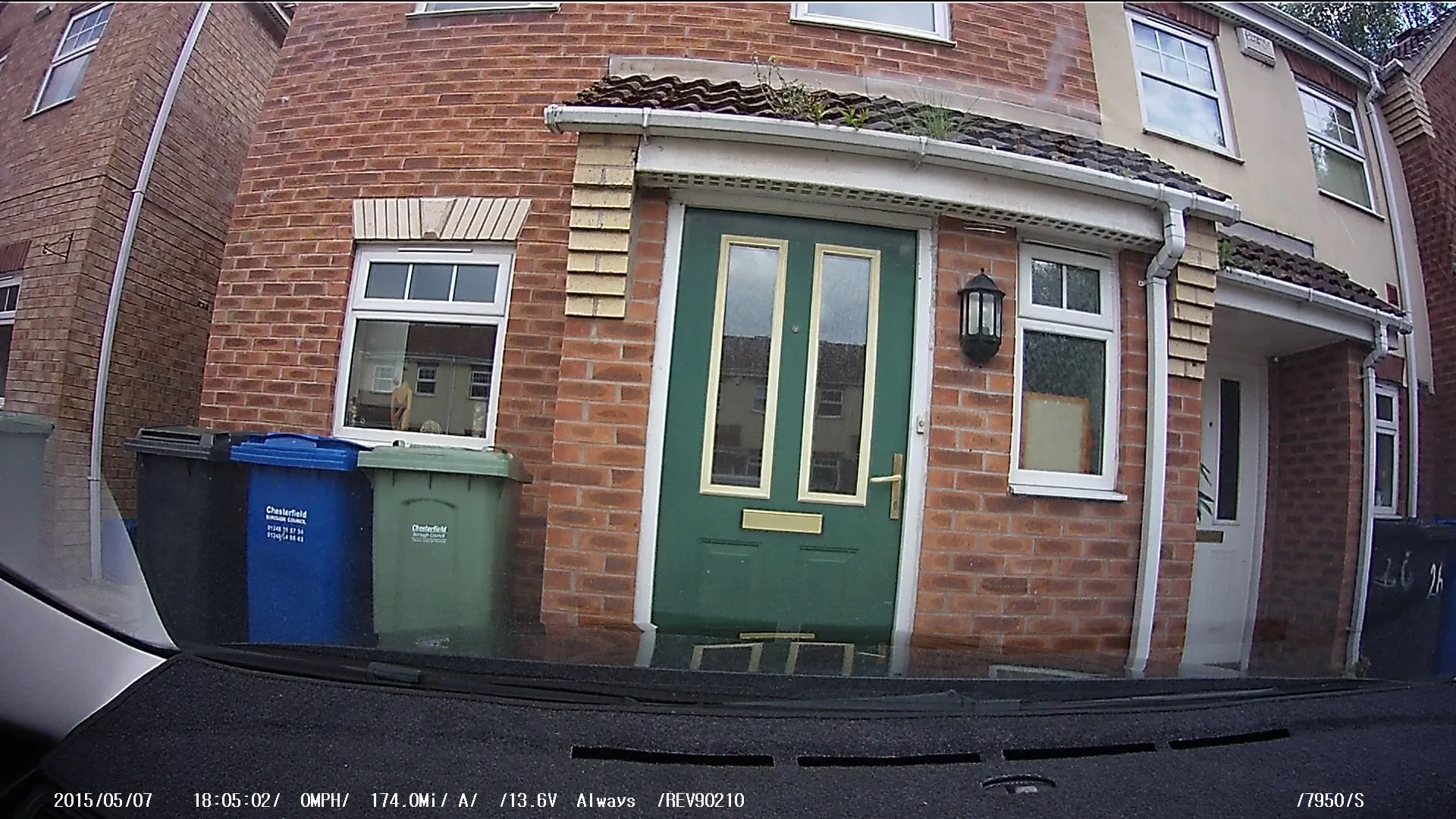

This one is pretty self explanatory showing the ongoing issue with the speed counter reading incorrect information.
140 miles shown on the trip computer, 174 miles logged by the Lukas.
Still no response from them as to whether they'll ever fix these problems - I really hope they will as stability has been fine otherwise with no focus issues in the heat etc.
