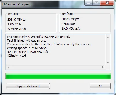

I formatted and checked the Lukas full size SD card out tonight:
I did notice that for the last few hundred MB it dropped to around 1MB/sec - that would definitely be enough to cause this sort of problem - as the card leaves a percentage free for motion videos etc maybe it's the wear levelling at work?
