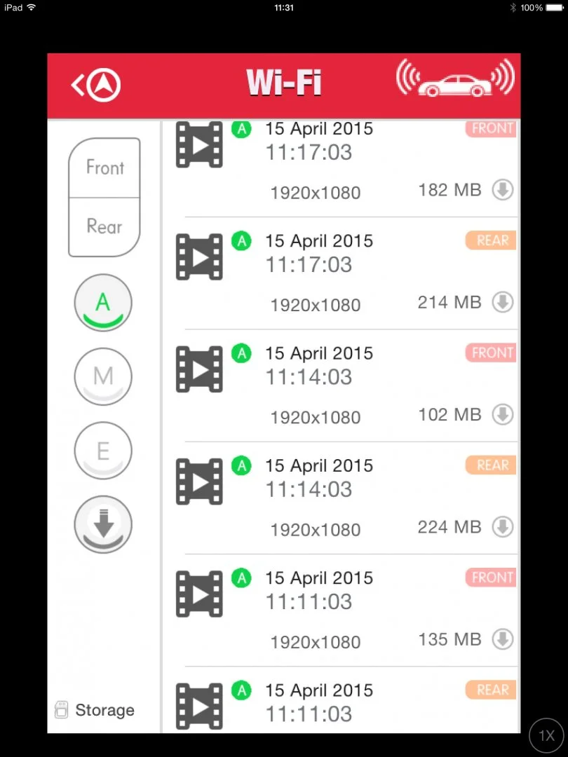

I bought two of these bad boys for my driving school cars. Both are regularly display CHk on the LED segment display, and missing large parts of the recordings, similar the video posted above. I have used the supplied 8GB cards, as well as a couple other clas10 cards, but nothing seems to fix it. The error message is displayed at least half of the time, sometimes 90%.
The file sizes it creates are HUGE. The front channel typically records 180mb clips (3 minute) and the rear anything from 180-220mb per clip. Changing the quality has little/no effect.

From the research I've done, I can't help notice that the sizes of the files it writes seem much bigger than others.
Average front clips are about 120-180mb in size, and rear clips >200mb for 3 minutes segments on any quality setting. I normally use the lowest. I would appreciate if anyone could compare their recording to mine.

Rear over 220mb is too high. Mine are only around 115mb for rear and around 160mb for front.

Thanks for your reply. Makes sense that it can't write the files quick enough if they're that large. I am running the latest firmware and have reinstalled it a few times.

To be honest the 90MB/sec cards should be able to easily handle it - this camera even with your files there is only generating less than 10Mbps for the rear channel - that's just 1.24MB/sec.
It is sounding like they've got a firmware issue here as the card should easily be able to handle the low bitrates it uses across both channels.
