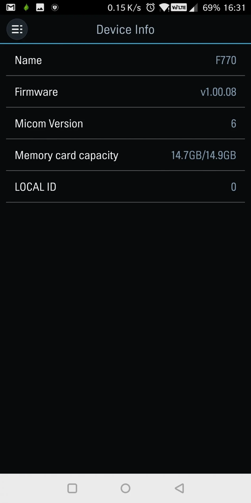

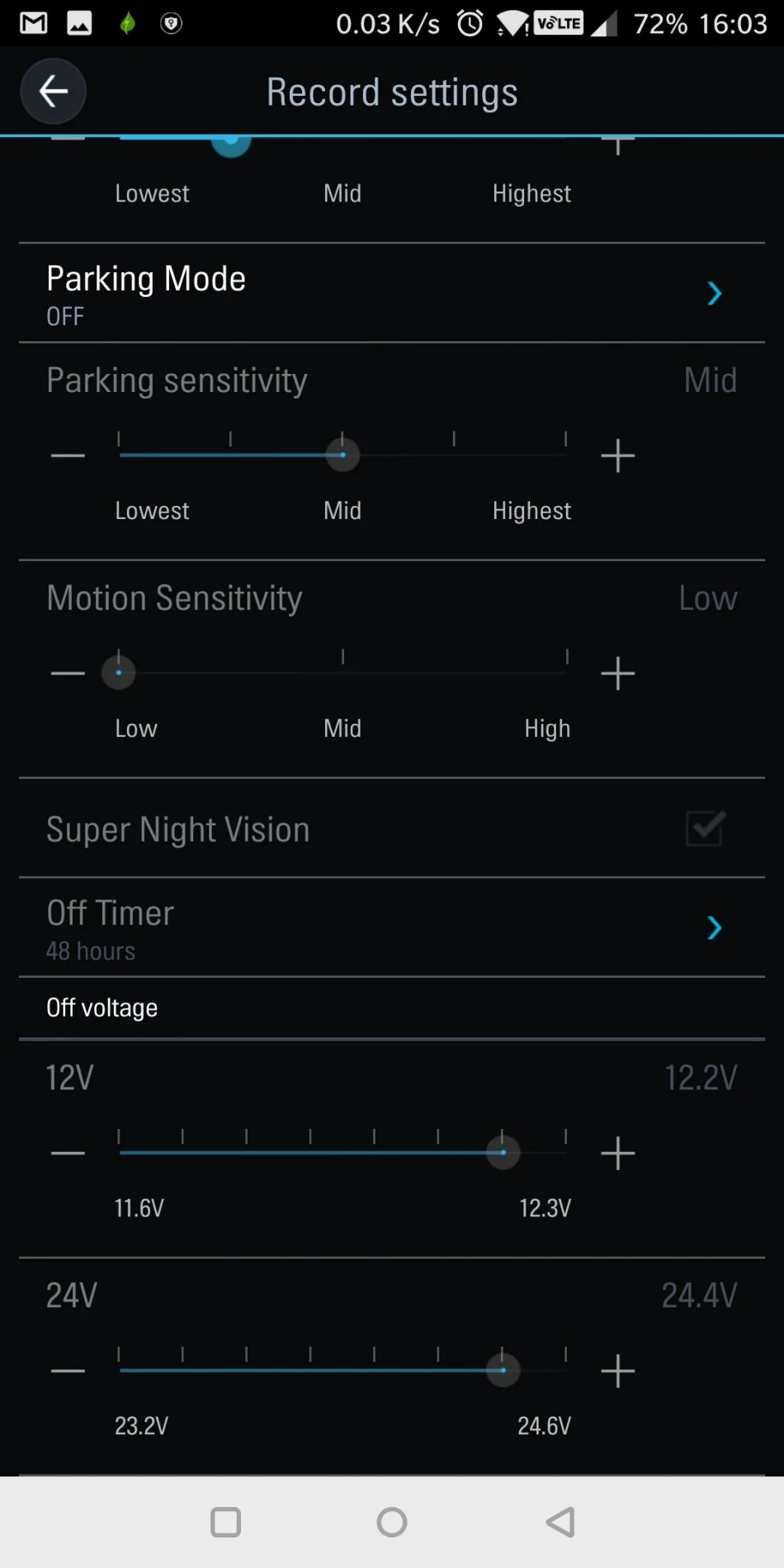

Interesting .. here in US I got the camera with the F750/1.00.15US firmware, then flashed to F770/1.00.02US and the Super night vision appeared. Then I decided to flash to the latest F770/1.00.08 and now everything looks like is revert back to F750 even tho it says F770. The super night vision menu is gone, so just everyone knows, somehow they patched that security breach in our cameras. So after some trials I was able to load the F770/1.00.03US successfully and all the features of the F770 are available again. But definitely avoid the F770/1.00.08US.
That's strange as my F750 updated to F770 works the same after I updated to F770 1.00.08UK as it did before the update, including super night vision.
Well, see for yourself, I am pretty sure that I did everything correctly and right after it allowed me to go back to F770/1.00.03US got the features back. So do it on your own risk people. Just trying to prevent you from loosing the nice features..

I was a bit worried about this because I updated my F750 from F770v06 ro F770v08 and apart from hearing it announce that the update was successful, I hadn't checked it. So I just did and I can confirm that it states that it is on v08 and the F770 features of time-lapse and night vision are available. So that seems to confirm that my F750 has successfully updated to v08 and still has the F770 functions.
I updated my F750 to F770 firmware ver. 08 with no problem. It went through the usual upgrade procedure and acknowkledged the upgrade and proceeded to record.
Confirmed, F750 to F770 firmware update to 1.00.08 with no problem, super night vision still there.
