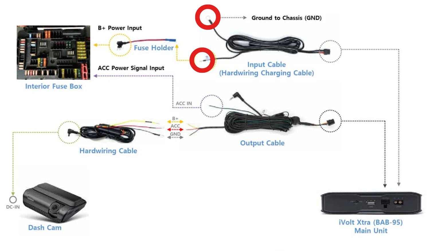

I've been using an iVolt Xtra BAB-95 battery pack with a U3000 for the past several years and the U3000 Pro for the past several months. I haven't encountered any problems as stated in this thread, but I have not tried to take the 3-wires dash camera power wires from the BAB-95 and splice them into a Thinkware OBD-II power cable with the Thinkware OBD-II power adapter still connected.
If you don't have the Thinkware 3-wire dash camera hardwiring cable to use to splice together with the 3-wires coming out of the 6-pin connector on the BAB-95, I can understand how you might want to use the 3-wire cable portion of the OBD-II power adapter, but leaving the OBD-II plug still connected I think is where this may be going off track. The red [ACC power] wire to the dash camera is used only for sensing non-zero voltage levels [non-zero = normal recording mode / zero = parking mode]. The cable that plugs into the dash camera must have all three wires connected for this to work correctly.
If you're going to use the 3-wire cable from the Thinkware OBD-II power adapter, simply cut the 3-wire cable off from the main Thinkware OBD-II power adapter. If you want the customer to be able to use the Thinkware OBD-II power adapter in the future, I would recommend putting the same electrical connectors on the end of the wires from the Thinkware OBD-II cable as you put on the 3-wires coming out of the BAB-95 6-pin connector. The customer can simply unplug the 3-wire cable with barrel connector from the BAB-95 and reconnect it to the Thinkware OBD-II power adapter [if needed in the future].
The three wires for the cable that plugs into the dash camera power port should be sourced from the same source/device. The red [ACC]/yellow [BAT]/black [GND] from the 6-pin BAB-95 connector should be connected to the same corresponding 3-wires in the cable going to the dash camera.
The other option is to simply purchase a Thinkware 3-wire hardwiring cable and leave the Thinkware OBD-II power adapter out of the situation completely.
Thinkware Website: How to Install the iVolt Xtra Battery Pack
