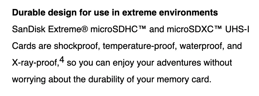

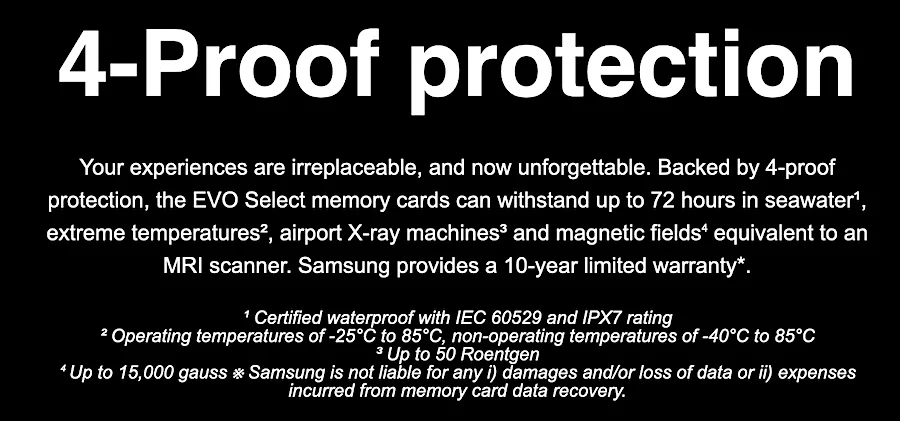

Most microSD memory cards have had all the same rugged protections as these newer "Outdoors" cards claim and have for quite some time, including immersion in liquids and seawater for 72 hours.
This is what Sandisk says on their website and apparently it's not just limited to the Extreme line.
The older Samsung EVO Select cards offer this level of durability as well.
Even the ancient SanDisk Ultra cards offered the same protections, so these features have been around for a long time.
This is what happens when the marketing department gets involved - as in politics, the truth is secondary to image.
