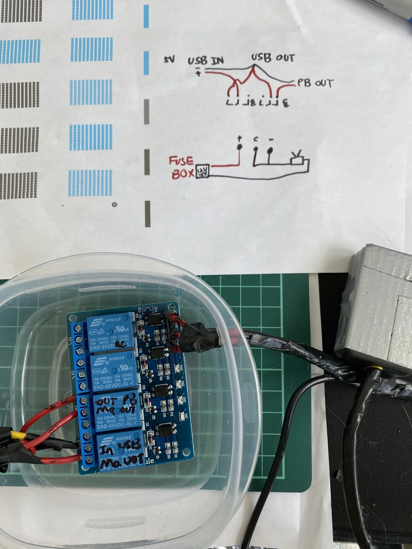

I just received my new Viofo A129 pro duo a few days before, but I been to stay at home for the whole time, so I'm wondering to make something.
First of all, I'm new to the circuit and English, so if you find any problems, let me know, please!
So I did some research from the forum, and end it up this.
Things I use:
12v-5v hardwire kit (control relay board)
5V relay board from Amazon CA
Toggle Switch
Few USB cables
Philips Power Bank (5V1A& 5V2.1A output) 5V1.5A input( It will not output power while it's charging)
Once the car is on, the car will power the PB and dashcam. When the car is off, I can use the toggle switch to turn on the relay, so the power bank can output power.

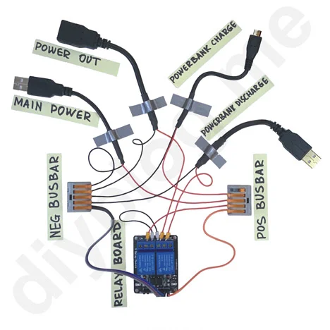

Before this, I was following this wiring diagram from the forum, but it's not working for me. The dashcam won't work properly, don't know why. And I find out the charging cable to PB has to separate.
Now, I already tested for a few hours, no problem yet.
During this time, I also put some reflective vinyl in my car.
What do you think?
So as I said, I'm new, so if you find any problem, please told me. I will keep posing update.
