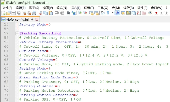

Is there any way to get a complete map of all the choices in the menus?
Yes. If you export the current settings to microSD then open the viofo_config.ini file in a text editor you can see all the available options, plus the one you have selected.
In the example below from the Viofo blog page, the text in green is the list of options, followed by the text in blue which is your current setting.
Thank you! I thought I remembered seeing that somewhere, but couldn't immediately find it.
