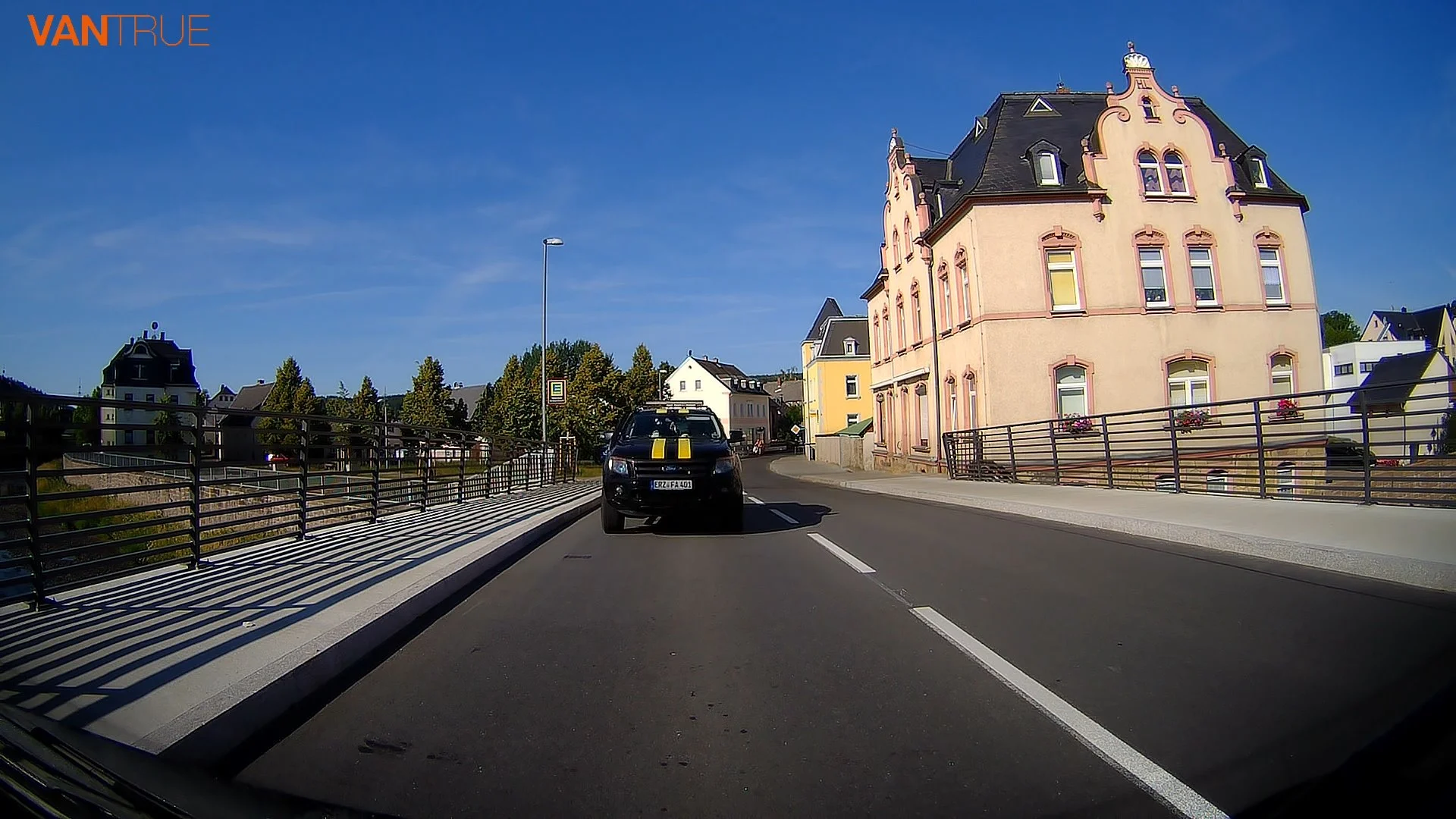

N4 Pro rear camera issue with focus when heated while working? In addition, the stamp on the video is not displayed.
The first screen was taken about five minutes after turning on the N4 Pro, the second screen was taken 65 minutes after the first one.

Think I'm coming to the same conclusion with the Vantrue N4 Pro. Rear camera have focus issues after using for some time.

You sure that's a focus issue? Looks to me like motion blur and/or over compression of the image than optically out of focus.
Why is everything ok in the first screenshot?
I've watched enough video files to come to that conclusion.

Maybe some other heat or time related problem. Could be a software bug. Just suggesting it may not be optical blur (caused by the lens itself somehow going out of focus - after all, it's a fixed focus fixed zoom lens with no aperture adjustment mechanism either)
Did you take both samples whilst the car was stationary? If not at he same speed? Both roads smooth? File sizes about the same? HDR off? Does is there meta data in the recording that compares the same? etc
Would be interesting to take photos to compare at this time. If they're equally sharp, it's a software/video recording issue, not an optical/lens issue.

I'm sure the problems you are reporting are genuine. The second photo doesn't look right compared to the first.

Because it is made after 70 minutes of operation of the DVR.
The temperature outside was about +27 degrees Celsius.
The rear window is not cooled.

What was the temp in the car set to (you have aircon)?
Between the video files from which the screenshots were taken, 65 minutes and most of the time the car was in the parking lot,
so there is almost no sense from the air conditioner for the rear camera.
