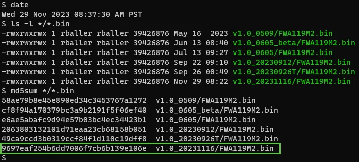

Still downloads the exact same file i downloaded last week, V1.0_20230912. same size in bytes and hash. Have not flashed it though.Overnight, VIOFO sent me an email stating the v1.0_20231116 firmware file has been correctly posted on their download site.
I checked and the file has been updated. I downloaded it and installed it. The firmware version does show that it is the updated file.
All of the A119 Mini 2 firmware files have been the exact same file size (in bytes). I just downloaded the file three more times and each time I downloaded the updated file. Unless your download request is being routed to a different server in their download site, you should be getting the updated file.Still downloads the exact same file i downloaded last week, V1.0_20230912. same size in bytes and hash. Have not flashed it though.
Strange. But, i just checked the MD5 for the file i get, it matches yours in you screenshot. so i guess it is the new file.All of the A119 Mini 2 firmware files have been the exact same file size (in bytes). I just downloaded the file three more times and each time I downloaded the updated file. Unless your download request is being routed to a different server in their download site, you should be getting the updated file.
It really shouldn’t be. Very unusual thing. And I deal with firmware on many networking devices, main board bios, and other embedded devices. Unless it’s an exact image of a partition or whole ROM chip. Maybe that what they do.Have you finally realized that firmware can be the same size regardless of the firmware version....
