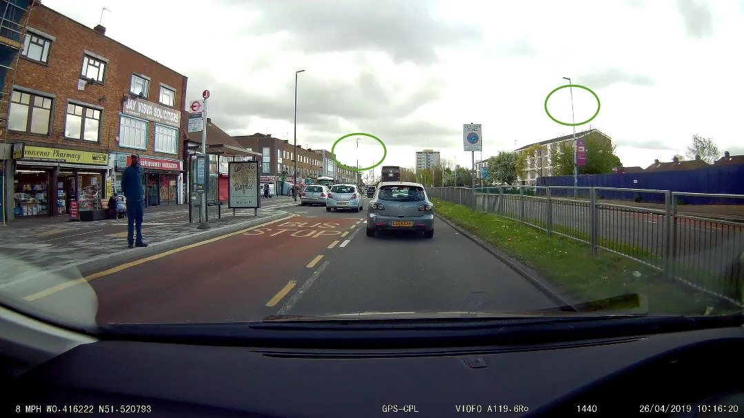

I'm curious - what's wrong with A119 DCTeam 6Ro? Please see the dropouts in the green circles... I looked at the Stock.MP4 and did not see anything like I see in the 6Ro movie. (The image was made at about the 1 minute point.)
Not seen the "drop outs" you indicated. If it is only lamp posts, no worry. All footage I have taken trialling this MOD as not shown anything similar. Is your screen spotless ( no water droplets, dirt, or bird droppings)? Would need to see more that one frame to clarify.
Against a bright sky it is possible the image sensor can get swamped by the light and bleaches out some similar coloured items. This is an hardware problem and can occur with any auto-exposure cameras especially the lower expense ones. The difference from stock and MOD firmware is the vibrancies of the colours and no blocking of detail of greenery at roadside. Which may cause a bit more bleaching in certain situations. Its up to the individual to decide which picture they prefer. The choice is yours and yours alone there is no pressure on which to use. You could try raising the Dashcam up a bit so less of the dashboard is seen this may help the image sensor in brighter situations.
A question for you. Why is your country AMERICA but picture is UK and a UK car?
That sample picture is a copy of my donated comparison footage, stock v mod.
The footage comparison was the same road but driving towards the sun. I do have another 2 clips that are driving north/south and would probably produce a better comparison. A job for my next PC visit.
I can't raise the cam any more as the windscreen black dot section is just above where I have it pointed. The GPS mount is stuck on the black dots with the lens just poking out below, I can't go any higher up the screen.
The blow out sky will cause that effect for anyone with stock firmware or MOD when you aim the Lens too low. It is a normal brightness & exposure automatic adjustment especially on cloudy days. Your expectations from a $100 camera is much too high, these are not $600 GoPro cameras.
