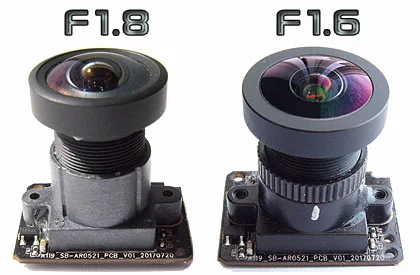

Thanks for the early sneak peak at the new Viofo A119 V3 1440p Sony sensor night vision Dash Camera.
46483
Can you confirm that is the same F1.6 Lens I used in my A119 Pro DIY upgrade which is also used in A129 Duo and A119S ?
