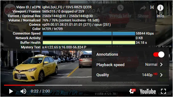

YouTube's higher upload Bit Rates use VP9 video codec, verify codec with right-click on video, select "Stats for nerds".
Google Chrome: VP9 video codec is enabled on all OS.
Linux: VP9 is enabled in Firefox,
Mac: VP9 is disabled in Firefox, thus only H.264 with 1080p will get played.
Windows: VP9 with 2K or 4K depends on the machine
enable VP9 in FIREFOX by setting media.mediasource.webm.enabled to true in about:config
