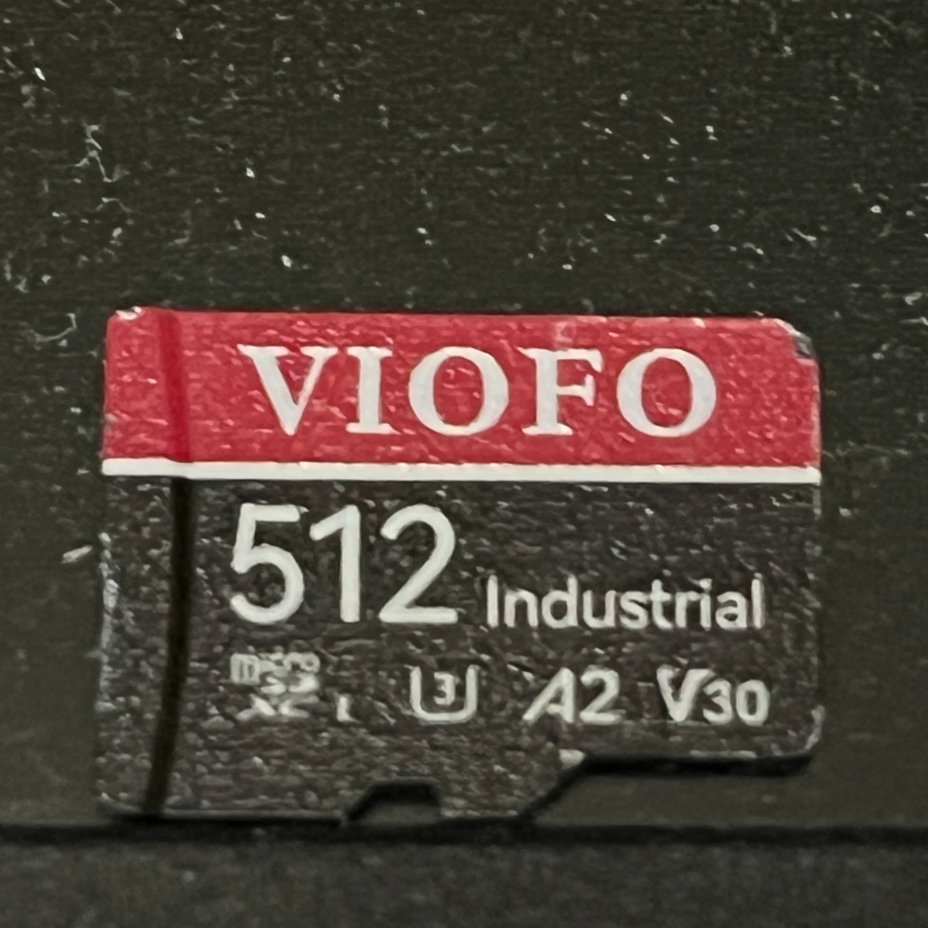

I’ve been testing with Viofo Brand 512GB SD Card, HK6, and original Viofo brand power cable, (20AWG).

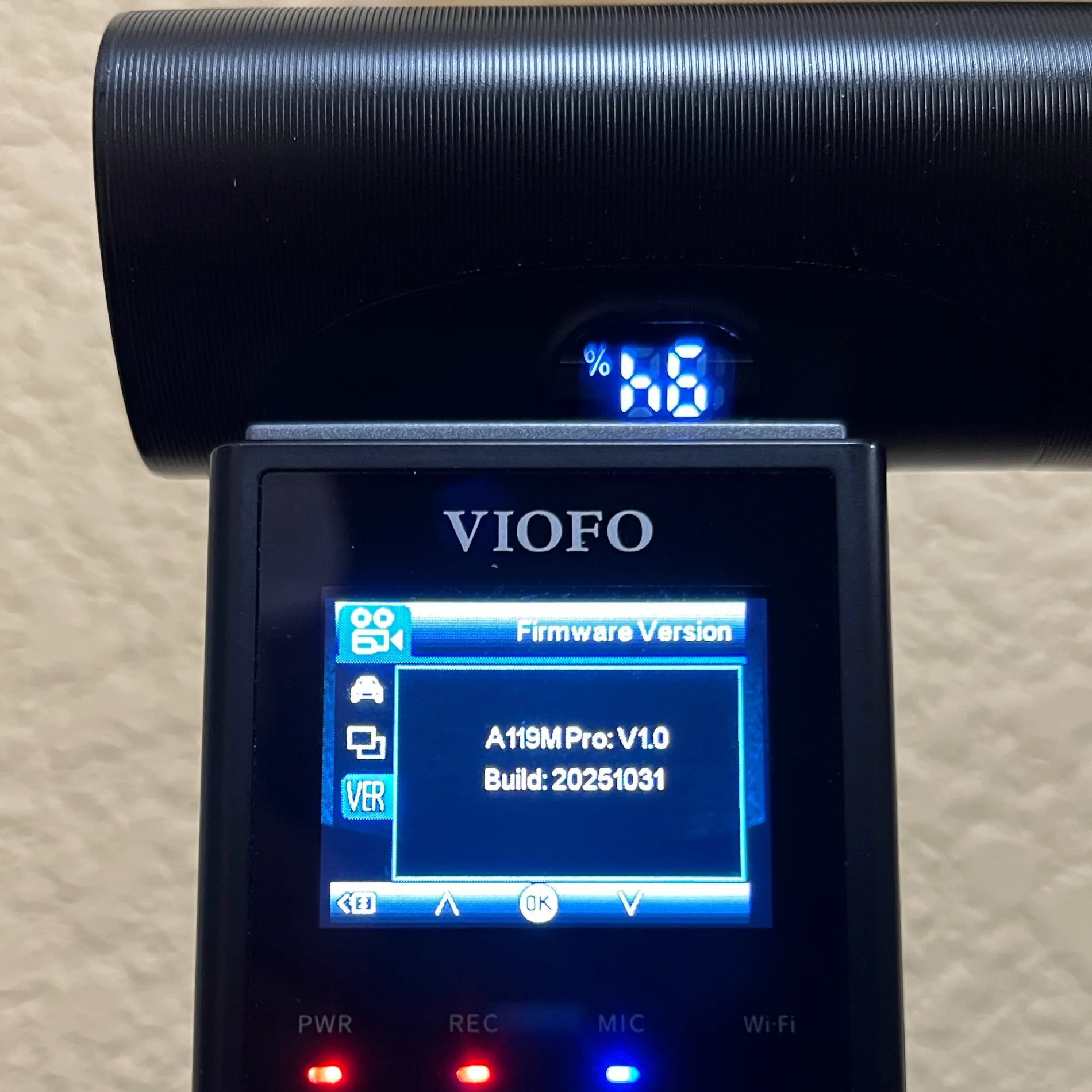

If you have doubts about the newest firmware here is a link to an official version of V1.0_20251031 I downloaded from the official Viofo website January 11, 2025;
Just to make sure it works, I downloaded it, and downgraded the firmware in my A119M Pro.
See attached photos.
-Chuck
