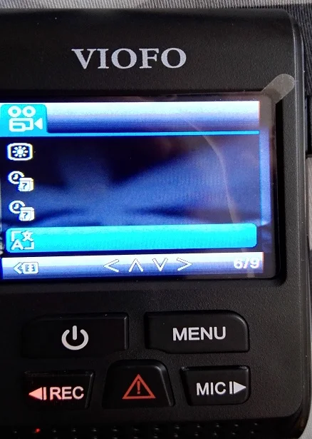

Today I installed the 6Vf.
When you change the language into German there are no fonts. Tested it 2 times and set all settings to default after update but nothing changed. The only fonts I got are in the resolution menu.
View attachment 42555View attachment 42556
Welcome to the Forum,
Thanks for the report. Testing all official v4.02 Beta with new Sharpness Level MENU setting for all languages now . . .
Results : official v4.02B = all language MENUs work including German
MOD-6Vf Stable = all language MENUs work except German !!! WHAT ???
Update: German Language restored, slightly lowered High 72 to 70, removed numerical sharpness values (only needed during Beta testing) currently Soft - Normal - Strong = 50 - 60 - 70

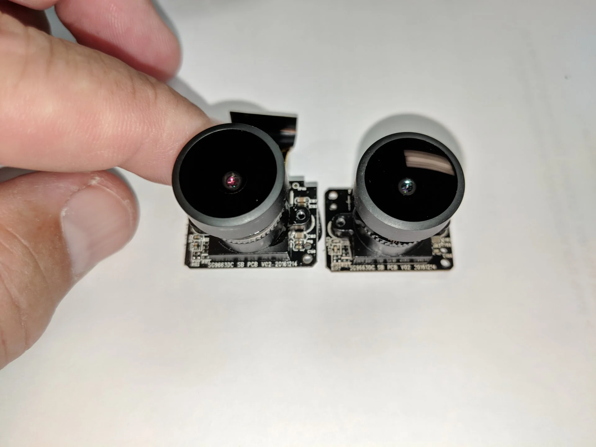

Got some new goodies today.
A new lens for my A119s with the bad lens. 😎
It appears to be different yet from the other lenses I have. 😱 Still need to collect footage with it though to know what differences there really are.
Lens on the right is the old "Bad" lens; the lens on the left is the "New"
Also got a couple new CPL filters in today they are the new design. Larger diameter lens but smaller housing.
Makes for a much tighter and better fit on the camera. 👍👍
Will post footage as soon as I am able to get some good sample footage collected.
Finally might be able to get some apples to apples comparisons going. It might be Green apples and Red apples but at least apples.
Also got another hardwire kit so this weekend I'll be running new wires in the collection vehicle.
Shout out to Viofo for a replacement lens.
View attachment 42596View attachment 42596

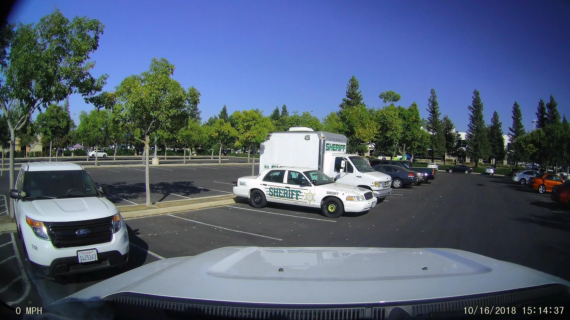

Here is the first video
https://www.dropbox.com/s/jv90n16gm...dge138+Hue138+Sat36+Audio22+DCTEAM_101618-New Lens.MP4?dl=0

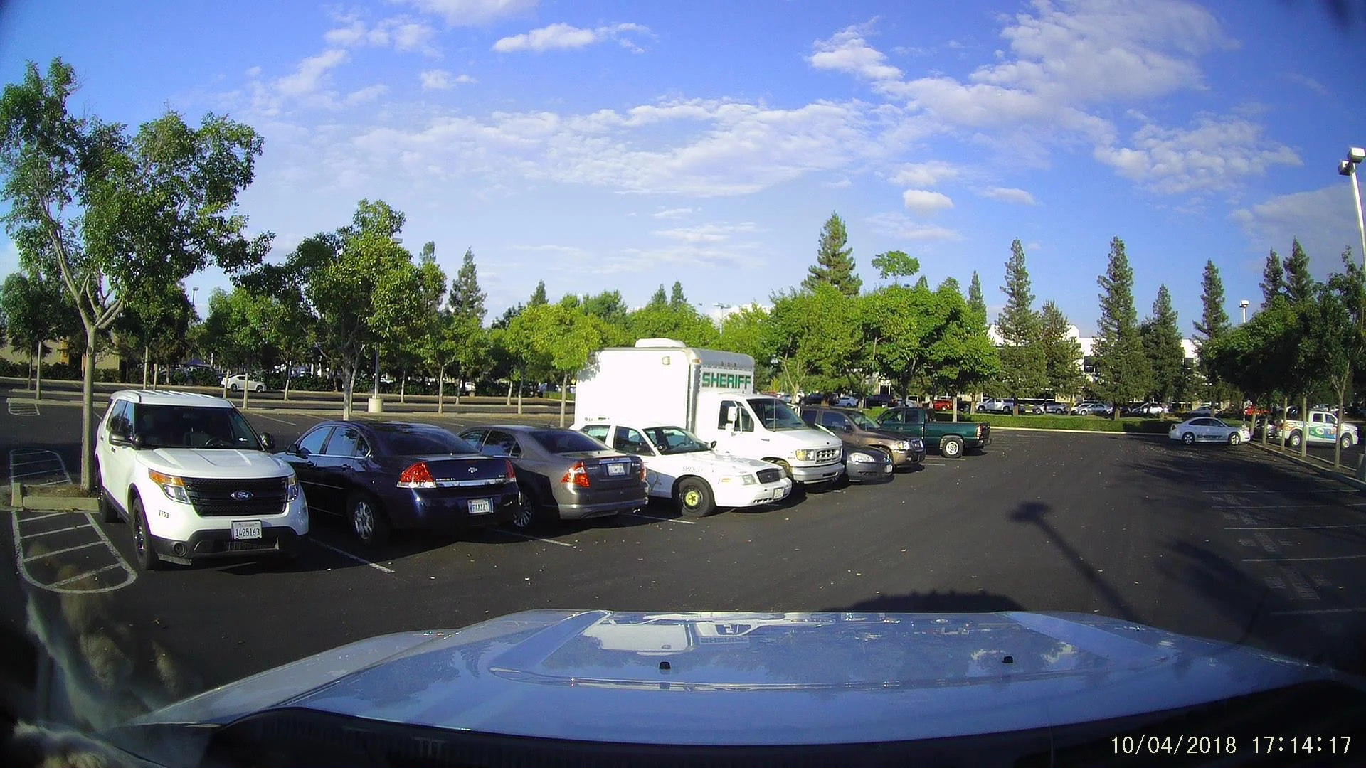

Here is a photo comparison as well
New Lens
View attachment 42593Old Lens
Now to update to the latest firmware
Great improvement using replacement Lens, your original Len focus should never have been sold in that condition.
The new Stable MOD-6Vf should increase fine detail. Request short clips in parking lot and highway using Sharpness Normal60 & High70.
