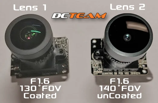

Got some new goodies today.
A new lens for my A119s with the bad lens. :cool:
It appears to be different yet from the other lenses I have. :eek: Still need to collect footage with it though to know what differences there really are.
Lens on the right is the old "Bad" lens; the lens on the left is the "New"
The "New" lens looks like a V2 lens, but with a metal holder instead. Maybe a new 'V4' lens?

The A119S has gone through more Lens & Holder changes than all other models. The DCTeam is testing all the Lenses to determine best focus (center & edge), brightness, color, field of view.
These replacement Lenses are both F1.6 one with anti-reflection coating the other brighter without, held by the improved metal base which the A129 started using to eliminate high temperature focus drift/shift.
For DCTeam reference suggest using Lens1 & Lens2 ID. The actual horizontal field of view on Lens1 = 97-100 degrees.
