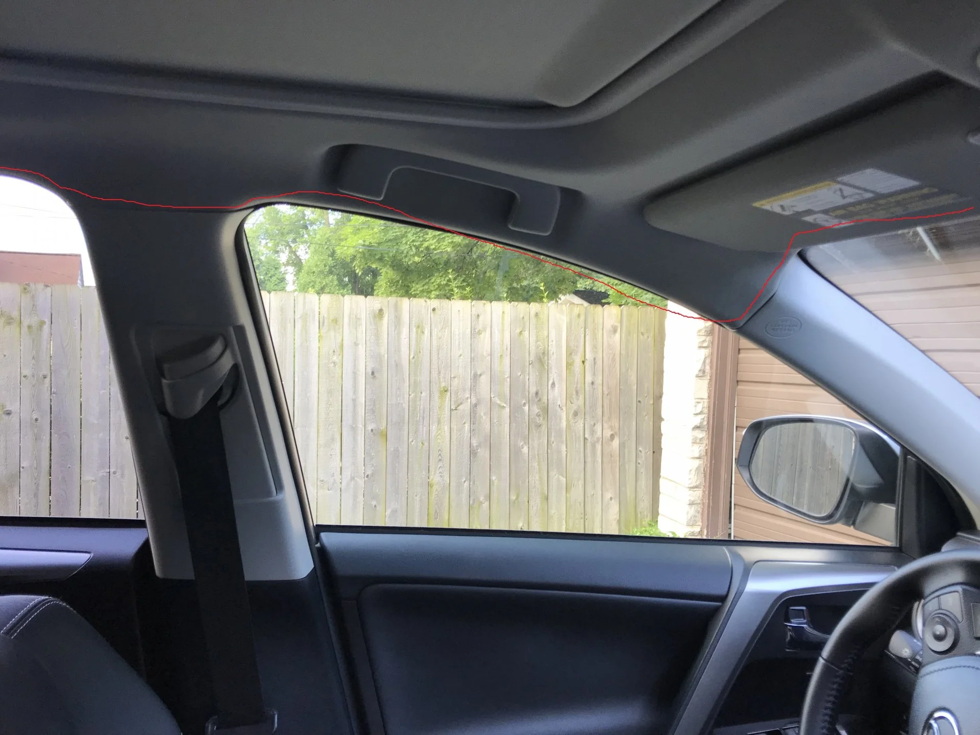

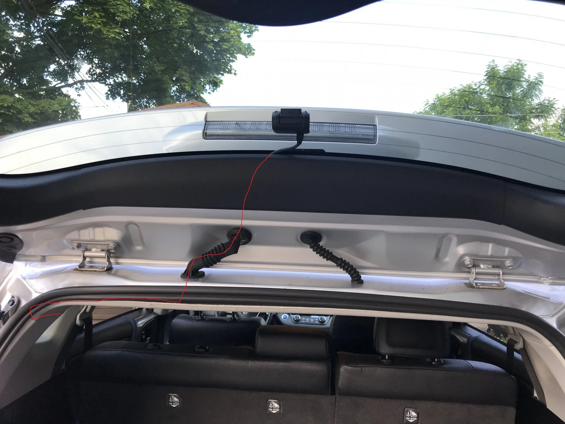

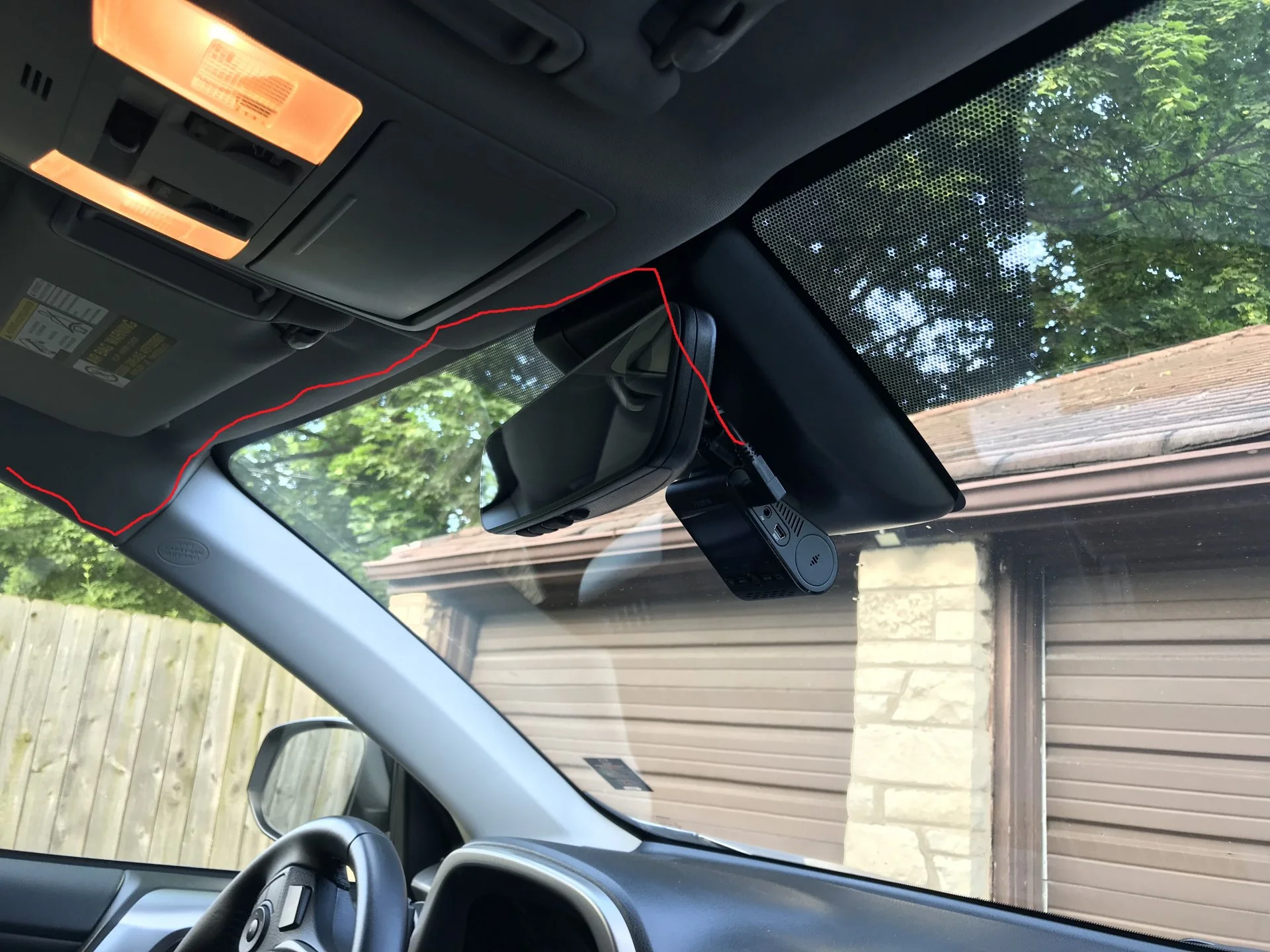

Just for reference on my Rav4. I was able to run mine along the top of the weather stripping in the doors and where the upper and lower trim pieces meet. I poked the cable in with the included plastic pry bar. The only trim pieces I had to remove were the a pillar and the one on the rear hatch. I had to pull down the rear headliner clips as well.

^ Basically the exact same way I ran it in my Escalade ESV. I was worried about the length but I ended up with about an extra foot of cable and overall, the run was easier than expected.

How difficult was it to run the cable through the weather proof tunnel in the hatch? I cannot figure out how to get the wire up through there
If it is going at the top of the hatch then there is really no need to follow the car wiring, just go from the headliner with a bit of a loop that can open up to allow the hatch to open, or go diagonally so that the cable just twists slightly as the hatch opens.
