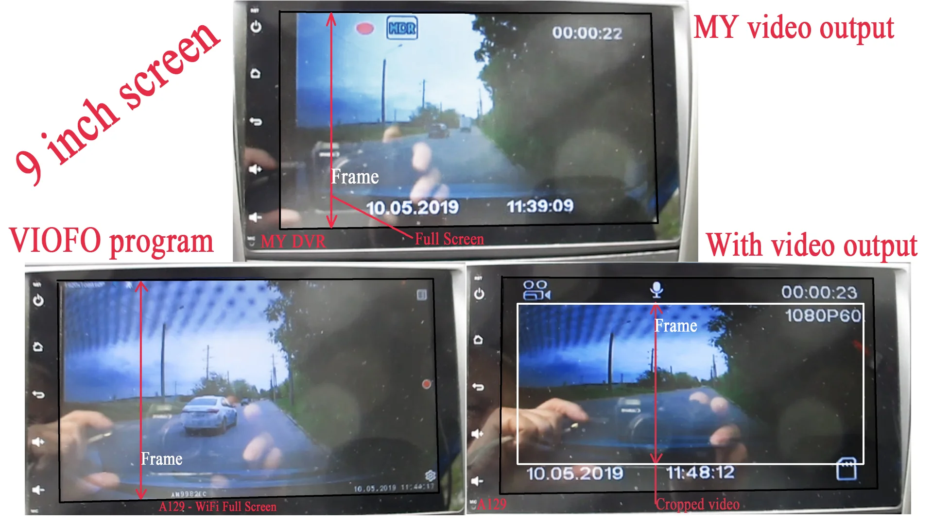

I do not like how A129 works on AV output.
This is how my auto monitor shows.
The A129 AV-out port is only 640x480 resolution and is not 16:9 format so is cropped on most external monitors.
Yes, according to the JNovatekDec.jar program, there is such a mode there, but according to it there is such a mode in my working DVR, however everything is ok there !!
set the external monitor to 640x480 resolution manually, it usually puts black bars on both sides.
