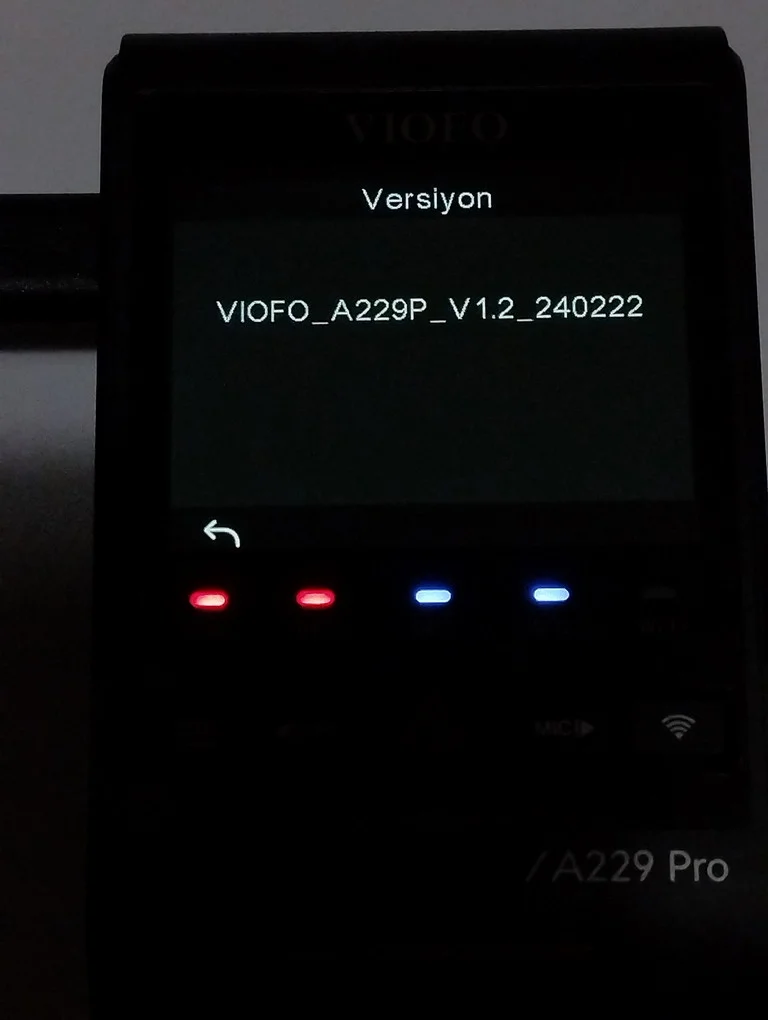

I just purchased and installed my first dash cam, the Viofo A229 pro last Friday and it’s been great so far. I just installed the firmware 231208;231207 but the Viofo app now shows max resolution of 1944p24 + 1944p24 there is no option of 2160P30 + 1440P30? The dash cam screen and in the dash cam resolution settings it does show 2160P30 + 1440P30. Is it a bug?
Rear camera video rotation issue
This bug is fixed in the latest version. https://drive.google.com/drive/folders/1M0MJ7kOMNJxpDY9vUi04gJ-jDbdRAuwz?usp=sharing The FWA229P is for the A229 Pro front cam, and the FWA229S is for the A229 Plus front. The EthcamTxFW.bin is for the rear cam.
