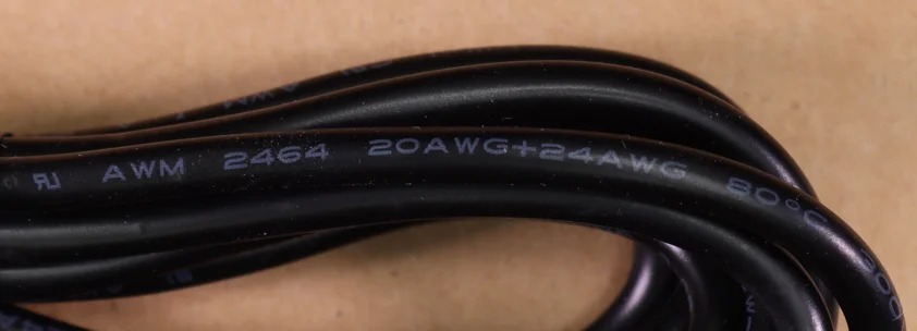

Hi, could anyone kindly confirm if this is the newer hk4? This is the picture provided by online retailer from China and they claimed it’s the new one. Not sure how true is it but I do not wish to end up with something else.
Thanks a bunch.

No that is not a picture of the optimized HK4. In the picture you provided, it has only one wire gauge listed of "24AWG" and that is what the older versions showed on the USB cable insulation. The optimized HK4 will have "20AWG+24AWG" on the USB cable insulation.
Zoomed In Pic You Provided
Optimized HK4
Optimized HK4
Thanks for confirming! Guess I won’t proceed with the purchase then.
