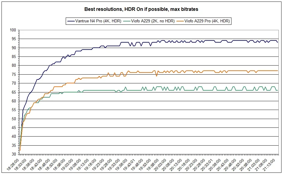

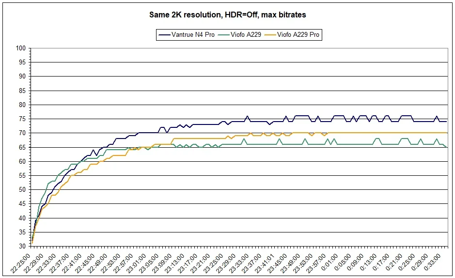

I'm planning to test my 3 dashcams - A229Duo, A229Pro and Vantrue N4Pro on same video quality settings with my thermal monitoring mod firmwares and post temperature charts.
Compare 3 dashcams at my apartment's window. Only front camera comparison test, without GPS modules. Vantrue N4 Pro cabin camera and IR lights was OFF. XLS file with thermal log data is attached.

Is that all in Celsius? Guessing apartment is at Ambient room temperature of 23C?
Yes, it is in Celsius of course. In apartment was around 21-24 C at this time.
Sorry didn't see that on the axes, nice work. Interesting to see the thermal management differences between the Viofo and Vantrue is quite stark. Good to get a baseline and I can only imagine a three-camera setup is going to have the temperatures go thru the roof.
I should add Celsius label for Y-axis.
Can't made long 3-CH comparison test at home at same conditions because Vantrue N4Pro GPS module is mounted on car windshield and w/o them I can't powerup dashcam in 3-CH configuration. But I'll made approx. 1-hour test comparison at my car with Vantrue N4Pro 3-CH vs Viofo A229Pro 3-CH in near future.

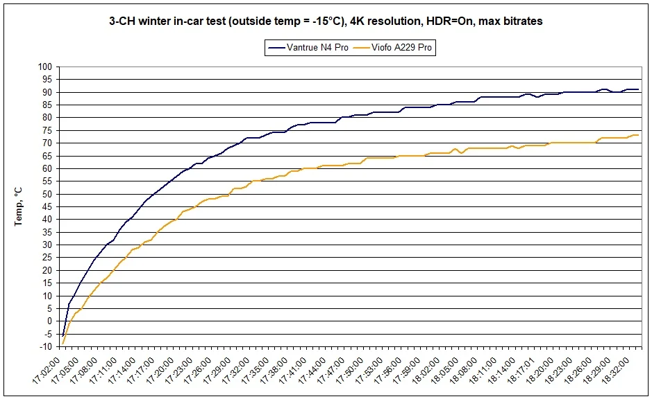

3-channel config temperature test. In-car installation, winter time, outside temp is -15C. Before test is started both dashcams was installed in car and was there 4 hours in powered off state. A229Pro has a bit less temp in start time (-9C for A229Pro and -6C for Vantrue N4Pro). In test time car engine was running and cabin heater was turn on too. Updated XLS with all temp values is also attached.

Not too bad those temps but can understand why it would get quite hot here in Australia and the temperatures recorded with the two dashcams..
