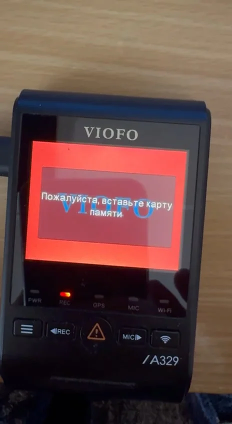

In firmware A329_V1.1_250923_WiFi, the file numbering is incorrect and doesn't depend on the drive!!
It's not critical, but it's very inconvenient!
I tried this firmware, and there are no errors in the video file names, everything is perfect!
The video quality is excellent, it holds the exposure and sun/shadow perfectly.
There's only a USB error, but it's not a big deal for me, since I use an SSD drive!
