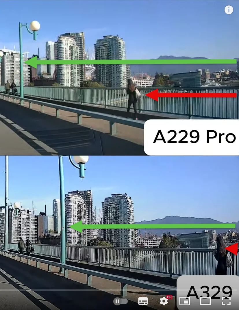

Which is the greater FOV?
Credit @safedrivesolutions
They are about the same, you need to compare the backgrounds, not the foreground objects, things in the foreground have parallax errors due to the different lens positions. There is also a fisheye effect that means you can't compare the distances in different parts of the image accurately.

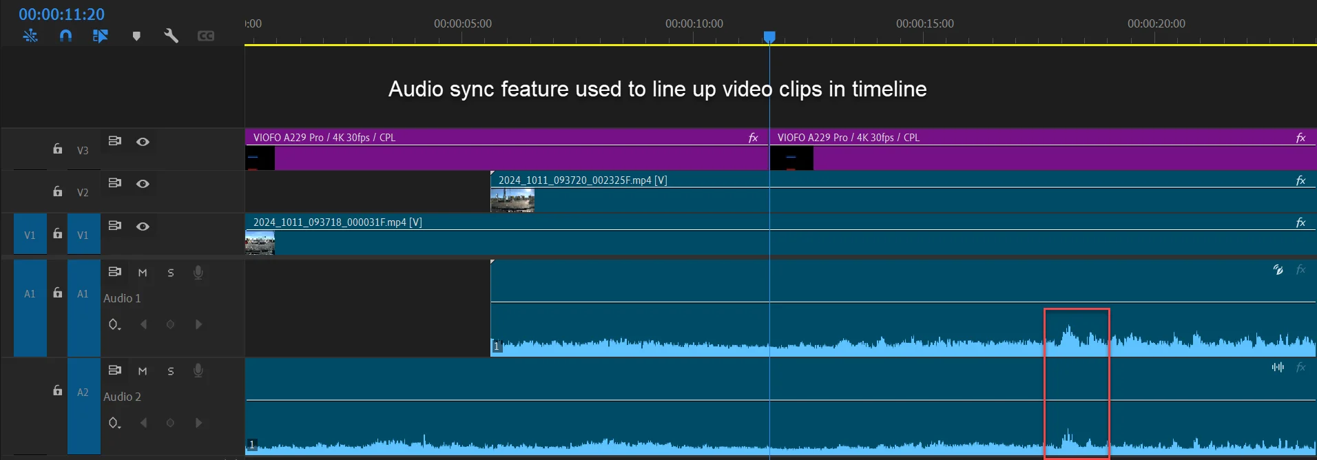

The challenge when using multiple video clips in the same video editor timeline is how to get them into sync with each other. Most all video editors provide a tool to synchronize the video clips within the timeline based on the audio contents. That is a great time saving tool to help the video editor get the video "close" to being synced.
Why do I say close to being synced? What I've found is that each dash camera model has a slight variance in how it combines the video track and audio track into the output video file. One would assume the video and audio are always in sync with each other in any given video file and for the most part that is somewhat true. Each dash camera make/model/firmware has some amount of variance from being absolutely in sync (video & audio) on a frame-by-frame basis. Most are very close to be 100% in sync, but there can be one (1) to several frames of an offset between the video and audio depending again on the model/model/firmware of the dash camera.

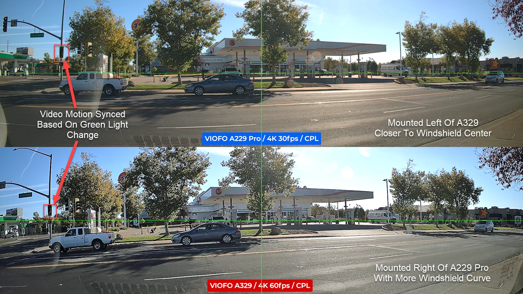

There are left-to-right and windshield curvature factors that impact what shows up on the left/right edges of the video. The assumption is that the up/down alignment is as close the to same as possible as well to minimize that factor in determining what shows up in the video.
Here's an example of frame grab from an A229 Pro front camera video and an A329 front video with my vehicle being motionless. I used the Adobe Premiere Pro feature to sync the audio track contents. I've added the green lines to show where the center positions for each video content is located. There are a couple of objects that I'll point out in this comparison. The four position vertical stoplight on the left side of the video can be seen in the A229 Pro video, but that stoplight cannot be seen in the A329 video footage. There are two possible things causing that to be true and those are the fact that the A329 is mounted about 6 inches to the right of the A229 Pro front camera on the windshield and/or the A229 Pro front might have slightly wider viewing angle. The only way to be sure would be to mount them both in the same position on the windshield and compare. That's what @Panzer Platform is doing with his test.
You can see the audio track contents are "in sync" at this point in time.

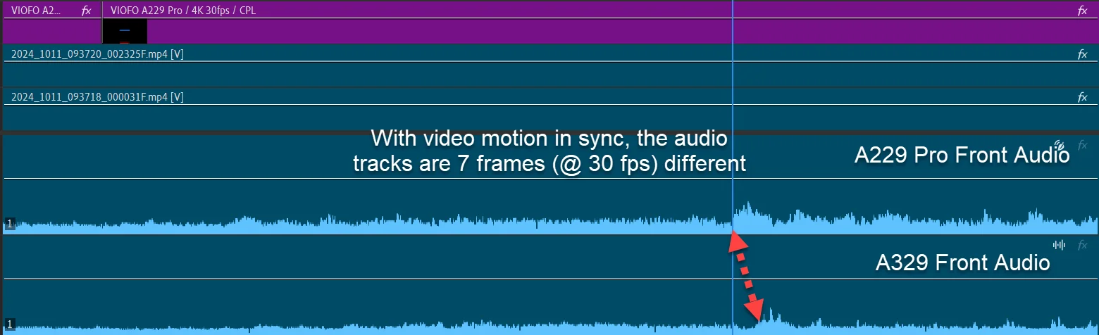

When I combine video footage from two or more cameras in the same video editing timeline, I use the audio sync feature to get them 99.5% in sync. I then look for visual clues to allow me to adjust the placement of the videos in the video editor timeline to make the visual content become synchronized. I look for stoplights changing, vehicle turn signal(s) turning on/off or any shadows that are cast on the vehicle's window glass to know if they're in sync already or how may frames they need to be adjusted to get the video contents in sync.
Using these same two sample videos, I found the video frame that contains the stoplight changing from red-to-green and I used that to sync the videos in the timeline. The crosshair in the A229 Pro front camera footage is somewhat to the left of the tree in the lot across the street. The same center crosshair is directly in the middle of the tree trunk. That shifting is from the left-to-right placement on the windshield. Comparing the placement of the grey car, the same shifting is present due to the camera position on the windshield, but the alignment of the grey car to the white pickup truck is more synced since the video events are in sync. The same can be said for the white minivan's placement relative to the Carl's Jr sign it's located under in the footage.
With the video motion in sync (stoplight changing to green), you can see the audio tracks are now out of sync. The audio tracks are seven (7) frames out of sync. That's why when I have multiple video files in the same video editor timeline, I have to sync them using a two phase approach. First use the audio syncing tool in the video editor and then look for visual clues to sync the video motion events.

Great explanation.
If I'm trying to do a visual comparison I slide the videos so an object is in the same place in both videos.
Often I'll use the white line on the road.
So after all that explanation do you know what the fov is for the A329?
Is it wider or narrower? From @safedrivesolutions video i used previously it looks narrower which i think works better.

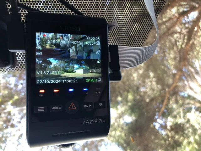

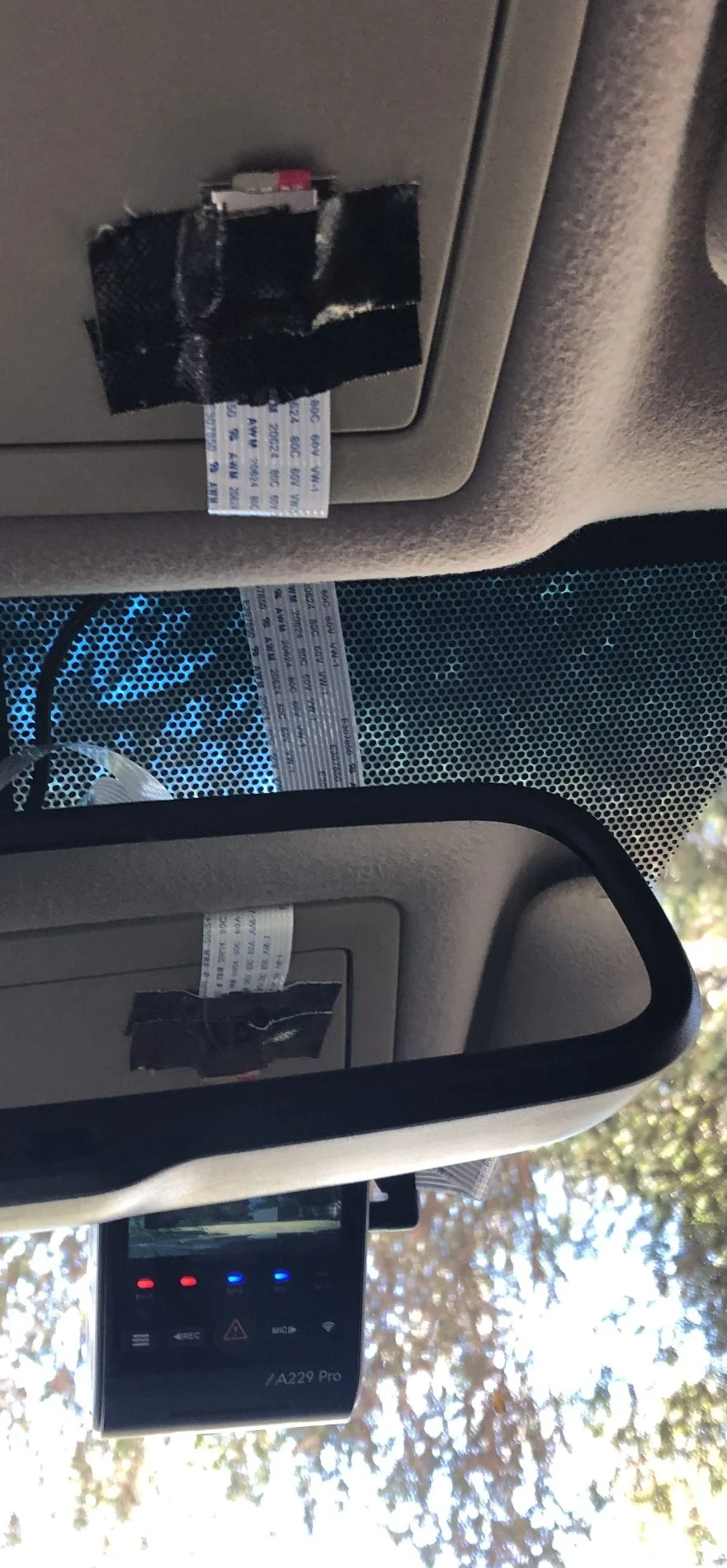

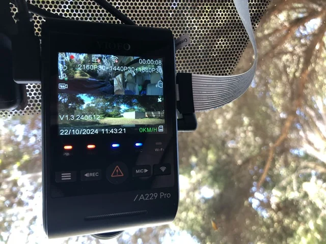

I thought he was talking about using this to remove heat from the dashcam micro sdcard.
I've tested this and it does work but I haven't tested it long in the field.
I was just curious if it might work.
The flat cable I'm using is too long for permanent use. Reports slow card.
But it is an option.
So keep in mind these products are mounted next to each other but the A229 Pro is about 3 or 3 inches over from other lens so it will look wider. Now according to @rcg530 he thinks there is a possibility it could be out because he says the music may not be in same frame. So I will have to double check that.
This is a very interesting question.
What is the benefit of using such a device?
Is it to prevent the SD Card from being baked to 1000F degrees in the camera? lol
View attachment 74598View attachment 74599
Remote SSD provides:
1. Stealth and evidence preservation in case of break-ins and vandalism
2. High capacity up to 4TB
3. Helps to reduce the heating of the main unit
However the SSD with its relatively high power consumption is not quite suitable for parking
Remote SD/microSD card reader - hopefully fixes the power consumption issue, similar to integrated microSD card (to be tested and verified)
