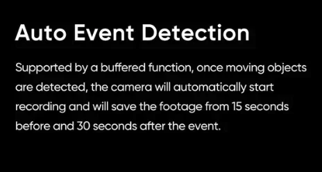

Auto Event Detection
Pros
Avoids recording when nothing is moving
Full frame rate, sharp capture of fast moving objects.
Files short 45 seconds
Cons
Might miss some events
Video is completely black in poorly lit areas
Best when always parked in lit streets or garages and not needing to watch continuously, mainly looking out for collisions
