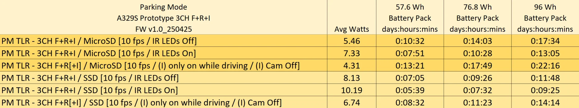

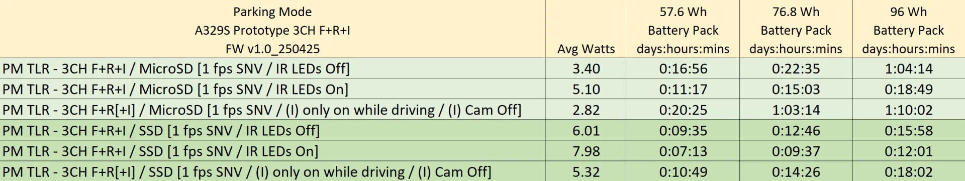

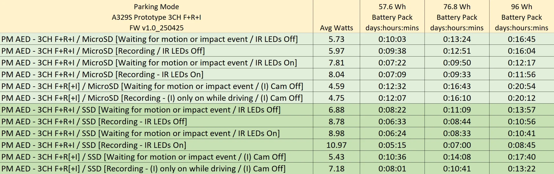

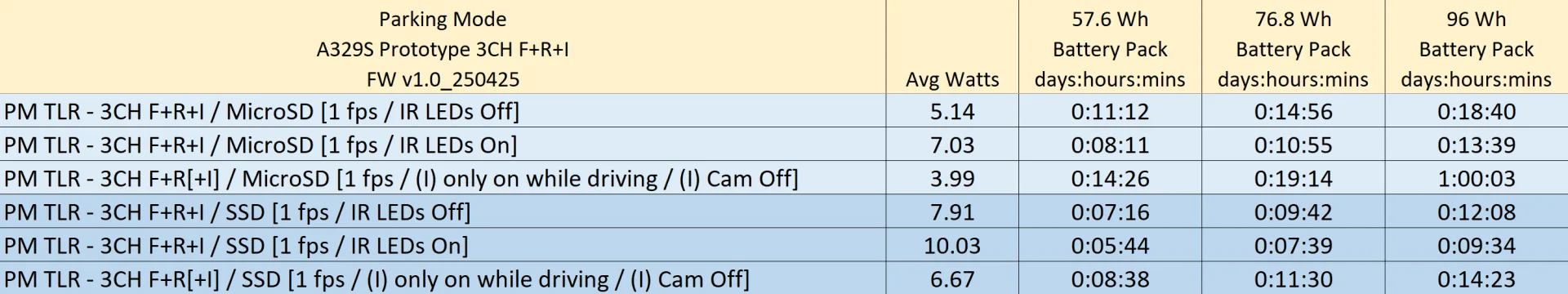

During my testing of the A329S 3-Channel prototype dash camera, I performed a series of parking mode power consumption tests. Recently, I asked VIOFO is there was any parking mode that would have a significant change in its power consumption based on the firmware version or the production hardwire. VIOFO stated there should be no notable differences in the parking mode power consumption with the production firmware / hardware.

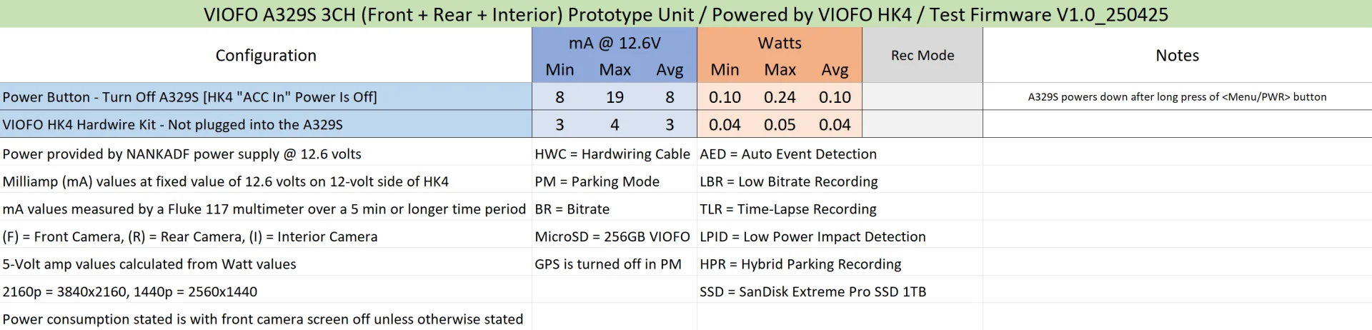

The power consumption data was gathered using a Fluke 117 multimeter measuring the amp draw with 12.6 volts being provided to the input power wires of a VIOFO HK4 hardwire kit. The Fluke 117 gathered mA values [min/max/avg] values were input into a spreadsheet with the average mA value being used to calculate the "Avg Watts" you see in these charts. Each parking mode/config option combination is run for a minimum of 5-minutes.
The time estimates are based on the simplifying assumption that the full battery pack capacity is available for use to the HK4 and the dash camera. The HK4's low voltage cutoff feature will turn off the power to the dash camera before the battery pack's full charge capacity has been consumed. In my previous tests of the VIOFO HK4 hardwire kit prototype unit with a way to turn off the low voltage cutoff feature, it would extend the parking mode run time in the 30 to 45 minute range. My parking mode time estimates are a bit overly optimistic, but are usable to get a general idea of how long a parking mode might function with each battery pack capacity listed in the chart.
No hybrid parking mode time estimates were calculated since hybrid parking mode is a combination of two parking modes that already have time estimates [AED+LPID, TLR 1FPS+LPID, LBR+LPID]. The main variable being how long you select to have the primary parking mode enabled [using the Cut-off Timer].
LPID = Low Power Impact Detection
Since LPID parking mode only writes videos to the microSD card, I only tested having a microSD card in the front camera with no SSD connected. If there's enough interest, I can run additional tests with a microSD card and a SSD drive connected.
AED = Auto Event Detection
TLR 10FPS = Time-Lapse 10FPS
TLR 1FPS - Time-Lapse 1FPS
TLR SNV 1FPS = Time-Lapse Super Night Vision 1FPS
LBR = Low Bitrate

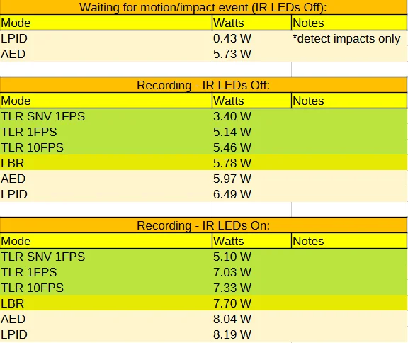

If it is okay for you, let me rearrange your tables a bit.
Everything below is for A329S in ParkingMode, 3CH F+R+I, MicroSD, FW v1.0_250425:
Modes is grouped by: not 30 FPS, not normal bitrate, 30FPS+good bitrate and arranged from most to less effective in Watts.
LPID is really good in waiting (due turn off all image sensors) but surprisingly worse on recording than AED. Can`t understand any reason for diff watts while recording between LPID and AED.
Presumably this testing was done with HDR On?
I don't want to make you repeat every test with HDR Off, since it probably has the same amount of effect on most of the tests, but it might be interesting to know how much effect it has on the first test of the "LBR = Low Bitrate" and first test of the "TLR SNV 1FPS = Time-Lapse Super Night Vision 1FPS" tables...
Also, when available, we need to know the difference between HK4 and HK6 power consumption. Hopefully very little, but you don't run a radio transceiver at zero power...
I'm not sure there is a difference?
The variation between LEDs On and LEDs Off is significantly larger across all the tests, than the difference between LPID and AED both with LEDs On, so it appears to me that there is either some measurement error, or there is variation in power draw due to something else, such as the memory card doing housekeeping during some of the tests but not others. I suspect it is not measurement error, rcg530 knows what he is doing and has good measurement equipment.
Might be interesting to repeat a few of the tests and find out what the variation is. I suspect the LEDs ON/LEDs Off tables could be simplified into simply saying that the LEDs On takes an additional 1.7 Watts for all tests, and removing half the tables. There is one cases in the tables where it is +2.07 Watts, but I don't see why the LEDs would take more power during AED than in LPID recording, it doesn't correspond to total power draw so it is not that the LEDs are dimming under load.
@Nigel I suppose that AED and LPID should not have any differences when recording a video. Cause it doing same job - record a video files from 3 channels with same quality settings + check g-sensor + try to recognize a voice commands probably (if it is was not turn off to negate ambient sounds). Of course here can be some fluctuations but 0.50 Watts when IR LEDs is Off is too much for it.
Of course then it is in waiting state - it have different consume of current.

Just curious, have you done any power consumption tests with multiplex enabled? I wonder if 3CH multiplex consumes any more or less power than recoding 3 separate video streams?

I have not performed any multiplexed video parking mode power consumption tests. Adding the 2ch/3ch multiplex operational modes to the normal recording / parking recording power consumption test suite would have taken a lot more time. I do find the multiplex video offering an interesting one, I'm just not sure how many actual users will be using it. The next time I pull the dash cameras from my car, I'll see if I can run some multiplex video power consumption tests. I just don't know when that will be.
I will be testing the HK6 hardwire kit and its impact on the total power consumption levels [normal mode and parking mode]. I don't have one to test. I hope to get one "soon". I stepped through each cell in my main data collection spreadsheet and the parking mode spreadsheet that pulls data from the main spreadsheet to confirm that I'm pulling/reporting the correct values for each parking mode. There's a lot of copying/pasting of cell formulas while I create these spreadsheets, so I just wanted to make sure I didn't have an incorrect value being reported.
Here's the section of my main spreadsheet showing the HK4 power info and my footnotes. The "5 min or longer" statement does need to be clarified a bit. Various parking modes will have limited time frames when the dash camera is recording video. I "trigger" a parking mode event [motion or impact] to have it start recording. After about 5 seconds of recording, I have my Fluke 117 multimeter start to gather min/max/avg amp readings. Before the recordings stop for that event, I quickly gather the min/max/avg values. I let the dash camera return to its "waiting for triggering event state" for at least two minutes before I trigger another event. I usually trigger three events for each parking mode type so I can get a decent idea of how much power the dash camera consumes in that parking mode while recording.

HDR requires the camera to take 2 images at different exposures and combine them into one. If you choose Time Lapse you have the option of longer exposure but then does HDR even running?
Looking back that the footage captured during my test runs, the parking mode HDR setting [which I believe defaults to on] was on. The SNV 1FPS footage does not have the "HDR" status line indicator so it appears to be recording with HDR off. In all of my previous dash camera tests [for any company], I've never found HDR on/off to make any notable difference in the power consumption amounts.
I was wondering if the reason that SNV 1FPS uses noticeably less power than 1FPS, is because it doesn't use HDR. HDR does collect twice as many exposures, and also does more processing, especially with the better HDR we are getting on newer dashcams. It might not make a big difference on the higher power recording modes, but on the lower power parking modes like 1FPS and Low Bitrate, it maybe more noticeable?
