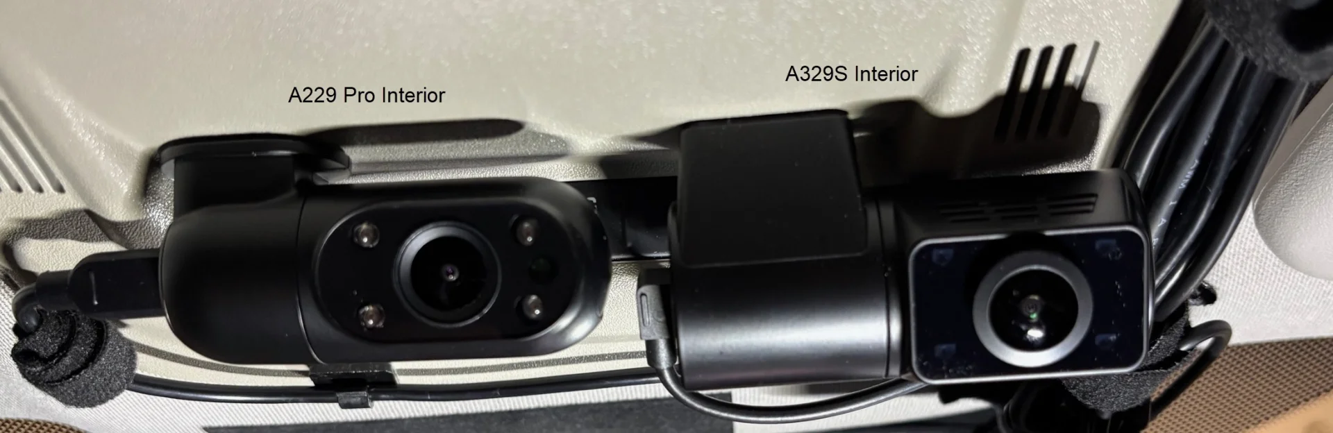

When you get a chance can you post a photo showing the location of the two IR Interior cameras, (how close they are to each other)?
It looks like you mounted them as close as possible to each other, I'm just curious I'd they are side by side, or on top of each other.
I have both of the interior cameras mounted side-by-side. Their mounting base fit into a recess just behind the passenger side seat belt warning indicator. The A229 Pro interior camera is aim a bit higher so that the upper limit to the field of view only includes a minimal amount of the vehicle's headliner. To achieve the same objective with the A329S interior camera, I had to aim it a bit lower due to the fish eye lens.
Getting nighttime footage from multiple interior cameras always adds to the amount of driving since you only want one camera's IR LEDs on at a time. Capturing nighttime footage with the IR LEDs on for both interior cameras produces a false over-illuminated image. If the car's engine remains "stable/reliable", I'll try to get some nighttime footage early next week.

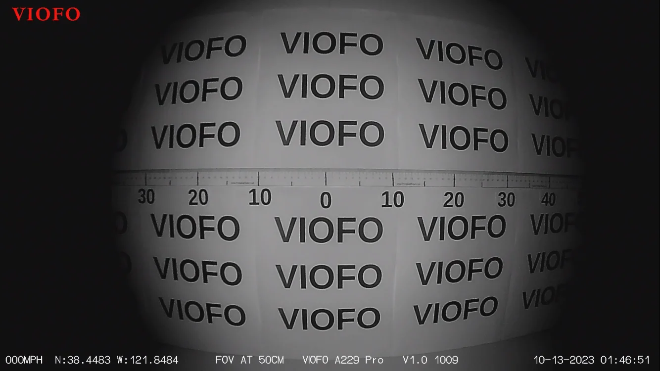

If you film some test footage with your car in your garage with all the lights off I'll pay for the gas. lol
I'd like to see how much FOV is lost in complete darkness when the IR LED's are illuminated like this;

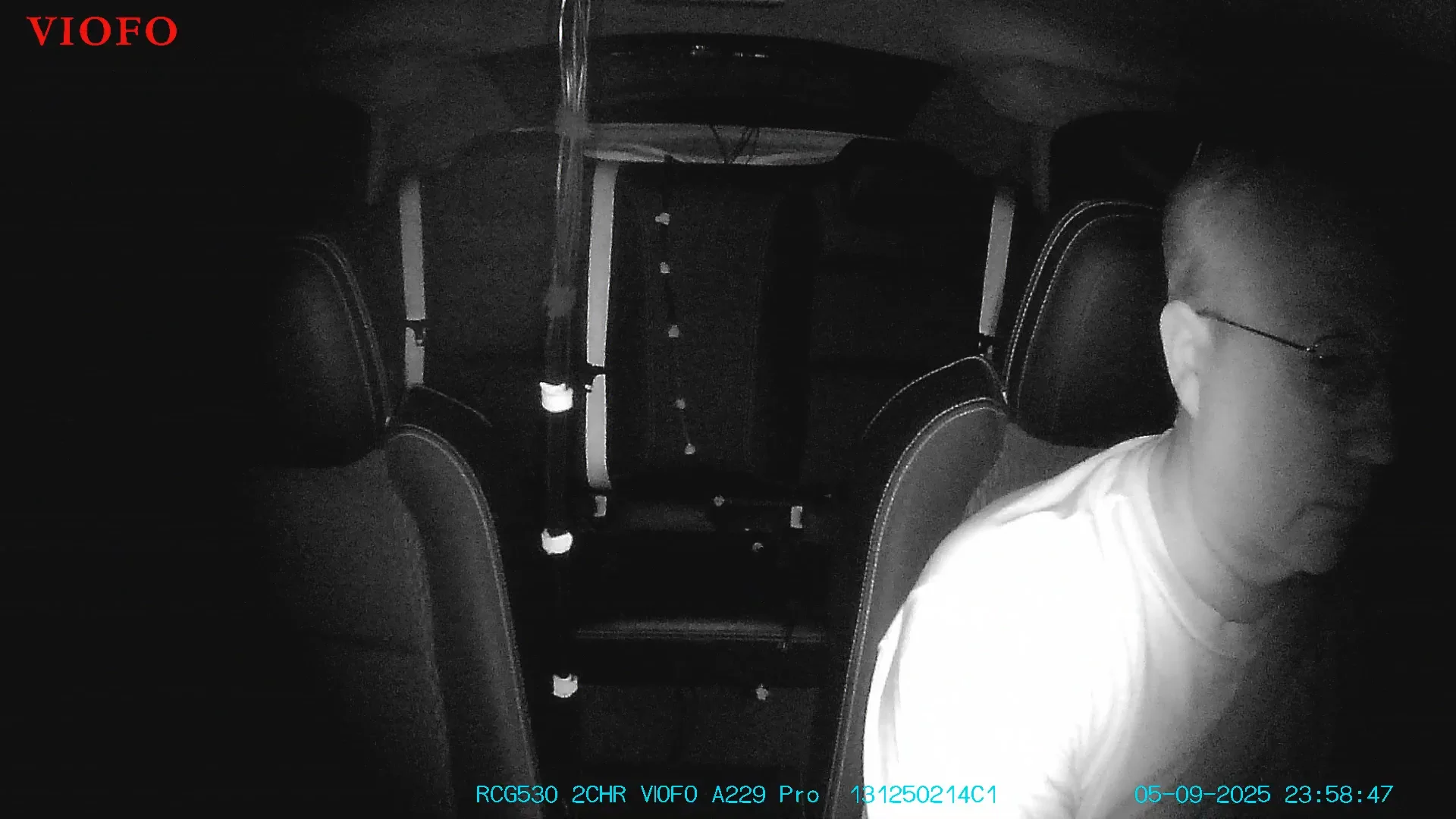

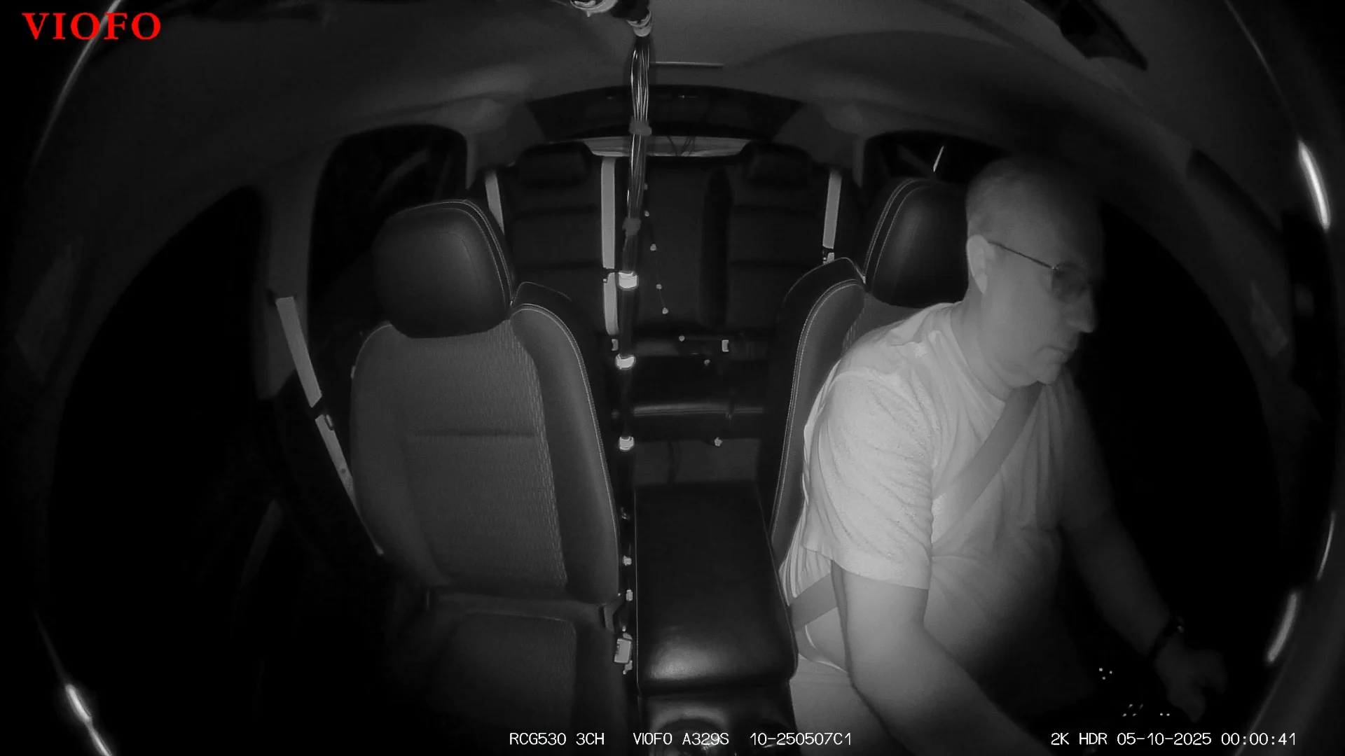

@Chuck McCoy here are two frame grabs from the A229 Pro 1080p interior camera and the A329S 1440p interior camera with HDR on. My car was in my "dark" garage. Still a few floating dust particles in the video, but I found some video frames that were "dust free". The A329S interior camera has the fish eye mode setting set to on.
viofo_a229_pro_night_2025_0509_235816_014309I.MP4_snapshot_00.30.webp viofo_a329s_night_2025_0510_000011_000377I.MP4_snapshot_00.30.webp
Wow, this is a huge improvement, (FOV / resolution).
Viofo should be very proud.
I wonder how long it will take to get IMX678 IR Interior cameras.
Also, thank you for wearing your seat belt. lol

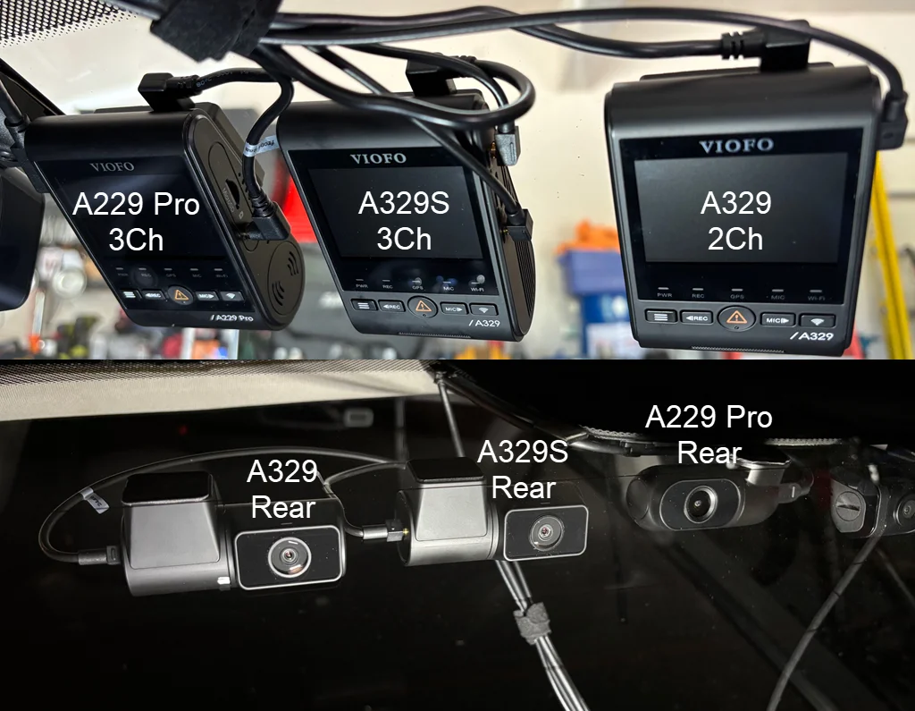

Yesterday, I installed the A329S 3-channel in my dash camera test car. I also have the A229 Pro 3-channel installed in that car.
Did you also re-install the A329 2-CH?
I’d like to know if the A329S 3-CH Front & Rear camera image quality has been improved, or stayed the same.

Appears to be not quite wide enough to capture the cop's face at the window?
Might do better if the camera was mounted a little further forward, so it will depend on the car, maybe in many cars, it would get the cop's face?
I just noticed everything out the rear windows is overexposed on the A329S.
The A229 Pro is not overexposed.
Can this be fixed with HDR / Lens Adjustment / Image Quality Improvement, etc?
That is the difference between HDR and no-HDR, that is why you almost always want HDR always on for the interior camera, which I hope is the default setting?
I'm working on getting the A329 2CH installed in that car [Caprice] as well. One of the battery packs I purchased a few years ago [Thinkware iVolt Mini] I had in the Caprice, pre-engine repair, was moved to another car [Highlander Hybrid]. That battery pack, in the other car, is now having charging problems. I working on solving the battery pack issue [even temporarily], so I can get an A329 2ch into the Caprice for testing with the A229 Pro 3Ch and A329S 3Ch.
The default setting for the HDR setting is "On" for all three cameras of the A329S.
I found my iVolt Mini battery pack charging problem was a charging cable problem. That means I can move it back to my main dash camera test car [Chevy Caprice PPV]. I now have a VIOFO A229 3ch, A329S 3ch, and an A329 2ch in one car.

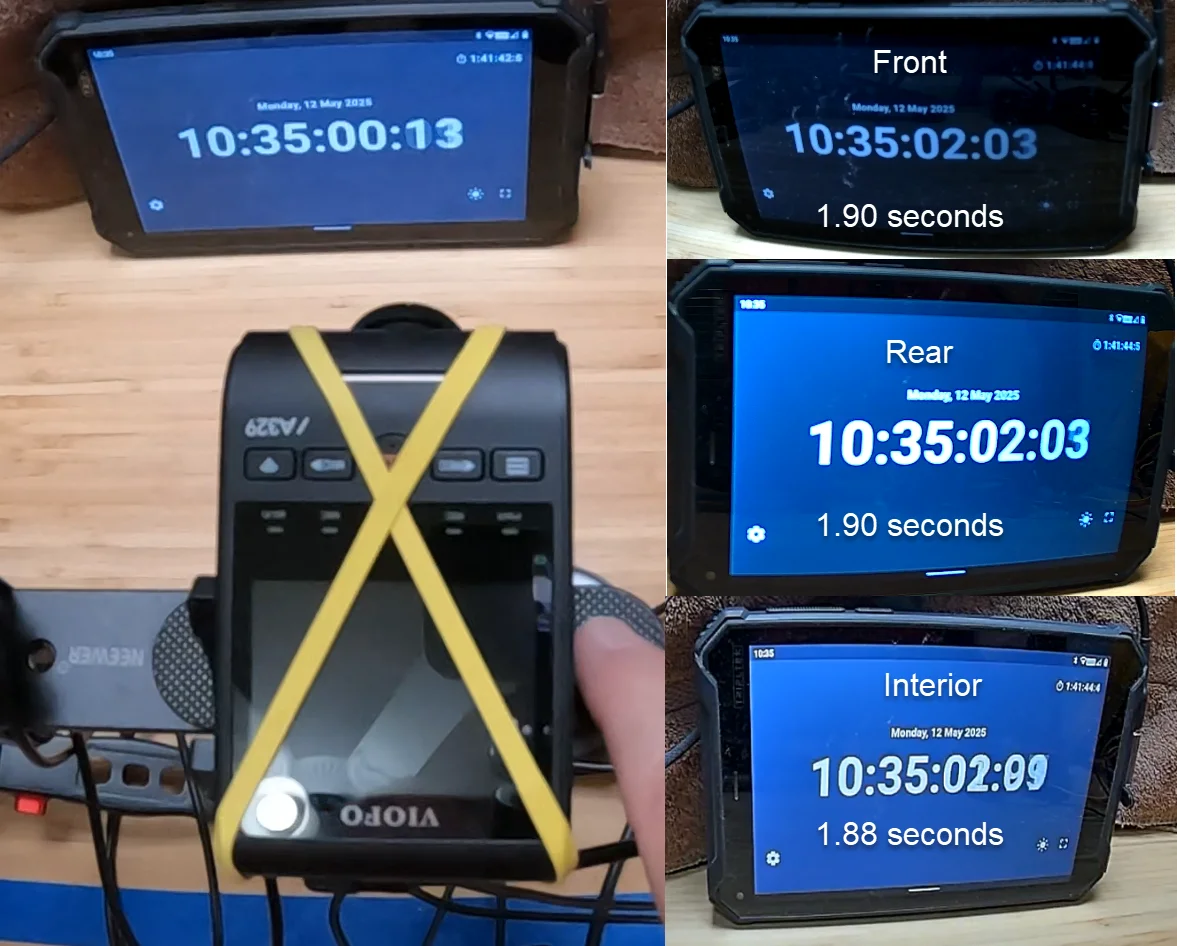

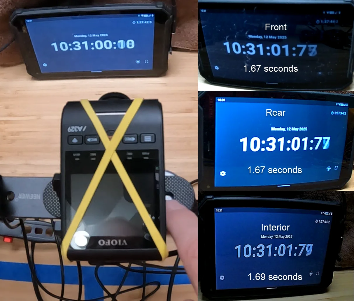

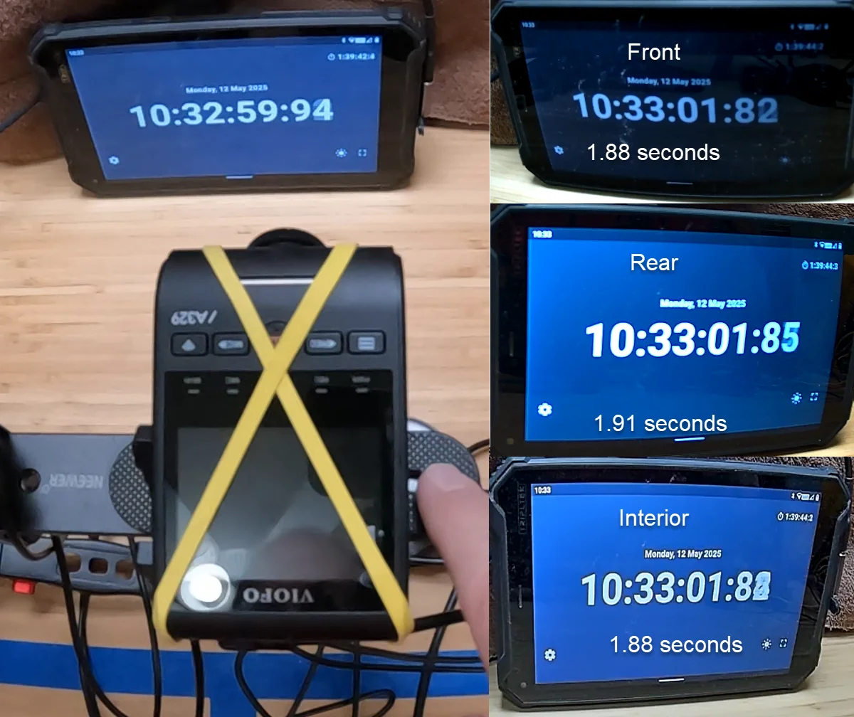

I received new test firmware from VIOFO that improves the response time to an impact event in LPID parking mode. I ran three tests with the test firmware using my pre-production A329S 3-channel configuration.
The impact event time to the first frame recorded times range from 1.67 seconds to 1.91 seconds across the three tests runs. A nice reduction in the response time to an impact event in LPID parking mode.
I wish there were a way to activate the parking mode with the bluetooth button. I have a Tesla, so no easily accessible ACC to tap for a trigger.
It would be great to tap a button to activate and deactivate parking mode.
View attachment 80181View attachment 80182View attachment 80183
Have you tested in a vehicle mounted to the windshield?
