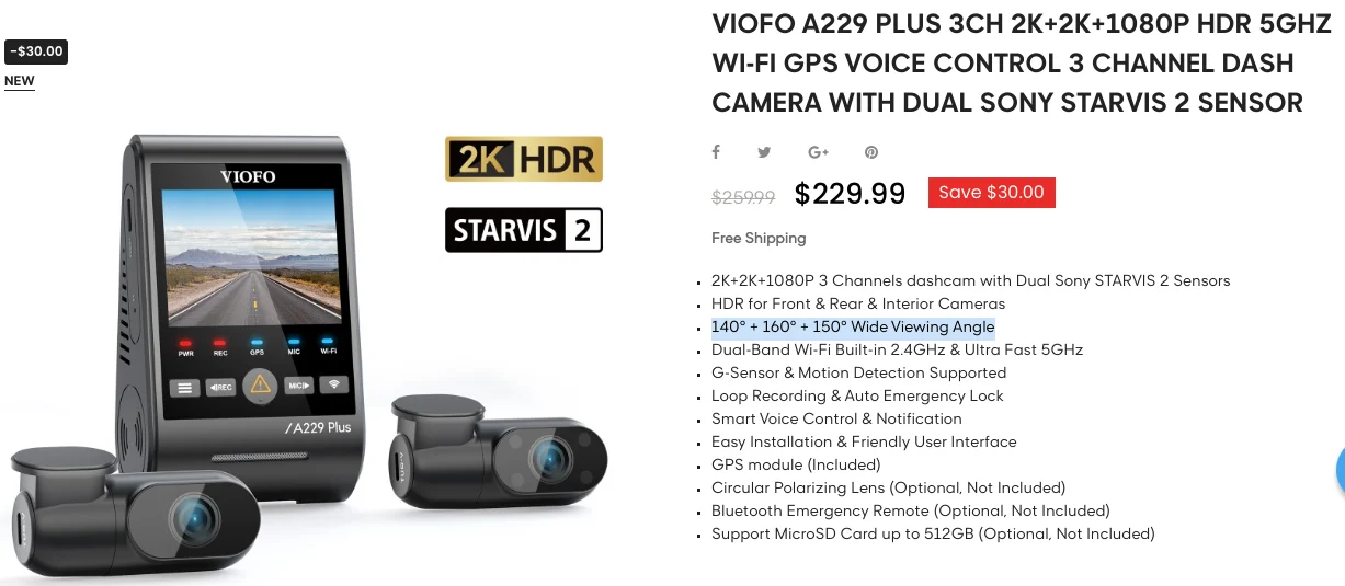

The A229 Pro & A229 Plus FRONT cameras have the same 140° “Wide Viewing Angle” specification.

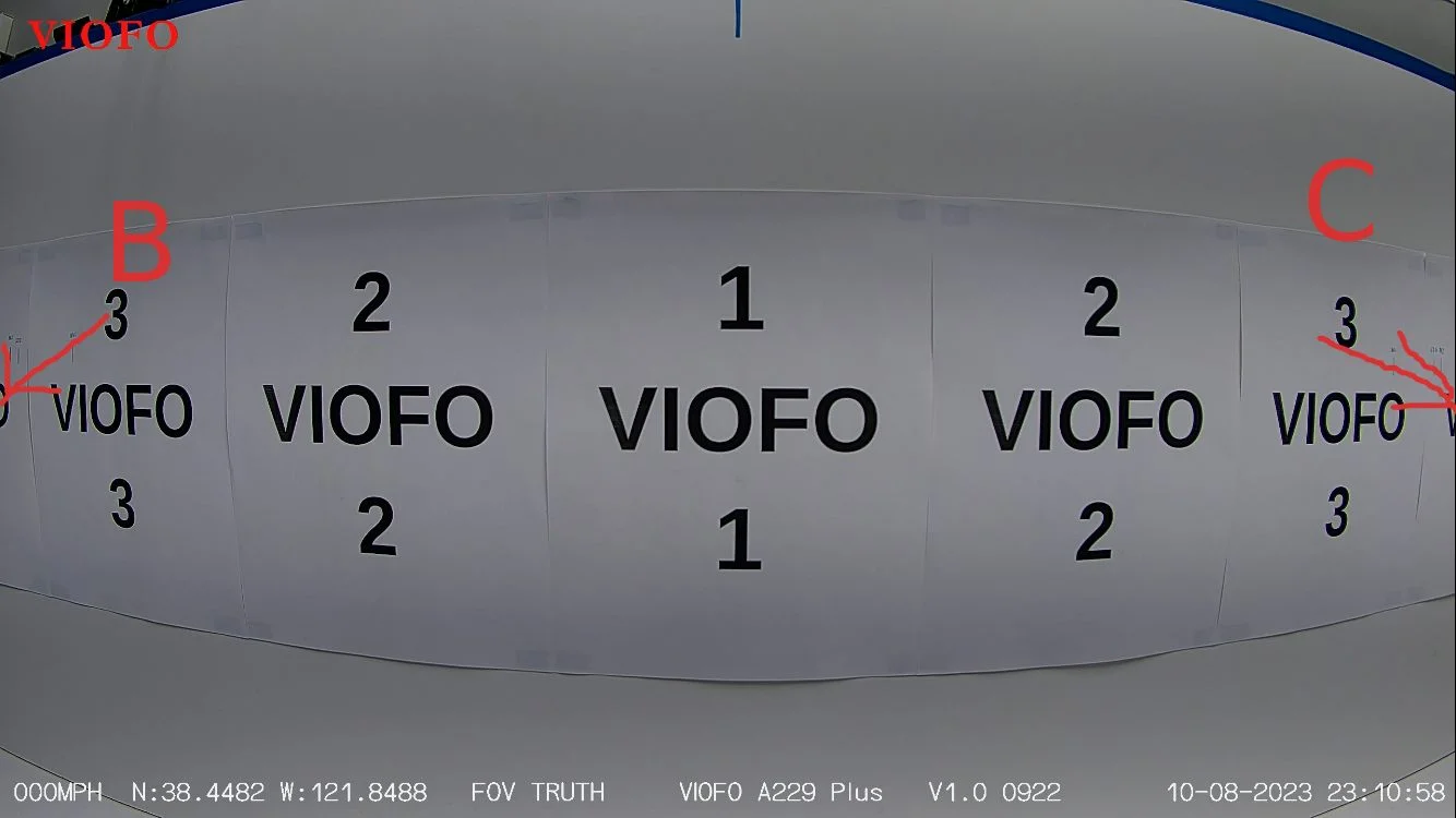

Since both FRONT cameras have the same 140° specification their recorded footage should appear identical if placed in the same location.

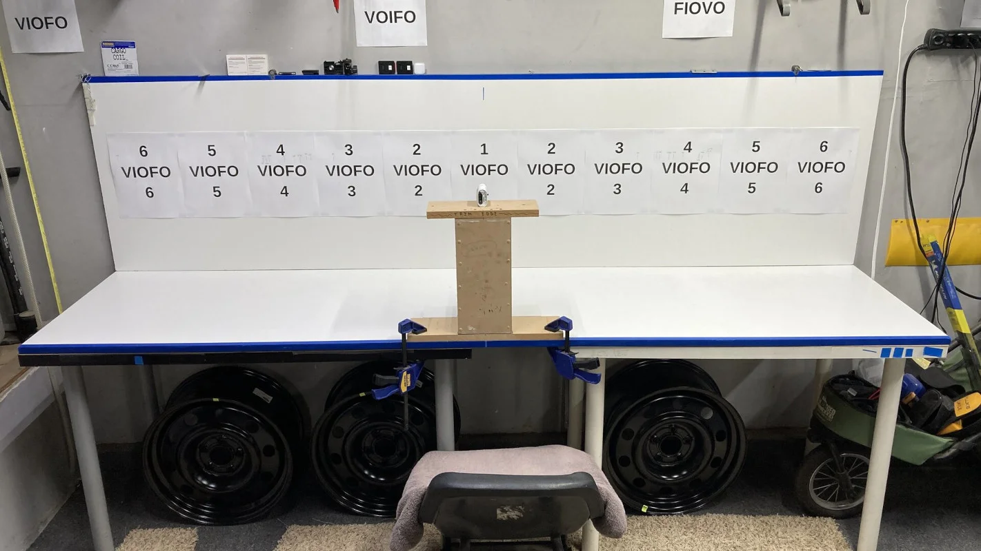

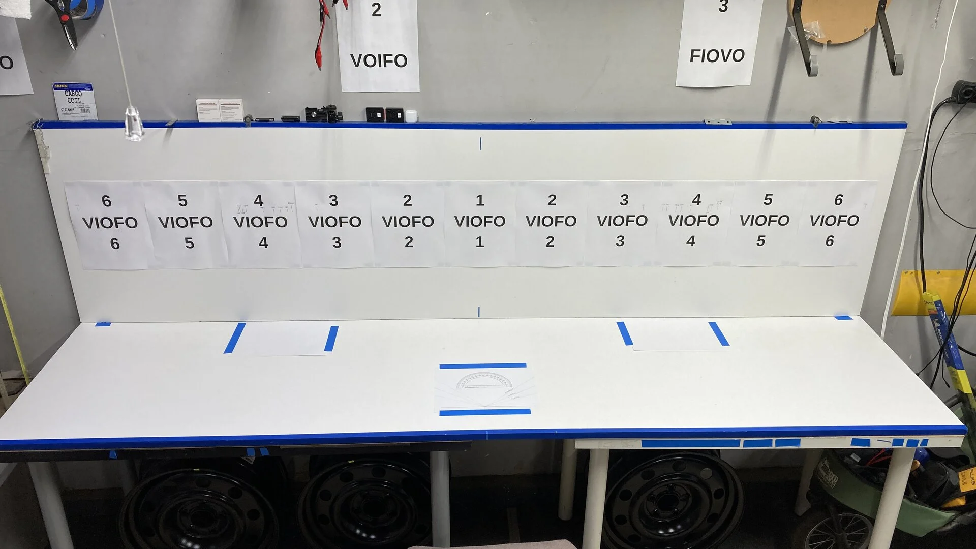

I needed an elevated platform, and something in the background so here’s what that looks like.

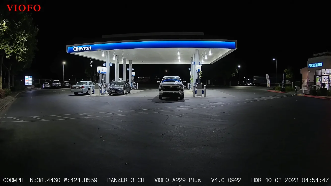

Looking at the two screenshots it appears the A229 Pro has a wider FOV.

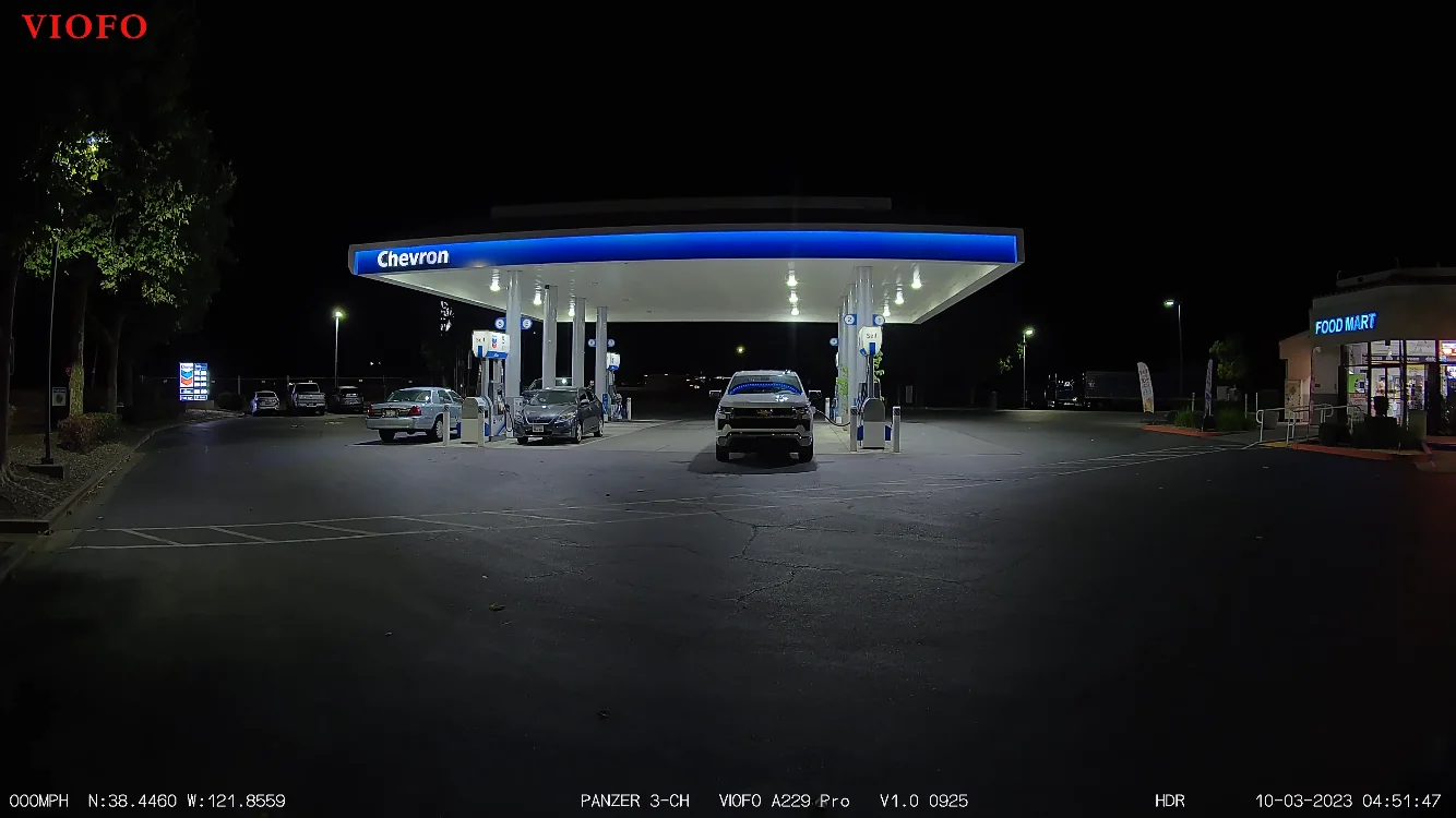

Q: Which one is 140°?
A: I don’t know.
Q: How much wider is the A229 Pro?
A: Based on Kentucky Windage my guess is 10°.
Q: Is this a big deal, does this really matter?
A: Any incorrect specification is false & misleading in the eyes of the consumer.

To find the AOV measure the three sides of a triangle and from there you can calculate all the angles of that triangle. Let's use your A229 plus image as an example.
With the camera set up on your test rig:
1 - Measure the distance from the center of the lens to point 'B' - this will be 'Line A'
2 - Measure the distance from the center of the lens to point 'C' - this will be 'Line B'
3 - Measure the distance from point 'B' to point 'C' - this will be 'Line C'
Enter the 3 line lengths into this calculator and it will determine the three angles of the triangle formed by the center of the lens and the extreme left and right edges of the image.
Note: Under "Given" above the data entry box make sure to select "3 Sides"
This will be the actual AOV of the captured image regardless of the sensor size or the lens characteristics.

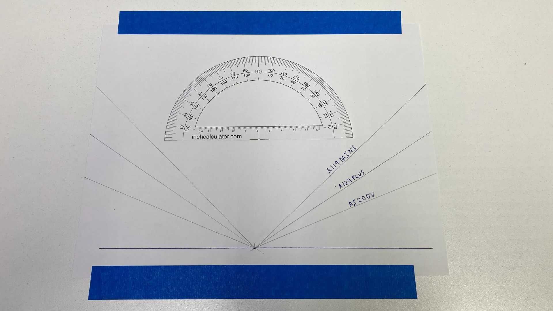

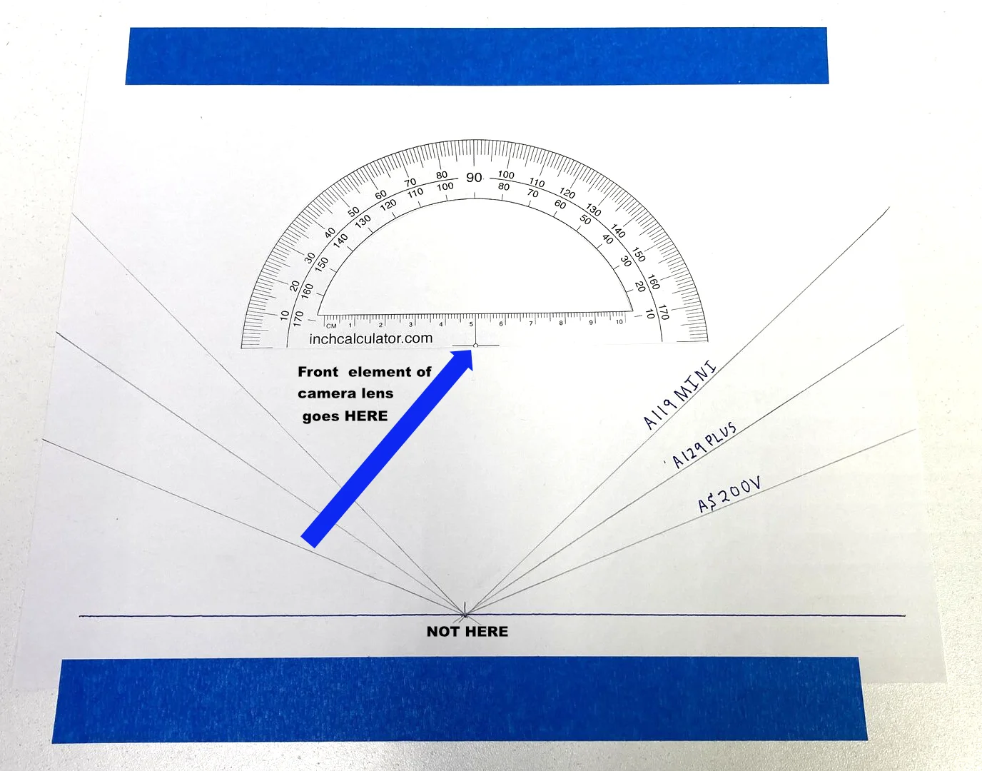

Actually there's another way it can be done using (mostly) your existing setup that wouldn't involve any measuring at all after an initial setup - but - it will require you mount the camera exactly in the center of the test bench (which should be fairly easy) with the lens/sensor exactly parallel to the back panel (not so easy).
I tried this method last night at 3AM, and almost got my thing stuck in the ceiling fan again. Lol

I was probably in the 4th grade when I got my first protractor and learned how to measure angles. It was endless fun.
I'm pleased to see that you took my suggestion to get yourself a protractor but I assumed you would know how to use it, especially after posting the image below to demonstrate that your "guesstimate" that one of your cameras had an AOV of 165 degrees was WAY off as you could easily see where I was measuring from.
The photo you posted reveals that your measurements are off my a country mile. Several country miles actually. Why you would choose to measure from six or more inches away from the protractor I do not know.
You need to measure from the axis point where the angle measurements converge. That is why all protractors feature a hole at that point where you can place a stylus or pin so you can pivot the protractor on its axis to take addition measurements up to 360 degrees.
So Panzer, to use the protractor to measure your camera's Angle of View you need to place the front lens element of your cameras on the line at the axis point as shown in your photo, which I have modified.

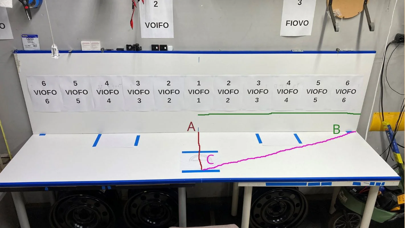

OK, first there are 3 way to determine the angles of a triangle:
1 - Having the length of 3 sides (we already did that one as above).
2 - Knowing 2 of the angles, summing them and subtract the result from 180 (not possible because we can't determine what any 2 of them are).
3 - Knowing 1 angle and the length of 2 sides. This is what we're going to do.
(Please excuse the ragged lines, I don't draw worth a diddly with a mouse. 🙁 )
Looking at your test station if we mount the camera so the lens/sensor is exactly parallel to the back panel then imaginary line A-C will intersect the panel at 90° (Angle 'A').
When the camera is mounted on the platform the length of line A-C can be measured. If mounted consistantly (say with the front edge of the lens even with the edge of the platform) this will only have to be done once.
So now we have 1 angle and the length of 1 side, all we need is another side. This is where the green line comes into play. What that line represents is a ruler (a 48" 'yard stick' would be ideal). This will be attached to the back panel starting from the center to the edge.
Mount the camera with the center of the lens aligned with the end of the ruler (and exactly parallel to the back panel to insure a 90° angle). Do a screen capture and the edge of the frame on the ruler gives us the length of the second side (line A-B).
Enter the 2 side lengths (A-C and A-B ) and the known angle (Angle A, 90°) into the calculator and it will return the length of side B-C and angle 'B' and angle 'C' .
Angle 'C' is one half of the AOV so doubling that will result in the total AOV.
This is a bit of work but if you plan on testing a lot of cameras it will be be easier over time because no measurements will be needed after the initial set up.
