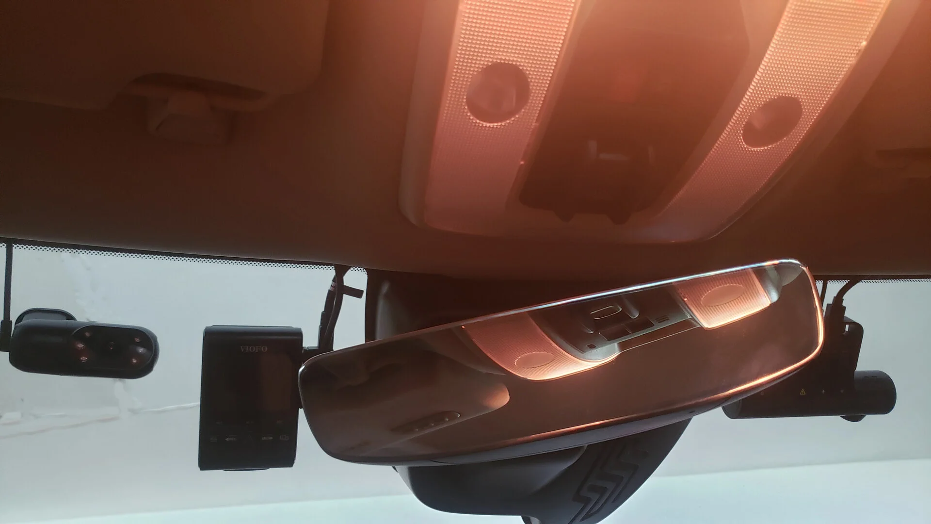

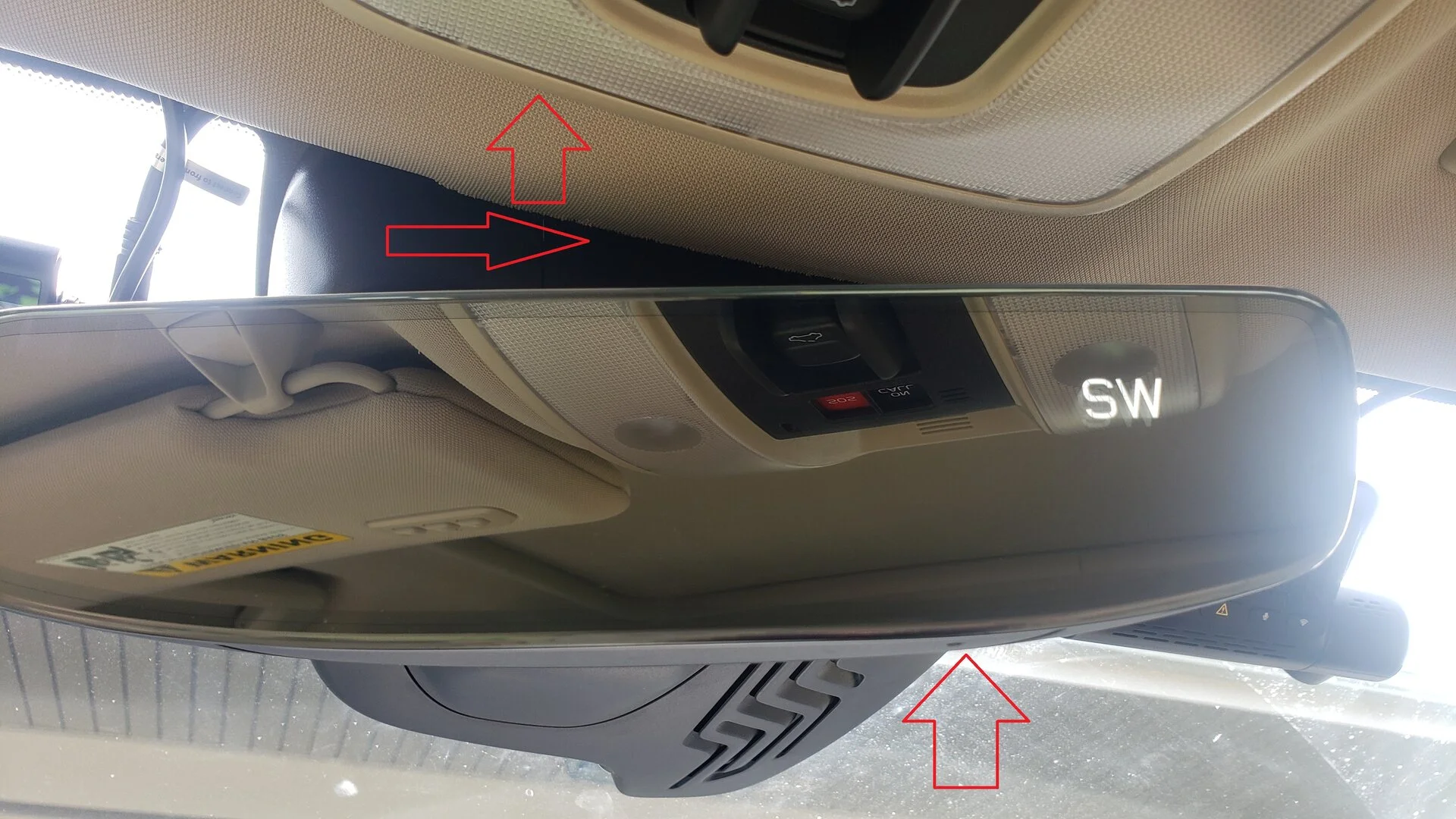

Definitely NOT AN OPTION in all vehicles. Especially newer cars that have Lidar safety systems. Here's my Volvo as an example of why this won't work, and why I have the A139 mounted in its current position. Any interior camera will be obstructed by the Mirror. So on the T130 the integrated interior camera would be useless if mounting it to the plastic housing on my car. It'd see mirror and nothing else.
On the A139, the main forward facing unit could go under plastic housing for mirror , but not the interior unit. For the exact same caveats mentioned on the T130 (obstructing mirror).
Image 2 shows looking dead on at the mirror and provides a better perspective of how the camera would be obstructed.
Images #1 (Interior) and #3 (main unit) are the A139s current placement in my vehicle to address those concerns.
There are countless variations of car geometry that affect front, rear and interior camera placement. No one dashcam can aspire to be suitable for all cars and their users. With the A139 and T130, prospective Viofo 3CH buyers now have two viable options to choose between.
The ability of the T130 to be flipped upside-down increases the likelihood of finding an acceptable location to mount the main camera unit. I just hope those right-angle USB-C connectors do not compromise the setup options. I can see some people asking for straight connectors.

Agreed. Just highlighting that newer cars have limitations on where to mount due to Lidar Systems. Not a complaint, but more of a general comment.
I see the A139 being more versatile since you can mount the front camera and interior camera in two different places. However, I like the form factor of a single front + interior, too. (T130). Form factor wise, it monopolizes less windshield real estate. But that comes at a price of placement and viewing angle.
